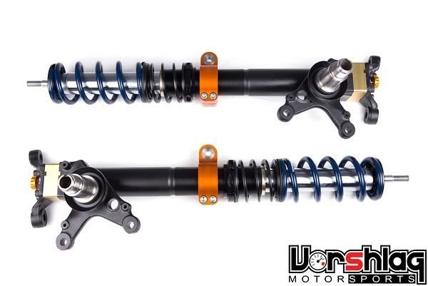

      So "It should take about a week for coating and then a few days for final assembly" in texas really means 28 days. But that should be expected since we just past 7 months on a "2 months tops" job.
      But progress, no matter how long it takes, is a nice thing.

          Do you think they'd be done faster if they took less photos to send you? ;)

                So that is how they get the duel adjustment always wondered how they did that. Must say that look hot as fuck but is a really really long wait.
                  how do you mean?
                  those are singles....

                      Oh my mistake thought they had an adjustment on top and on the bottom.

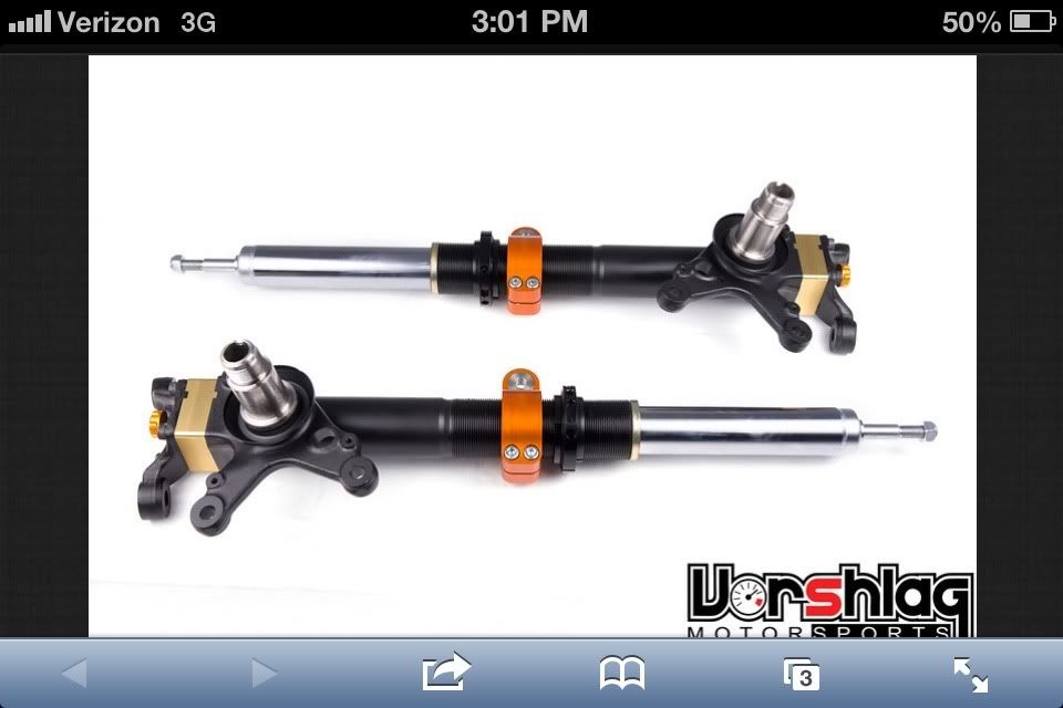

                        The 4100s are drop in inserts that adjust at the top similar to a koni. The 5100s are inverted and use the outside of the strut tube as shock body. The 5200s are double adjustable and I think they require external canisters.
