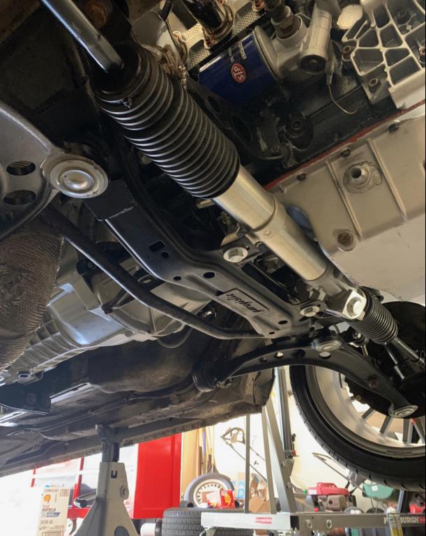

      Z3 rack is in. That was not very fun doing it alone but it’s in. Tightened suspension down and gonna put it on the ground for the first time in months to load the suspension - then I’ll final tighten. Garagistic spacer kit worked out well but a lot of modification to make it all fit.

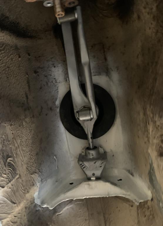

        Anyone know whether the rear gearshift mount goes in the bottom or top hole?
          New front end looking so good! Letting the car rest (for the first time in months) on its own weight and then will final tighten front suspension items. The front seems to be considerably lower than the back now - it’ll be all new after I’m done with front suspension and motor items.

            With everyone’s help, I got the gearshift in and all buttoned up. The Z3 shifter is SO much tighter than the OEM action.

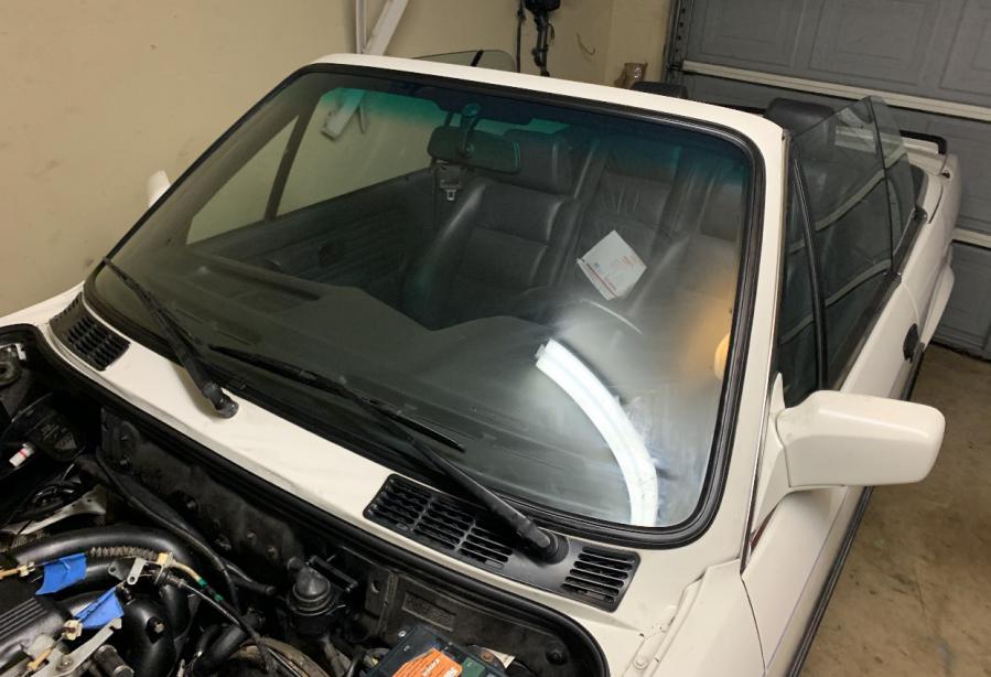

              New windshield and finally got rid of that nasty windshield surround for a new black one.

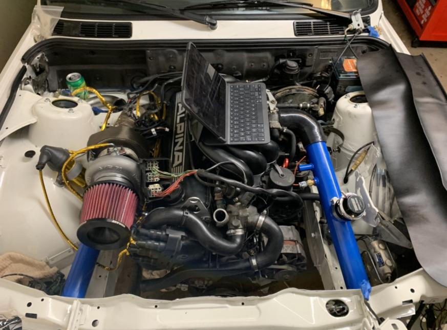

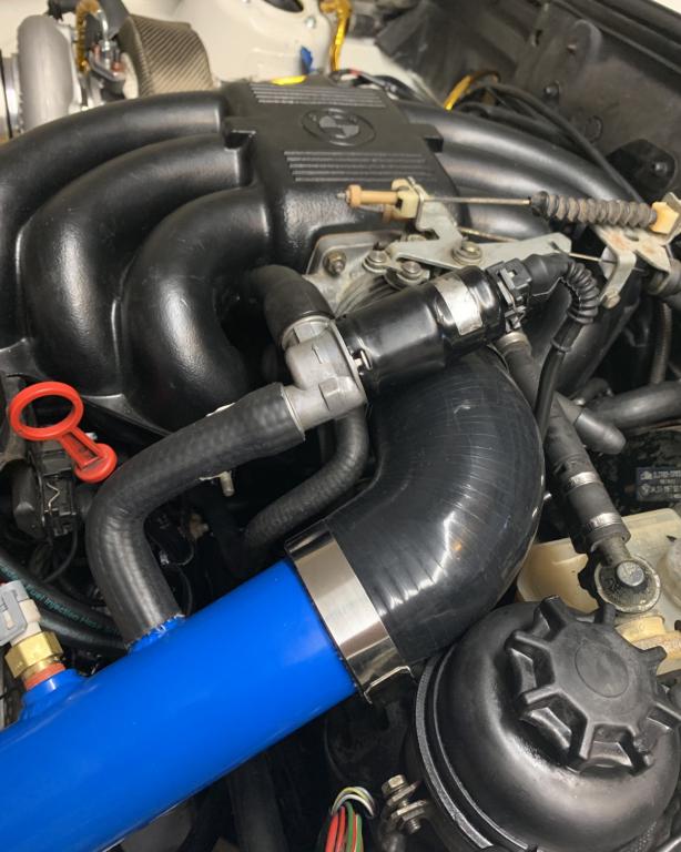

                Intercooler and piping all aligned. Final tightening of turbo clocking. Got the power steering stuff back in and hooked up (a bit of a PITA). Final torqued the front suspension.

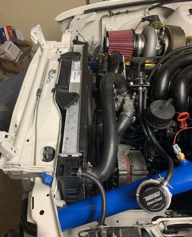

                Z3M radiator is on its way along with a new fan clutch and fan.

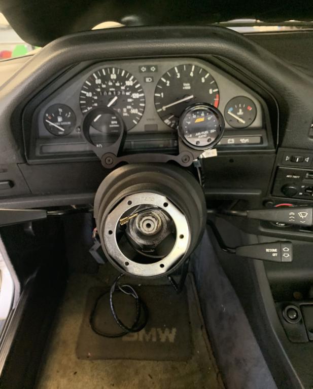

                This weekend Radiator will be installed, run the AFM lines to a gauge on the steering column, run ICV to IC tubing, and run vacuum lines.

ID:	9895934 Was able to find tube for the IC tubing to the ICV. Summit is local, thank God, and I had them just give me everything that was 3/4” and had a 90 in it. Worked out after a little trimming and flipping the ICV upside down.

                              Rally road gauge pod installed. Waiting on a tru boost setup and will wrap wiring and ecu stuff up. Also waiting on Stim Tech vacuum manifold.

                                Z3 radiator in with new fan blade and fan clutch.
