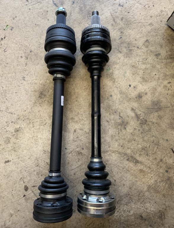

      New and rebuilt axle shaft. Did something dumb with the other original one and had to get a new one. Interesting differences between them.

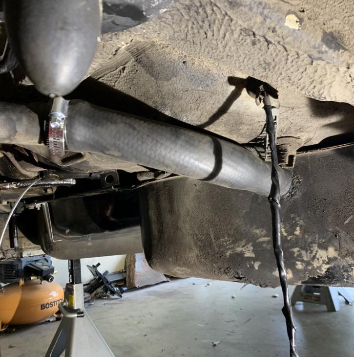

        New gas fill tube

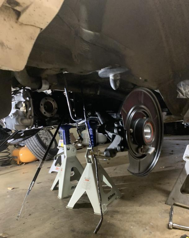

            Rear subframe is back in and ready to have all new parts hooked back up! We’ve had one casualty - a dust plate bolt head snapped off into the new trailing arms. Gonna try to back it out with left handed bit and get a new one in there.

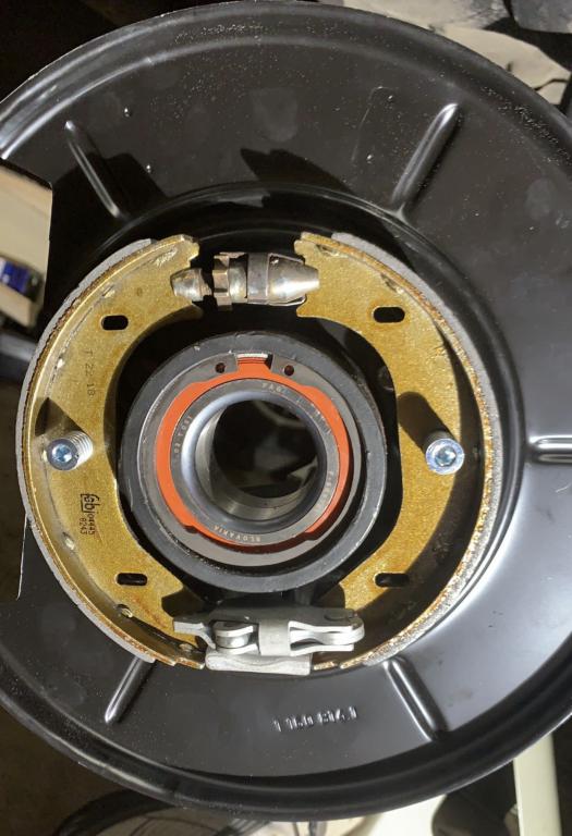

              New parking brake items being installed

                Rear us all wrapped up. Trying to bleed brakes and getting no fluid to the rear. It’s being stopped in the ABs module. Ordered a “new” unit to see if I can keep it. If not I may just delete - although I don’t want to.
