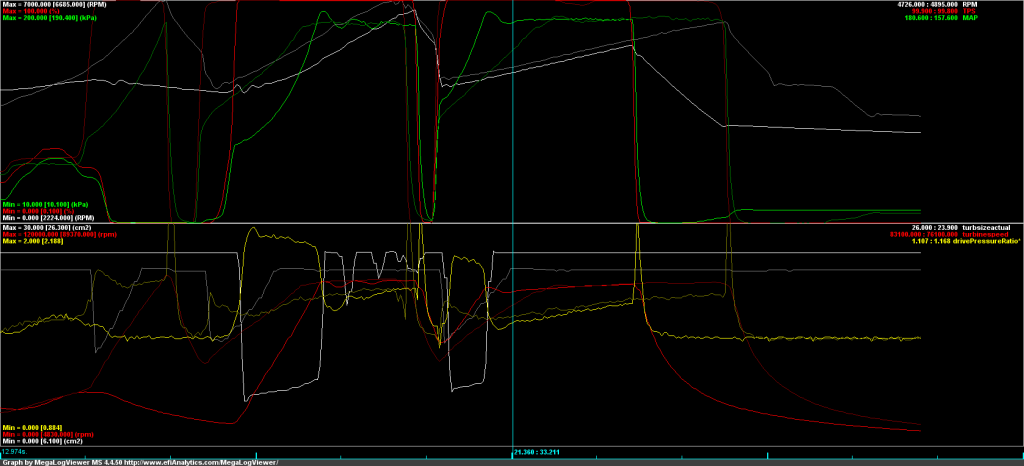

    Did a lot more VGT characterization testing last night. Basically holding a steady RPM and setting a fixed vane position during spoolup, and letting it spool to its limit, and repeating, varying RPM and vane position. Logged 42 distinct combos to work on characterizing the relationship between RPM, vane position, MAP, drive pressure ratio, and rate of building boost.
    During testing I definitely found the surge limit of the turbo a few times, as seen by the jagged MAP signal. This was a pretty aggressive vane position, a little over 90% closed at 3000rpm. In this sample, the surge is mostly caused by the small VGT opening restricting flow through the engine - which is cool, because that means I'm not actually at my boost limit at this engine speed of 3000rpm - I can open the vanes a little more and get the surge to go away.
    You might also notice the wastegate dome pressure signal going a little wonky during the surge event, but it's unrelated. It's doing this because I'm getting close to the boost target so it starts to modulate its pressure to avoid overshoot (not really important at 3000rpm, but makes a big difference at higher RPMs). During spool-up, I keep dome pressure quite high due to the high exhaust manifold pressure resulting from the VGT clamping down. For instance, in the data below, the steady state condition during the surge has EMAP of 278kPa. MAP 158kPa, and dome pressure 250kPa (all in absolute pressure). So there's a 92kPa net pressure on the wastegate piston, in addition to the wastegate spring which by itself gives about 51kPa boost over barometric pressure; opposing that net force is the nearly 200kPa pressure differential across the wastegate valve in the manifold (EMAP minus downpipe pressure, which should be equal to baro), which is trying to push the wastegate open.
    In fact, you can see the wastegate start to open at the cursor (vertical blue line) when the dome pressure drops down to about 200kPa - notice how EMAP (salmon colored line) drops at that point, while the vanes remain constant. This drop in EMAP (and drive pressure ratio) is due the wastegate valve unseating itself and relieving some exhaust manifold pressure. Looks like it actually starts to happen at about 230kPa dome pressure.
    Time to process a pretty big set of data (multiple samples of each of the 42 test points).
