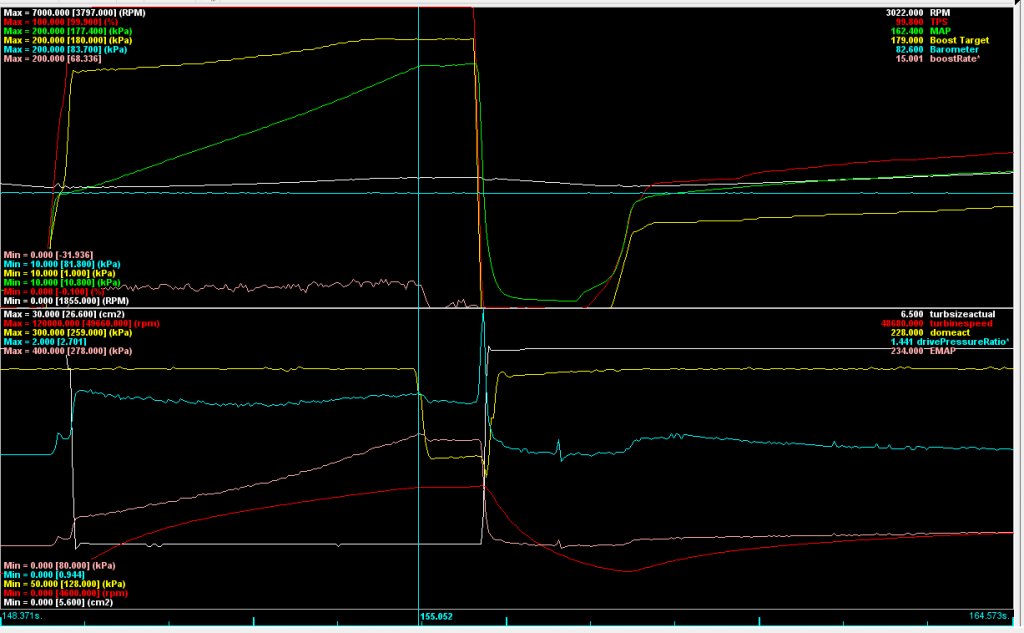

    So I've changed the VGT operation a bit (again...). Now using a RPM- and MAP-based lookup table to determine optimal vane position during spool-up, table was written based on a hundreds of datalogs (the collection process of that data absolutely roasted my brakes... would be nice to have a dyno for this!).
    The data in this screenshot was prior to some refinement of the new lookup table, so the fluctuations around full boost are tamed. Part of why they happened here are what the datalog shows - stomping it in 2nd gear at 2000rpm got me to full boost in 4 seconds (not great, but that's what 2000rpm gets you at altitude), and it absolutely roasted the tires at 4200rpm, shot straight to the 7000rpm redline. Kept my foot in it until just before the wheelslip stopped, but still short shifted a bit. 2.93 gearing means it lit up the tires at 44mph, redline is about 74mph. After the not-flat shift to 3rd, with MAP falling to 17kPa, full boost came back in 0.6s or so.
    Click image for larger version  Name:	image.png Views:	0 Size:	40.2 KB ID:	10072663

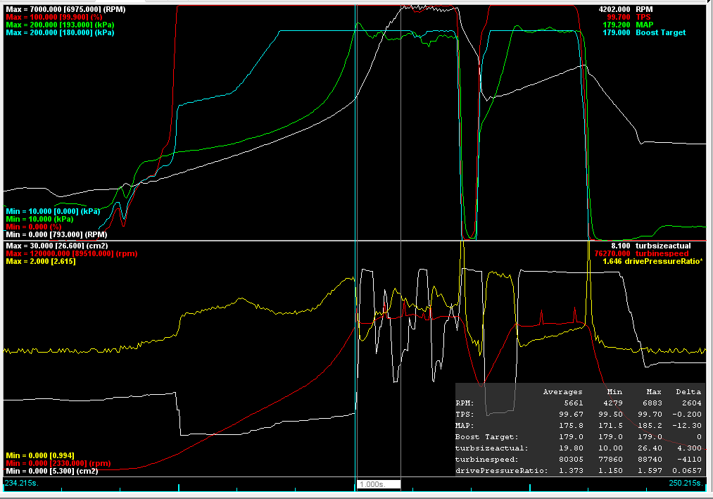

    Another slightly newer 2nd-3rd gear sample, this time with flatshift. Still spinning the tires, they were warmer this test so they didn't spin as bad. WOT at 3800rpm got me full boost in 1.1s. Flatshift took 0.5s and MAP only dropped to 158kPa (vs 180kPa target). This shift sounded like a gunshot, hence the MAP and drive pressure spikes. EMAP (not shown directly) actually rose slightly during the shift, before the big bang (where it spiked).
    Click image for larger version  Name:	image.png Views:	0 Size:	166.7 KB ID:	10072664

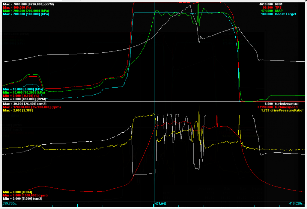

    And to prove that point of "not *actually* the surge limit at 3000rpm" here is 3000rpm again with vanes closed about 85% (was 91% in the previous datalog). Made more boost, limited only because the wastegate dome started dropping pressure, as evidenced by the slight drop in EMAP/drive pressure ratio, and the "knee" in the rate of boost increase. So, I can essentially turn up the boost target, or use less of a buffer at 3000rpm. Right now that "dome pressure control active" threshold is a fixed value, I should probably turn it into an RPM-based value:
    Click image for larger version  Name:	image.png Views:	0 Size:	105.6 KB ID:	10072192
