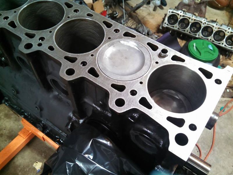

    Engine was out of the car, so we decided to open it up to double check. It was nightmare inside: bearings were shot, bores were deeply scored, and some of the pistons clearly had hit valves. Not worth trying to salvage, and good thing we decided to double-check the PO's work:
    Click image for larger version  Name:	1397445291926.jpg Views:	0 Size:	55.7 KB ID:	9925003
    Click image for larger version  Name:	1397482972868.jpg Views:	0 Size:	107.5 KB ID:	9925004
    Click image for larger version  Name:	1397482772863.jpg Views:	0 Size:	76.0 KB ID:	9925005

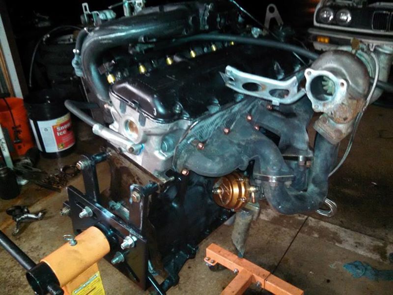

    Note that this was the donor engine - the original short block was still in the car, so we took a look - it looked to be in great shape for its age, just needed some cleanup. After a lot of half-assed work on my part to get the car running over the summer with near-zero budget (would have been easier to start fresh, instead had to undo pretty much everything the PO did), including converting a 35-pin harness to a 55-pin connector to use a 55-pin adapter board, the car ran! The car's original engine cleaned up nice:
    Turns out the oil filter sandwich plate (used for turbo oil feed and oil pressure sensor) that came with the car was not a pass-through design (it required a run of hose from outlet to inlet), took a few heat cycles of giving the engine zero oil to realize the issue. Oops. Decided to just leave it together and run it til it popped. It ended up with a water-air intercooler, TD06-20G hybrid turbo, 3" turbo-back exhaust with a single cherry-bomb style muffler. Probably went 10k miles of beating the snot out of it on a crappy tune at ~11psi and a totally worn turbo, and eventually spun a rod bearing. Here's how it looked for its first iteration. I think it counted as a sleeper:

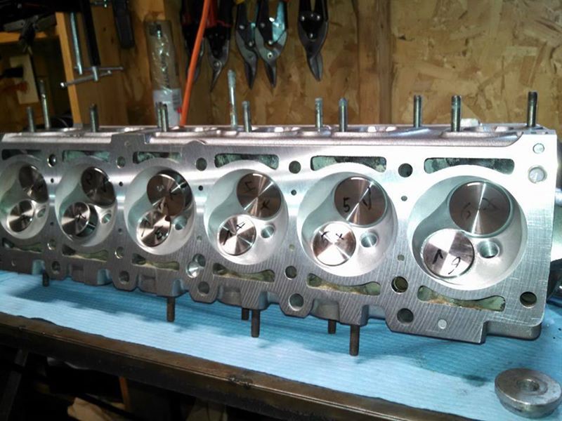

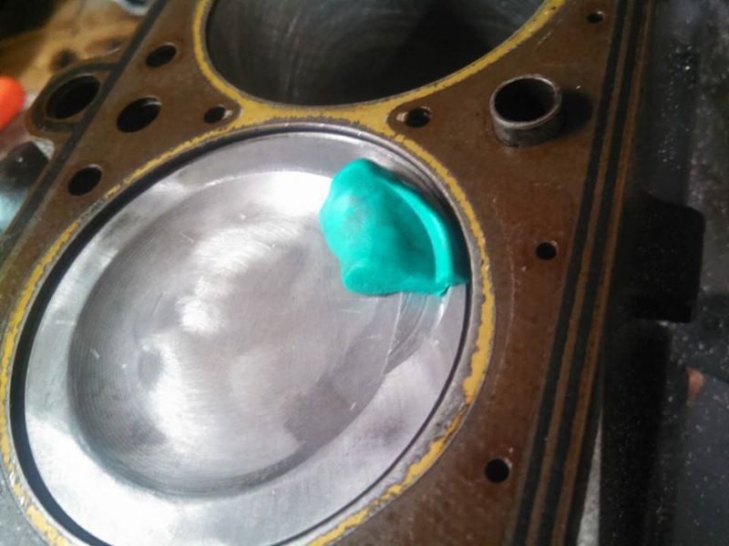

    Clearancing pistons, ended up with 2-2.5mm clearance for the intake valve with the cam fully advanced:

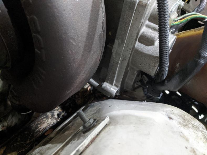

      The major challenge: the size of the housings and actuator. Here it is next to a Mistubishi 20g, the turbo I was running before. Definitely going to take a shoe-horn to get it in the car, and in the fit-up pics you can see some of the half-assed wiring and plumbing I had done bit-by-bit over the prior years:

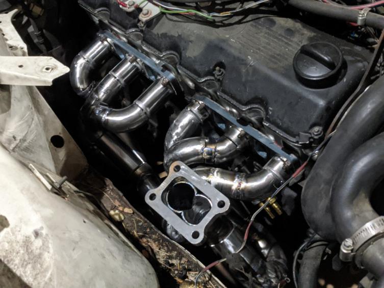

      No one makes an M20 manifold for this turbo, so I knew I'd have to make one. The most critical thing was figuring out how to get the turbo positioned and all the parts clocked in a way that it would actually fit in the engine bay with as much (or any) clearance as possible. I'm running solid aluminum engine mounts, which helps here because the engine won't be moving much. This also means the turbo position *relative to the exhaust ports/flange* is the critical thing.
      So I started by building a simple wooden mock-up of a manifold that would get the turbine flange in the right place relative to the head flanges. It took a few iterations, and I ended up with this position:
      Click image for larger version  Name:	IMG_20191022_202902_309.jpg Views:	282 Size:	95.3 KB ID:	9892258​

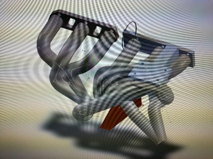

      A major design constraint I'd imposed on myself was to end up with equal length runners. The benefit of equal length could be debated, but it's what I wanted for sound, if anything. Also for the challenge of actually designing and building them 100% myself in my garage with limited tools (the cheapest Harbor Freight bandsaw you can find, an angle grinder, a cheap Chinese TIG machine, and barrels of elbow grease).
      Much, much work was done in CAD, and this was one of the earlier iterations:
      Click image for larger version  Name:	IMG_20191022_191832_01-1012x759.jpg Views:	276 Size:	60.1 KB ID:	9892261​
      It was tough to keep the CAD model stable, and I probably started clean-sheet three or four times between 2016 and 2019 (I'd spend a few nights on it for a few weeks, then abandon it for months). After quite a while, and quadruple-checking clearances, I ended up with the following 6-2-1 final design. All six primaries are equal length to within 0.5mm, and the secondaries the same. After considering options, I decided to add the external wastegate feed to the turbine housing, mostly due to packaging around the engine mount and oil/water lines for the turbo.
      Click image for larger version  Name:	PhotoPictureResizer_191215_171528550-1008x756.jpg Views:	272 Size:	65.9 KB ID:	9892262​
      The benefit of having the manifold fully designed in CAD was that there should, in theory, be no fiddling around with tube fitting. If I could manage to cut the weld elbows to the model specs, it should go together relatively easily with good fit-up. The major aspect of this that I couldn't control directly was the tolerances of the weld elbows... But I was hoping I could at least account and adjust for them. In regard to that, the way I actually measured and marked the cuts would be critical to getting the accuracy needed. I'm happy to share more details of that process if anyone is interested, but there were no fancy tools involved - Excel, pencil, paper, and cheap digital calipers.

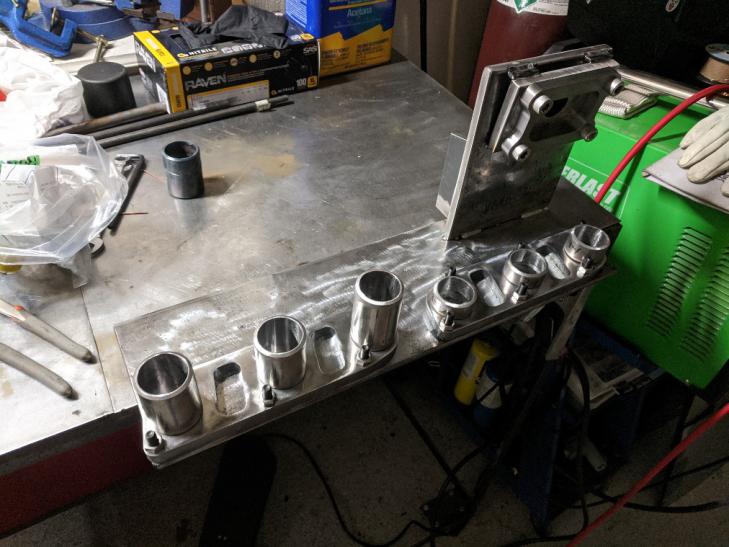

      I decided to make the manifold from mild steel, biggest reasons being my lack of welding experience and skill (didn't want to end up cooking stainless, rendering it useless), ease of cutting, and lower thermal expansion (so maybe less likely to crack). In hindsight, I probably should have gone with stainless because just cleaning the black painted coating from the weld elbows added an enormous amount of work, and I needed to coat the mild steel, more than offsetting the cost savings.
      The good news was that the cuts came out fantastic, and while it was super fiddly getting the manifold tacked up, I didn't have to go back and adjust a single one of the pieces. Fit-up was excellent, with zero gap at most joints (as planned), and generally less than 1/16" gap on the worst joints (sch 40 pipe has >1/8" wall thickness, so no problem there). I also made a substantial jig from 3/8" and 1/2" plate to help mitigate warping. Flange placement relative to exhaust ports was taken from the CAD model, so that no matter what tolerances I had on the individual pieces, the flange placement only depended on the tolerance of my jig (I think I got it to within about 1mm of the target in any given direction).
      The jig will also come in handy if anyone else ever wants to fit this turbo to an e30...
      Click image for larger version  Name:	PhotoPictureResizer_191215_172821577-1008x756.jpg Views:	295 Size:	69.0 KB ID:	9892273​
      Click image for larger version  Name:	IMG_20191123_190216-1012x759.jpg Views:	289 Size:	63.5 KB ID:	9892274​
      Click image for larger version  Name:	IMG_20191124_132505-1012x759.jpg Views:	292 Size:	65.3 KB ID:	9892275​
      Click image for larger version  Name:	PhotoPictureResizer_191215_181954734-1008x756.jpg Views:	292 Size:	70.7 KB ID:	9892276​

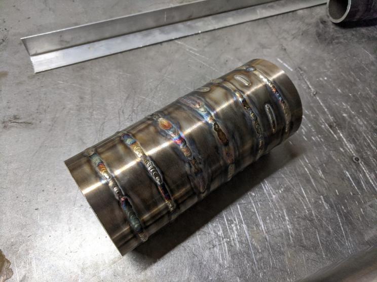

      I ran the welds in a single pass, around 110-120 amps. Not always full penetration, but close to it, and in sch 40 that should be stout enough. I went through a lot of fill rod. Tube ends were beveled to about 35-40deg, with about 1/32" land. Other than a couple spots inside the valleys of the 3-1 collectors, I was pretty happy with how the welds came out for a beginner like myself. Managed to keep the heat in check, so if for some reason I decide to make another manifold at some point, I'm pretty confident I could do a good job with stainless and save myself a ridiculous amount of prep work (since the elbows and pipe won't have coatings, mill scale, and rust to deal with).
      The manifold got ceramic coated to help with heat, but mostly to prevent corrosion. Also, the placement in the engine bay is about as good of a compromise as I could manage in regards to heat. Just barely clears the body while installing, but has plenty of clearance once it's in place. The VGT actuator does not help with the overall packaging, as shown. That said, I didn't have to massage the bodywork at all to get things to fit (although I definitely couldn't fit the stock AC compressor...). Oil filter relocation kit also massively helped.

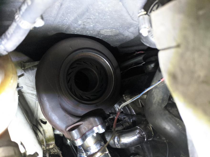

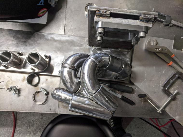

      The turbo, in its Dodge application, included a cast iron or steel elbow that bent about 70deg and expanded from about 3" diameter to 4". While it was a nice part, unfortunately the quick bend would only work for a hood or fender outlet, ha. This will be a daily driven street car, so that won't do. But since I had the elbow on hand, I cut it down to just the turbine-side flange and started the 3" stainless downpipe from there. I have very little stainless experience, so I practiced for a while before getting started. Used solar flux rather than back-purging, which worked pretty well! No sugaring, just some dusty flux reside that'll probably get blown out after the first drive. Here's my practice piece, about 2" at a time. I got better with each bead, especially once I decided to use the pulse feature of my TIG machine. The actual downpipe welds were a little inconsistent, but overall I'm happy with them.
      Click image for larger version  Name:	IMG_20191130_201051-1012x759.jpg Views:	42 Size:	61.7 KB ID:	9892286​
      Click image for larger version  Name:	PhotoPictureResizer_191215_184519366-1008x756.jpg Views:	42 Size:	117.1 KB ID:	9892287​
      Click image for larger version  Name:	PhotoPictureResizer_191215_184900515-1008x756.jpg Views:	42 Size:	63.4 KB ID:	9892289​
      Click image for larger version  Name:	IMG_20191211_213149-1012x759.jpg Views:	41 Size:	64.1 KB ID:	9892288​
      I'm generally not a fan of pie cuts, I think they're overdone for form/style over function (lots of extra work for no benefit in performance) but they do have their place - literally, like when there isn't space for a mandrel bend. Reluctantly, I ended up making almost all of the intake bends with pie cuts for that reason. It was my first time welding aluminum, but ended up being easier than I thought after a little practice getting machine settings dialed in.
      I had to cut off a good chunk of the compressor housing's outlet to make room for a bend to snake around the radiator hoses. The 60mm inducer is fed by a 4" inlet/air filter, so the indent I had to make on the compressor inlet elbow shouldn't hurt flow too much, and might help a little with the crank case venting (I'm running a catch can outlet to the turbo inlet, so maybe I'll end up with a slight pressure drop at that spot to help draw the vapors through).

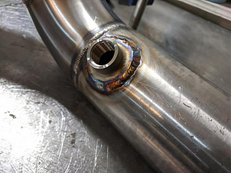

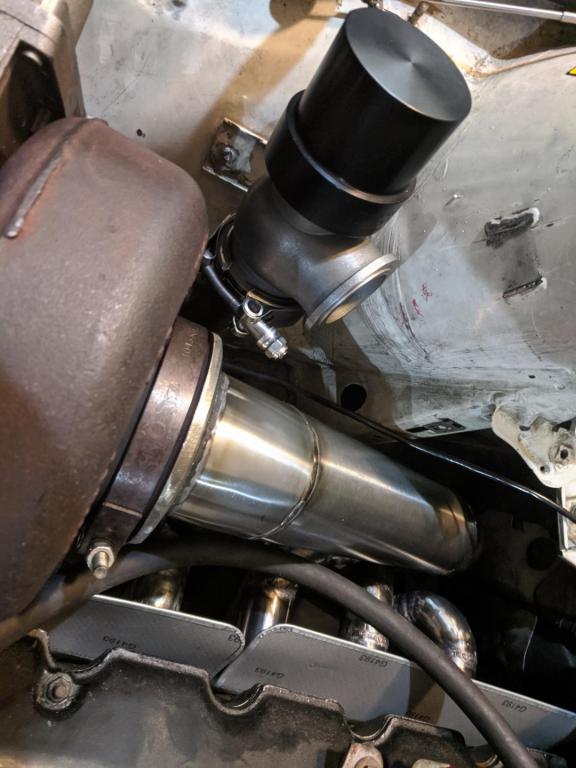

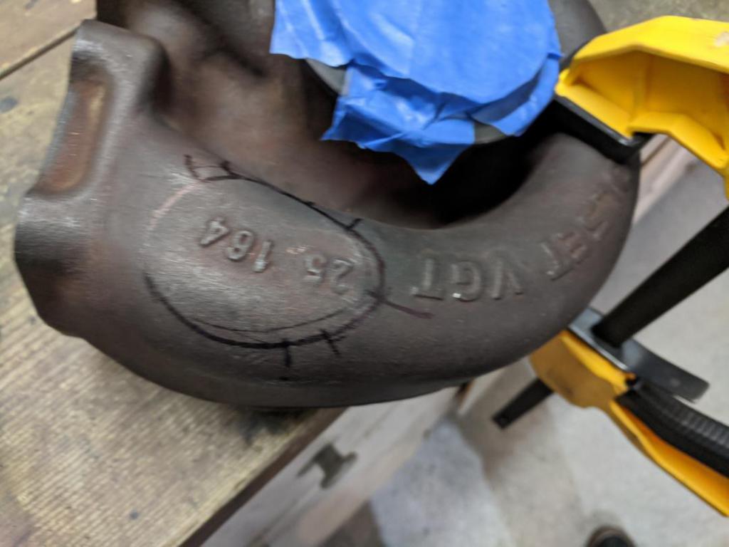

        As you may have noticed, there's no wastegate provision on the manifold - I eventually made the call to cut into the turbine housing. Although risky for someone with my lack of welding experience to try welding cast to stainless, worst case I'd need a new exhaust housing, and they are easy to find used, and cheap; so I went for it.

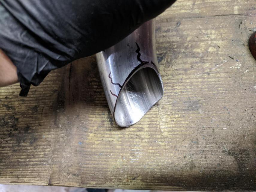

        Marked up for cutting, which was decidedly NOT a fun process, took about an hour of running a die grinder non-stop after I made the initial cut with a hole saw:
        Click image for larger version  Name:	IMG_20191207_110349.jpg Views:	92 Size:	65.1 KB ID:	9923188
        Tube notched:
        Click image for larger version  Name:	IMG_20191207_110538.jpg Views:	88 Size:	81.9 KB ID:	9923189

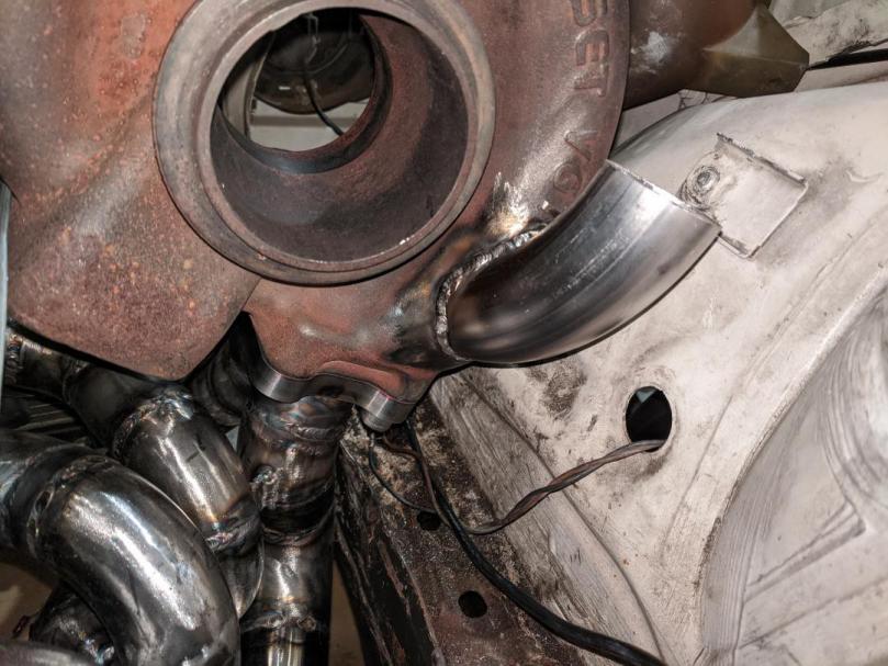

        After preheating the housing for a few hours, and using 309L filler, I CAREFULLY gave it a shot. Once I had a couple tacks on it, I tried making a light adjustment with some soft hammer taps, and broke a tack - or so I thought. The tack actually held just fine, but it pulled out a small chunk of cast iron with it! Thankfully nothing too big, but it was an eye-opener for how brittle the material was. After that though, the welding went smoothly, and I very slowly brought the temperature down over the course of several hours after I got it fully welded. I'm pretty happy with the placement - the wastegate will get fed a whole lot better than a lot of off-the-shelf manifolds, and it's fully upstream of the beginning of the opening in the housing that feeds the wheel. Also, it's in a pretty easy-to-access place, and uses v-bands, so working on it will be nice. Having done it a few times now, changing wastegate springs takes like 3 minutes and doesn't require lifting the car.
        Click image for larger version  Name:	IMG_20191207_215354.jpg Views:	90 Size:	80.7 KB ID:	9923190
        Click image for larger version  Name:	IMG_20191208_183146.jpg Views:	91 Size:	58.3 KB ID:	9923191

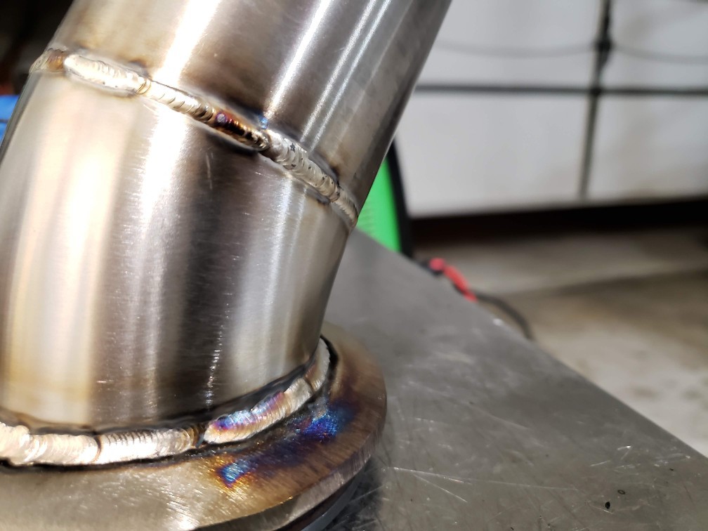

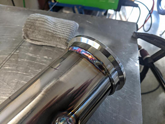

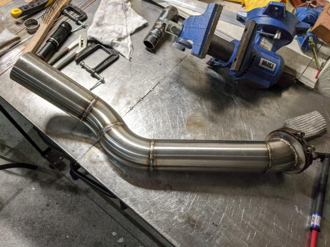

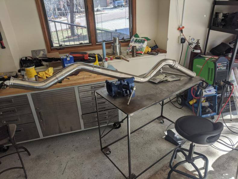

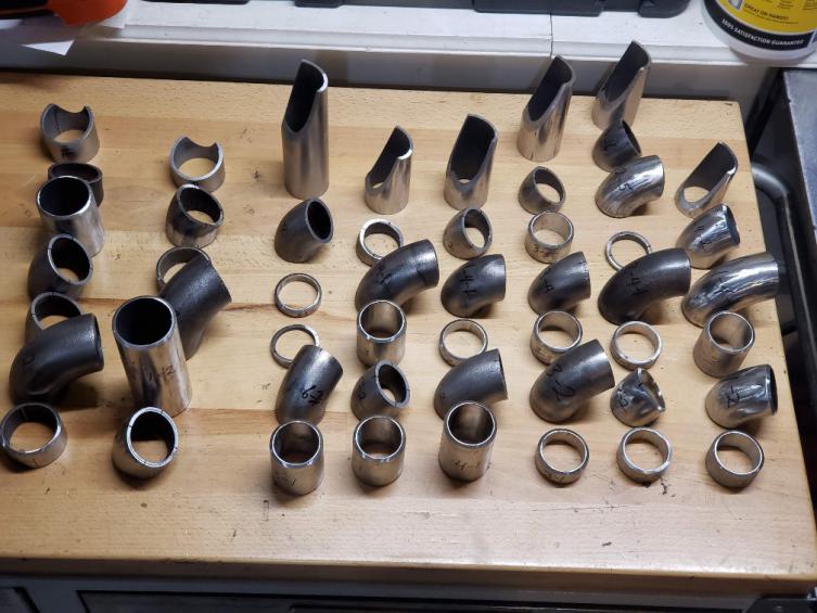

          The rest of the exhaust (all 3" 304 stainless) was a breeze, went together very quickly. First I finished up the downpipe:
          Click image for larger version  Name:	IMG_20191219_183828.jpg Views:	67 Size:	61.1 KB ID:	9923201
          Then moved on to the rest of the exhaust:

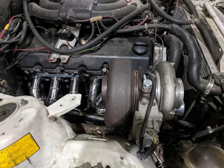

            And then got the exhaust finished up and the engine bay all buttoned up, including turbo oil train, oil feed, water lines, remote oil filter install and associated hoses, new wiring harness (more on that later), late-model coolant reservoir, relocated washer reservoir, and on and on. Muffler was $15 brand new on Amazon, it's stainless, but I accidentally ordered a black powder coated unit, oh well. It's a single-chamber, no-fiberglass, mostly straight-through guy. Just an couple simple baffles in there. The objective for sound, with the equal-length manifold especially, was to go for high-pitched screamer. So definitely no fiberglass anywhere. I might end up adding a helmoltz resonator or two before the muffler, but this is the state of things at the moment.

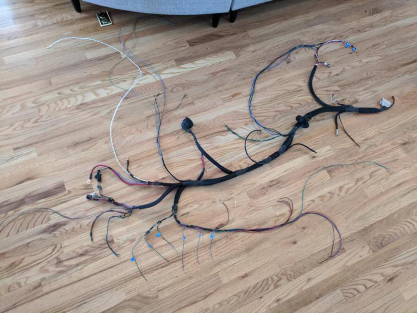

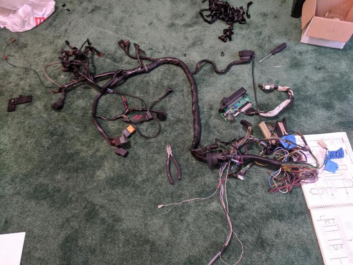

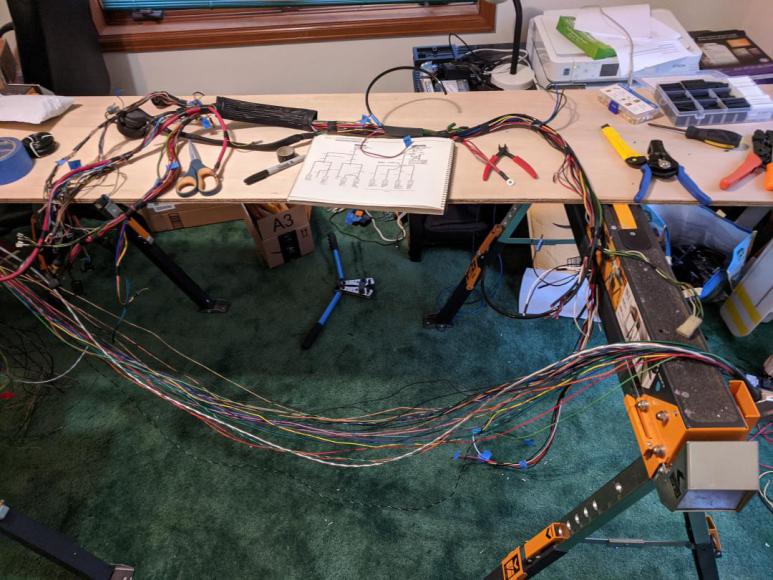

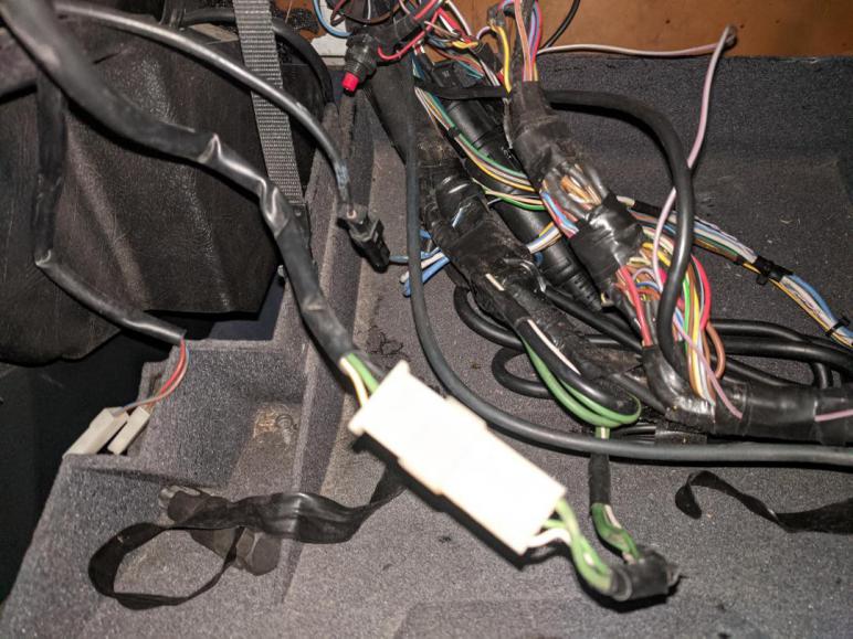

                The state of the wiring up to this latest rebuild left something to be desired. Yes, it worked, quite reliably somehow. But, it was a real headache to work with, what with the converter Motronic 1.0 to 1.3 harness, adapter board, and various circuits added over the years. I decided to basically start the engine harness from scratch (well, starting with a DIYAutoTune flying lead harness, technically...). Here's how it used to look in the glovebox, and how the harness + adapter board looked once it got pulled from the car. Yikes, what was college-aged me thinking??
                Click image for larger version  Name:	IMG_20200118_173739.jpg Views:	26 Size:	82.5 KB ID:	9925021
                Click image for larger version  Name:	IMG_20200120_075418.jpg Views:	26 Size:	78.9 KB ID:	9925022
                I ended up buying a hard copy of the ETM, and used Solidworks Electrical to design the new harness to be as clean and easy to install/remove from the car as possible. It's pretty cool software - I didn't end up using all of its features, but it essentially is a database that links the components "smartly" - somewhere it keeps track of all connections, splices, components, etc. I mostly used it for my own sanity; even though the schematic looks pretty complicated, the color-coded wires help immensely (which btw have all of the details stored, e.g. 0.75mm^2 Green with White Stripe). I'm no electrical engineer, but this got the job done, especially since you mostly build one of these wire-by-wire anyway.
                First, the line diagram, which is more of a high-level overview of what's included and how it's laid out. I didn't complete it fully, but it's not really the driving force behind the design:
                Click image for larger version  Name:	line_diagram.PNG Views:	26 Size:	354.9 KB ID:	9925024
                The real design details are in the schematic, including pin numbers/names, wire details, etc:
                Click image for larger version  Name:	schematic.PNG Views:	26 Size:	264.7 KB ID:	9925023
                  [Previous posts were updated with some photos and additional info to get them up-to-date, and because I found some old photos I thought I'd lost.]

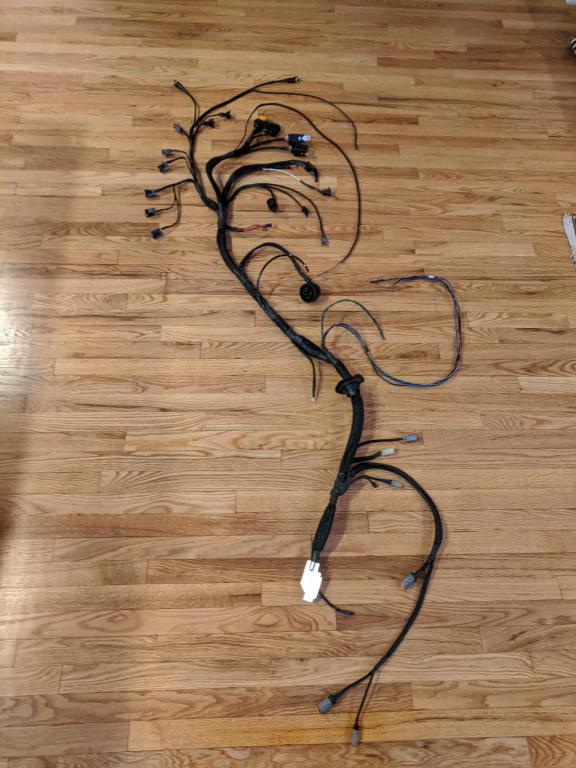

                  The overall goal with the wiring was to, as cleanly as possible, merge only the needed aspects of the stock engine harness with the Megasquirt flying lead harness, and adding in all additional features as needed. And, there were quite a few additional features... more on that soon.
                  I reused some of the stock connectors where it made sense, like C101 for integration to the body harness, C104 for the connections to the dash, sensor connectors if they weren't pigtails (e.g. coolant temp sensor). I removed any non-used sensors, connectors, wires, etc. - for example, the coolant temperature switches for the fan control, which would be handled by Megasquirt. Only what was needed to make all of my desired features work, and nothing more.
                  The process started by doing some reverse engineering/deconstruction of the stock engine harness to understand what was there, how it compared to the ETM, and if it was really needed or not. I gradually removed wires one by one if they weren't needed to get the stock harness down to the bare minimum. I'd estimate I kept roughly 30% of the stock wiring. It was a sticky process, wore my fingerprints away:

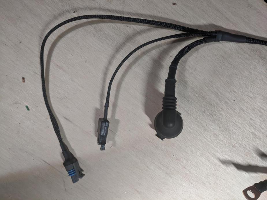

                  Throughout that reverse engineering process, I was working on the new harness design (final iteration shown in previous post). Once I was confident everything was included in the design, and I was happy with all the wire sizes, rough routing, etc., I started the splicing process. Not super fun, and took far too long - but worth it in the end, I think. I also tooled up a bit - everything crimped this time around. Open-barrel splice connectors for any and all splices, Deutsch DT and DTM connectors, new crimping tools (none name brand, but they worked really well for the most part). Dual-wall adhesive heat shrink everywhere, and braided nylon sleeving to wrap it all up. It was amazing how much brain drain happened from just trying to assemble things in the right order... definitely a different way of thinking about things than I'm used to.
                  Click image for larger version  Name:	IMG_20200215_112558.jpg Views:	84 Size:	84.6 KB ID:	9925034
                  Some of the sleeving had to go on before all the wires were run, due to existing connectors - generally, it got built from the middle of the harness out. Partially complete:
                  Click image for larger version  Name:	IMG_20200217_140048.jpg Views:	84 Size:	81.2 KB ID:	9925035
                  With the DT/DTM connectors and the sleeving, I'm happy with how all the terminations ended up. For example, the branch with a swapped throttle position sensor connector (from an e34, I think?), stock idle control valve connector, and GM-style intake air temperature connector:

                      Onwards to the details of my build in this regard; here's the basic structure of how the CAN communication flows between Megasquirt, my microcontroller, and the turbo:
                      Megasquirt <--> Microcontroller --> turbo
                      Megasquirt broadcasts data, which is read by the microcontroller. Microcontroller processes the data to determine the VGT position, and sends the command to the turbo. In short - if Megasquirt says we need more boost, the microcontroller determines how badly we need more boost, and closes the vanes accordingly. Once we don't need anymore boost, the vanes open fully to allow the engine to breath as much as possible.
                      In addition, Megasquirt requests sensor data from the microcontroller, and microcontroller responds accordingly the request, allowing the Megasquirt to log additional data channels.
                      One of the things that bothered me with previous iterations of the car was the messiness required to display info while I drive - it's tough to really cleanly install gauges, and if you ever want to add additional gauges, it's tough to not make a mess of the splices required. Since I built up the ability to get dozens of channels of data with just a couple wires using CAN, I figured I'd build a solution that takes advantage of it: a multi-function display that can display any info I'm interested it. Expandability is the key feature here: add some code, and you have another gauge. No worrying about how to mount it, where to splice, how to make the wiring clean.
                      So, as I considered all of these features, I ended up with the following setup:
                      • Standard MS sensors (IAT, TPS, CLT, Crank position, Wideband) wired as usual for MS setups, to the DB37
                      • Standard MS outputs similarly (fuel pump relay, wasted spark outputs, injector outputs, PWM idle control)
                      • High-voltage flyback tach circuit added to the regular MS tach output, since the stock tach was triggered by the coil from the factory
                      • CAN wired as normal for MS
                      • Fan control using a relay trigger circuit (using the stock high-speed fan relay/wiring)
                      • Intercooler pump control using a relay trigger circuit (using the stock low-speed fan relay/wiring)
                      • Fuel pressure sent to the microcontroller (Teensy 4.0) using an analog input
                      • Oil pressure sent the same way
                      • Circuit built using a VR encoder IC (MAX9924) to read turbo speed, since HE351VE includes a speed sensor
                      • Fuel and oil pressure, turbo speed, and turbo vane position (technically, nozzle area in cm^2) sent to Megasquirt for datalogging
                      • Stock econometer functionality: microcontroller reads injector pulse width from CAN, converts to duty cycle based on engine speed, scales to account for the bigger injectors I'm running, sends it as a PWM output with PWM frequency matched to engine speed, and scaled to a 12V signal with a transistor circuit
                      • Turbo VGT actuator power controlled by an output on the microcontroller, with corresponding booster circuit on the microcontroller output to power the relay
                      • Stock OBC (multi-function clock in my case) replaced with a 2.8" touchscreen display with a custom housing and bezel to hold all of the microcontroller circuitry
