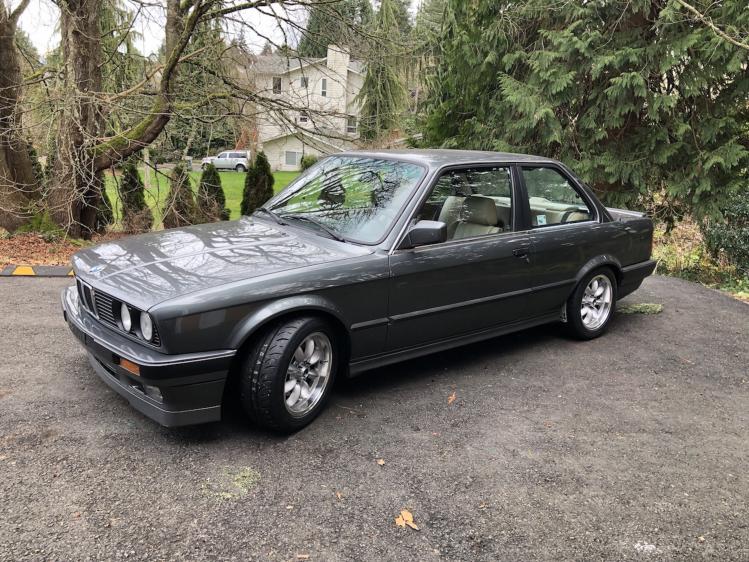

    Spent this winter going through my new-to-me E30, fixing oil leaks, vacuum leaks (there were many) and doing general tune up stuff. The big projects, though, were replacing the 3.25 rear that came in the car with a 4.10 LSD and installing a faster steering rack from an E36.
    Overall, the 4.10 upgrade was a vast improvement. With the 3.25, the car was unhappy in around town in 35-45 mph driving, either winding out in third gear or lugging in fourth. With the 4.10s. I can drop the car into fourth at those speeds, and it's much happier, with instant acceleration from there when required. The M20's nice smooth torque curve seems to work perfectly with the steeper gears. The downside, of course, is higher engine speed on the highway. At 65 mph in fifth, the engine spins at 3K, which is not too much different from my other "fun" car, my 85 911, which turns 3K at 70 mph. Neither would be ideal for cross-country drives on interstates, but that's not why I have them. They are perfect for back road blasts.
    The quicker steering rack from the E36 was also a great upgrade, giving the steering a much more modern feel. Installation was pretty easy too, and I added a Chase Bays power steering kit (lines plus reservoir), which was a nice piece of kit.
    The final upgrade was bling--I added a set of Rota fb wheels, which gave the car the vintage sports car look I like. Also added new Dunlop Direzza IIIs, which I have yet to put to the test, since Seattle road's have been wet for seemingly months at this point.
    The car should be ready for spring soon! I know I am.

  • roguetoaster
    Biggus Tippus
    • 7830
    Only 4.1s eh? Didn't want to grab some 4.44s?

        • digger
          • Nov 2005
          • 6198
          i just down graded from 3.91 to 3.73. A 4.11 is too short, be different with a 6 speed and proper spaced ratios

            • lukeADE335i
              • Apr 2013
              • 1389
              You car is looking great. A shorter diff ratio is the best bang for buck mod you can do to most e30s to make them faster. I have a 3.25 LSD at the moment with my M30, but have run a 3.73 in the past and will either go back at some point, or swap the gearbox to a 6 speed.

                • finnmole
                  • Sep 2018
                  • 76
                  Nice color!
                  How do you like the E36 rack?
                  I bought a 100km E36 rack from the wrecker...looked fine but I find it has a dead spot in the middle...maybe 1/8" movement.
                  My school bus E30 rack has no play at all (205km)
                  I can see wear on the teeth of the rack right in the middle position (the rack is off the car now)
                  Found an other E36 rack, again it looked great but has the same play at the center...so I didn't buy it.
                  The feel of the rack was just fine for me but for the play.

                  • WAKman
                    • Aug 2020
                    • 57
                    Originally posted by finnmole
                    Nice color!
                    I'm going to try for an E46 purple tag next.
                    I love the E36 rack--makes the car feel much more responsive. I went with a remanufactured one to avoid the kinds of problems you mentioned.
