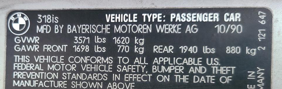

            Just look at your door jamb VIN sticker. On my car, it clearly is marked "318is".

              Don't those door stickers also say 325i/is, or am I thinking of something else?

                Thanks for all the replies. I will check the door jamb. Some body panels have been repainted, so hopefully not the driver door. Wondering if it's different for a 318is vs. 325is.

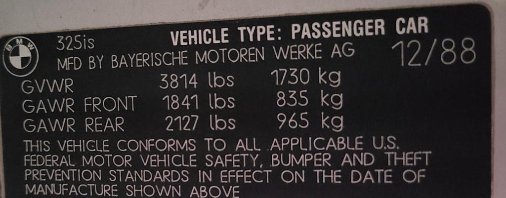

                          My 325is VIN sticker
