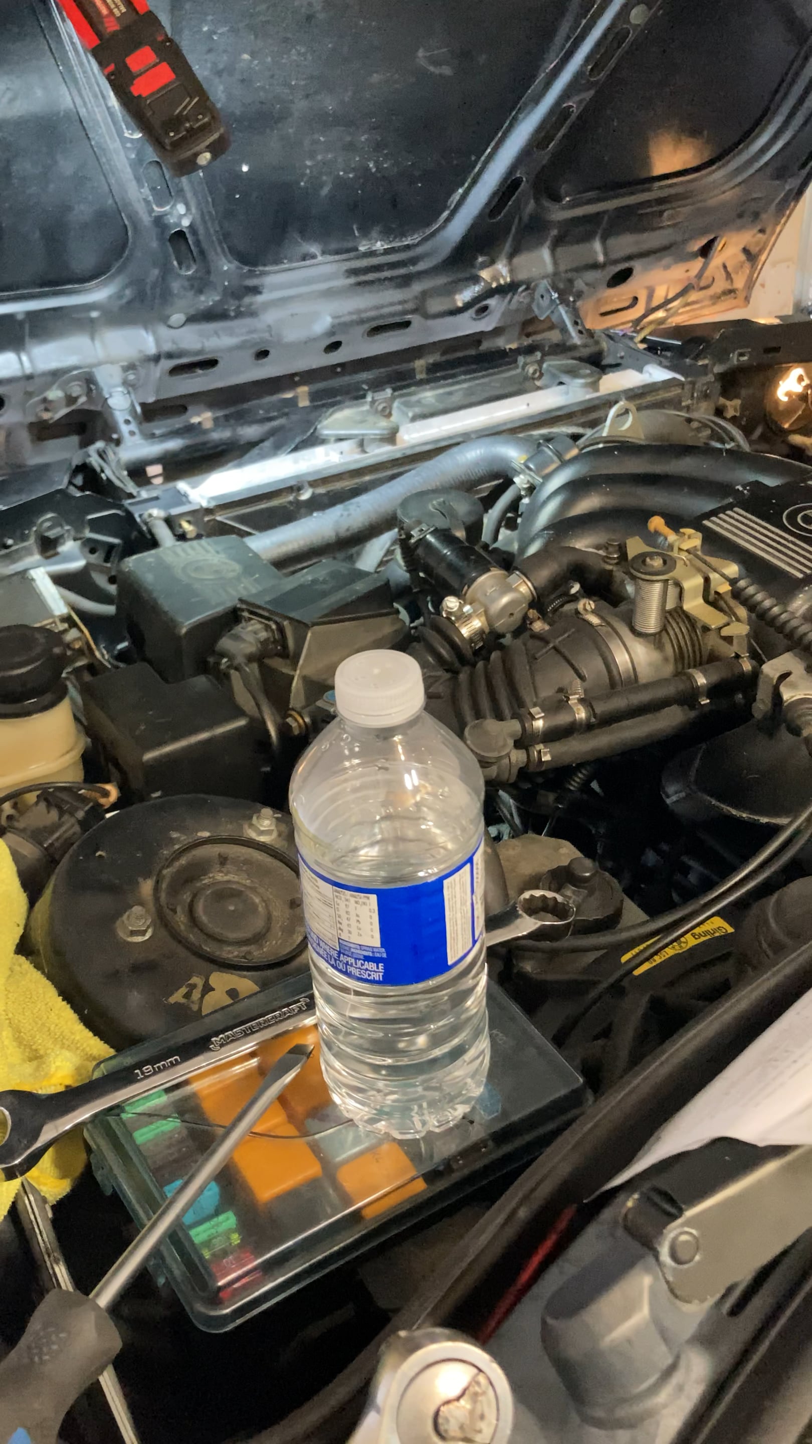

          December 2022 - Ups/Downs of Timing
          The PO told me that they changed the belt early 2019 and I said I'd change it before 2023 because I'm gonna assume that they did it on Jan 1, 2019. So ​​​​​​the day finally came upon me to do my timing belt, water pump and a bunch of other small seals. First and foremost the first thing I noticed was the distributer cap and the rotor were original parts! That was insane, and the worst part about it all was that I didn't replace them because I didn't have enough time to order the parts. A whole ignition refresh is long overdue on this car, all new parts will be installed very soon.
          As I was disconnecting the radiator a very unfortunate but predictable thing happened, overflow nipple broke off and was stuck in the hose, so that only meant one thing. New radiator!
          Also I realized how much my power steering was leaking, first picture is about 2 hours of parking and second picture is about 10 hours later.
          And of course it still has the original fan clutch! Also long overdue to change as well.
          Installing the new cam seal wasn't too bad but man the old one came out in literal pieces, I torched it at one point because of how stuck it was. Also cleaned the hell out of all the years of grim, very tedious but extremely satisfying. I also had no faith in that dinky little paper gasket so I put a very thin layer of gasket maker on the block.
          I cleaned it all up, tensioned the belt and we were all good to go. Or were we? This happened everytime I'd start the car.
          This is "trauma" by Omar Abbasi on Vimeo, the home for high quality videos and the people who love them.
          I thought it was the timing belt, I immediately redid the entire job, re-tensioned everything and still the same thing. I only put on one accessory belt, the alternator/water pump since my A/C doesn't work and my P/S is leaking anyways. After hours and hours of troubleshooting, trying the old accessory belt, re-tensioning the v-belt, frantic googling and reading the manual.
          I figured it out. It was the goddamn alternator hinge bolt, I didn't tighten it all the way so the alternator would move ever so slight and cause the belt to squeal every time the car started or I put throttle.
          Overall, quite the learning experience but I'd do it all again because I hate myself. Just kiddin, I'll probably never stop wrenching.
            Nice to change seals while you're in there, was the old seal leaking?
            Agreed with the gasket maker, I have used it along with the paper gasket on jobs like this in the past. I'm sure the paper gaskets were sufficient when everything was new, but 30+ years take their toll on mating surfaces.
            Glad it was just the hinge bolt. Impressed that you redid the entire job looking for the issue, sometimes that is the way to learn.
              Yeah the seal did not look good at all, the original cork gaskets on the water-pump were solid back in the day but the replacement ones aren't too good anymore.
              I'm so glad it was the hinge bolt, also the biggest take away was that I did the timing properly both times haha. Just have to find a good place to get new ignition parts and not spend too much on shipping.
