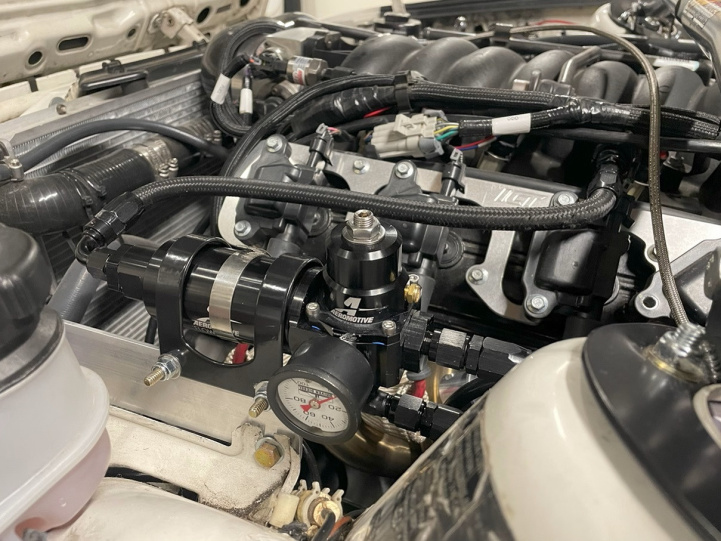

    2. I was having issues with fuel pressure so decided to order and install an Aeromotive fuel filter/regulator combo. Mounted on the existing air filter bracket which worked out pretty well. Now fuel pressure is steady at 60 psi.

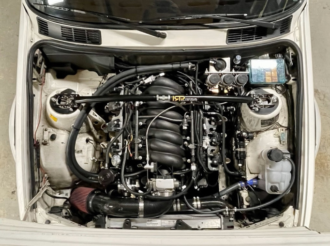

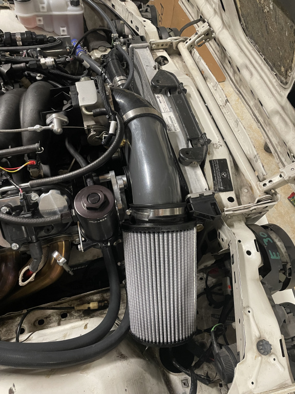

    Pictures of the new fuel pressure regulator, the engine as currently sits, and "trying" to fit the 4" intake tube (hitting the idler pulley).
Name:	LS Overview.jpg
Name:	4in Intake Fit.jpg

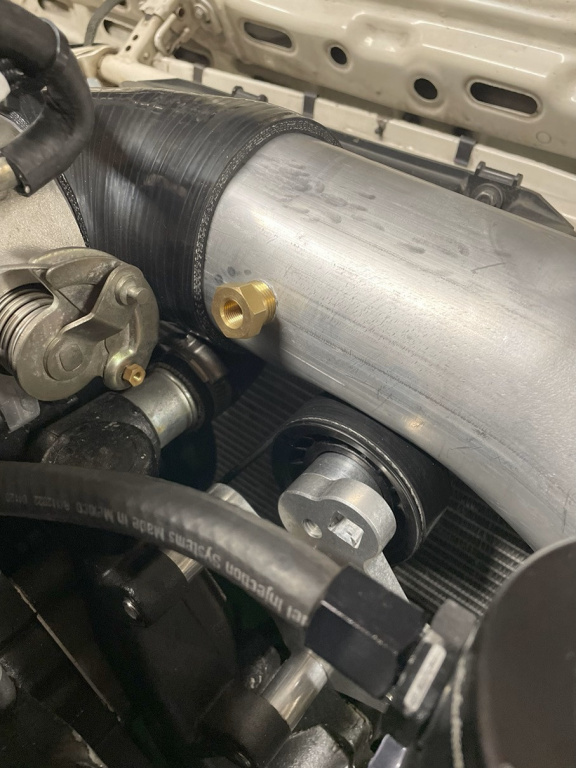

        Yes progress!! Getting closer everyday. The 4” intake is now installed.
        Click image for larger version  Name:	IMG_3054.jpg Views:	0 Size:	238.1 KB ID:	10111169
        The guy who did the alignment couldn’t access the tabs for rear toe or else he would have adjusted it. I have a friend who said he can do it without dropping the rear subframe. Ideally I would like zero toe or 1/8” toe in. You are correct.

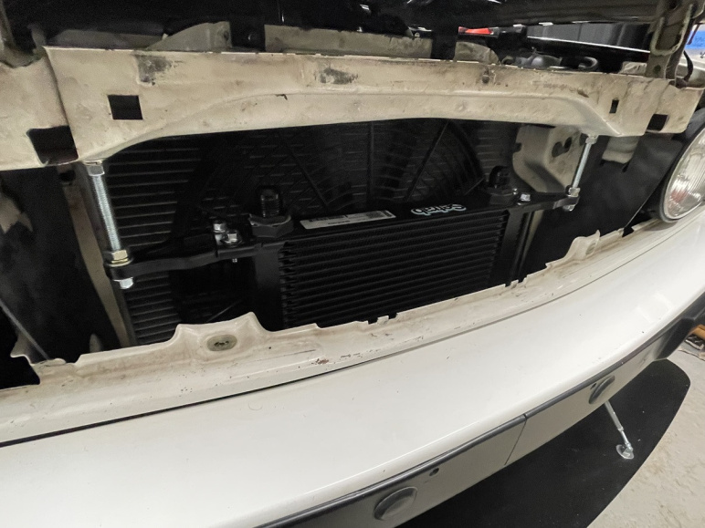

            Update for the e30. I just installed the Setrab 19-row cooler with Garagistic mounts. I used 100mm studs to offset the oil cooler down in order to orient the cooler properly with fittings at the top. Crimped -10AN hoses are currently in production and should be finished early next week. I'm still trying to figure out how to route the -10AN hose to the Accusump in the trunk. I may need to route the lines to the Accusump through the interior of the car.
Name:	Setrab Oil Cooler.jpg
