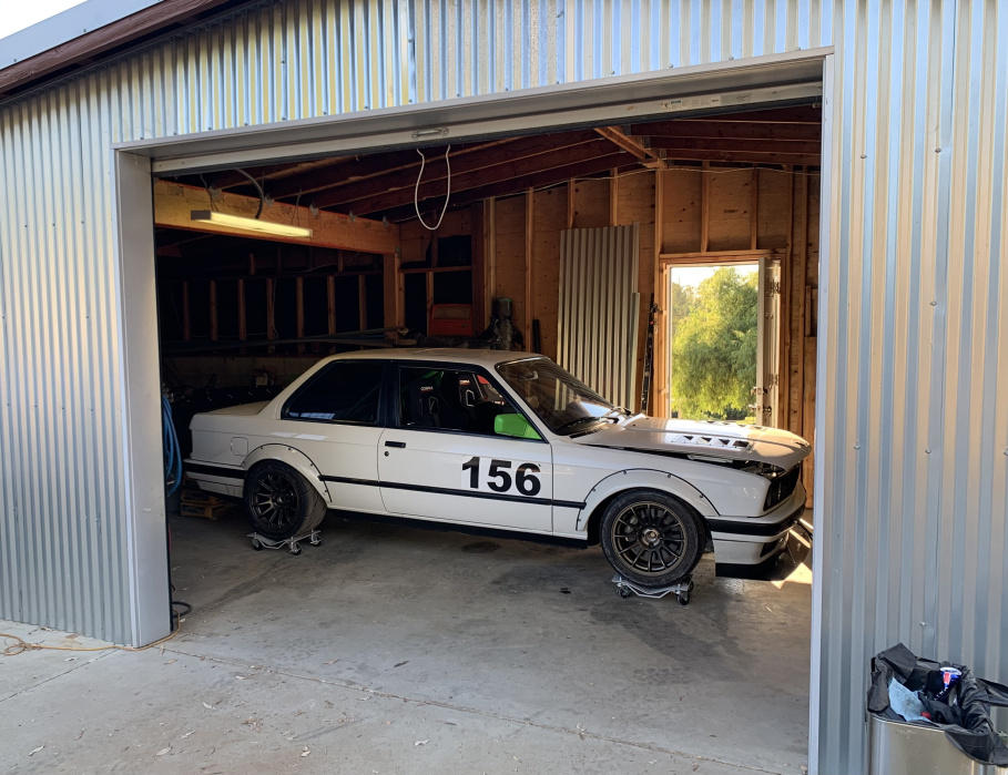

      E30 is officially in hibernation mode. Compression checked the engine last weekend and all cylinders were between 170-180 psi (forgot to open the throttle body during testing). Planning to leakdown test the engine soon as well (hopefully this weekend). Best case scenario is that the PCV system needs to be reworked/vented and the engine doesn’t need to come out.
      Goal is to get the interior out, pull the bolt-in half cage, weld in a full SCCA cage, and rework wiring.

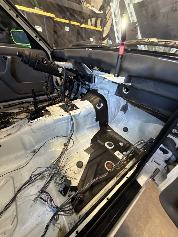

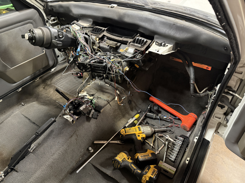

                  Some updates…switching the car to Haltech Rebel LS and going full cage. Pulled out the carpet, interior, dash, and HVAC. Need to dry ice the interior tar, rewire back to the fuse box, and flock the dash.

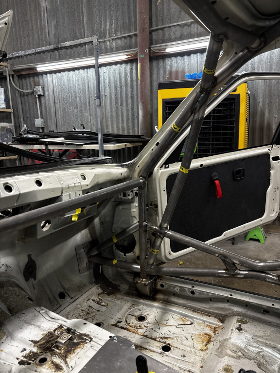

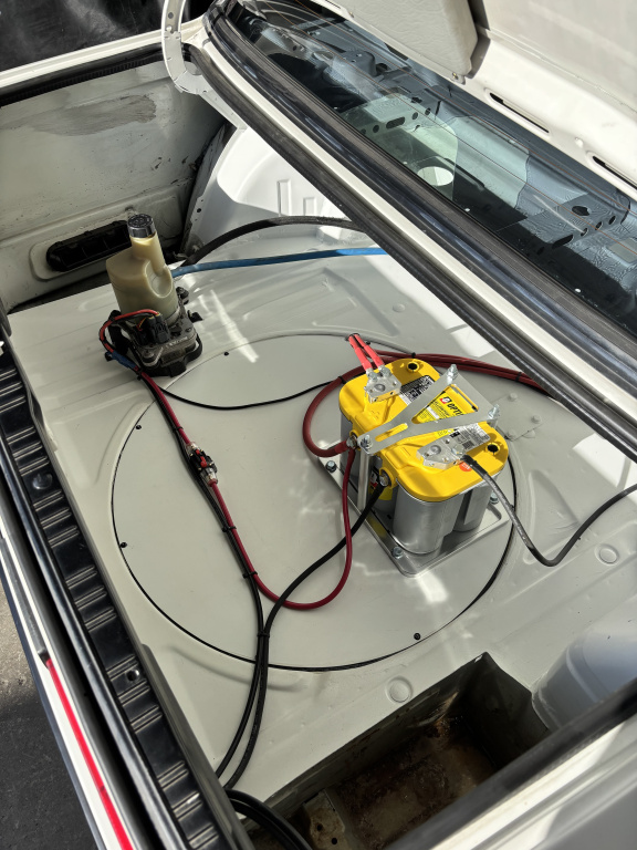

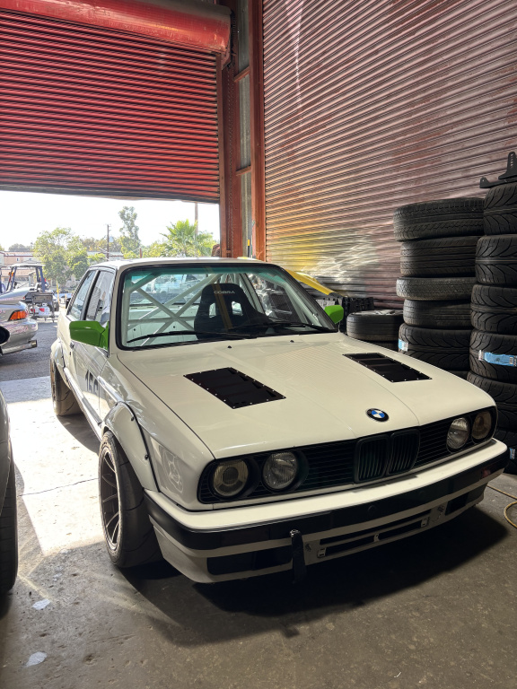

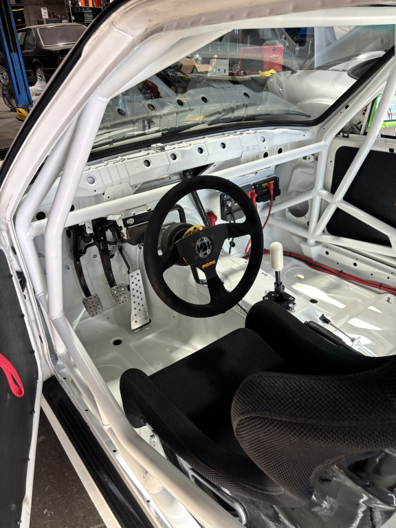

                        E30 is currently at Elijah’s shop (Joe Customs) and he’s doing an awesome job of finishing loose ends and putting in the cage! Can’t wait to see it done and painted. All the Haltech parts are the in the garage and ready for install/wiring. A few pictures of the progress.

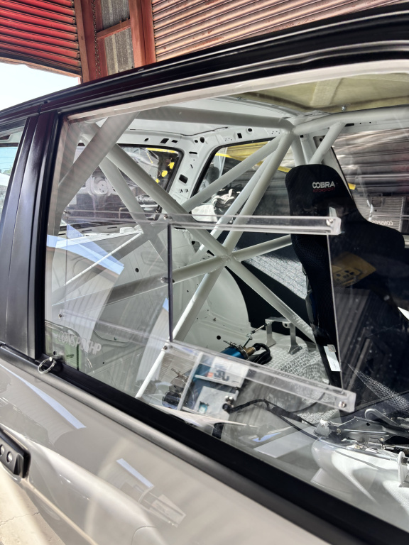

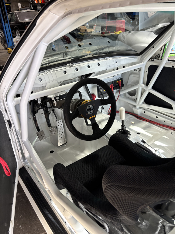

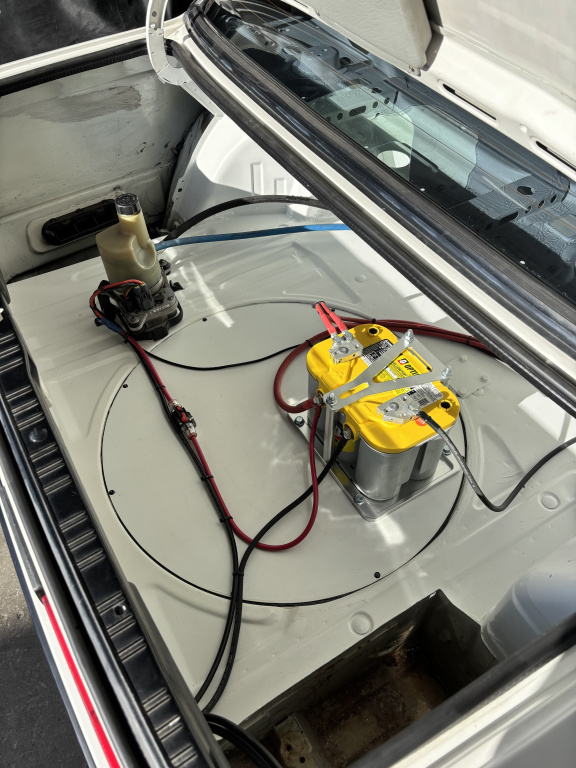

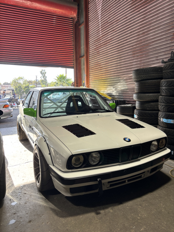

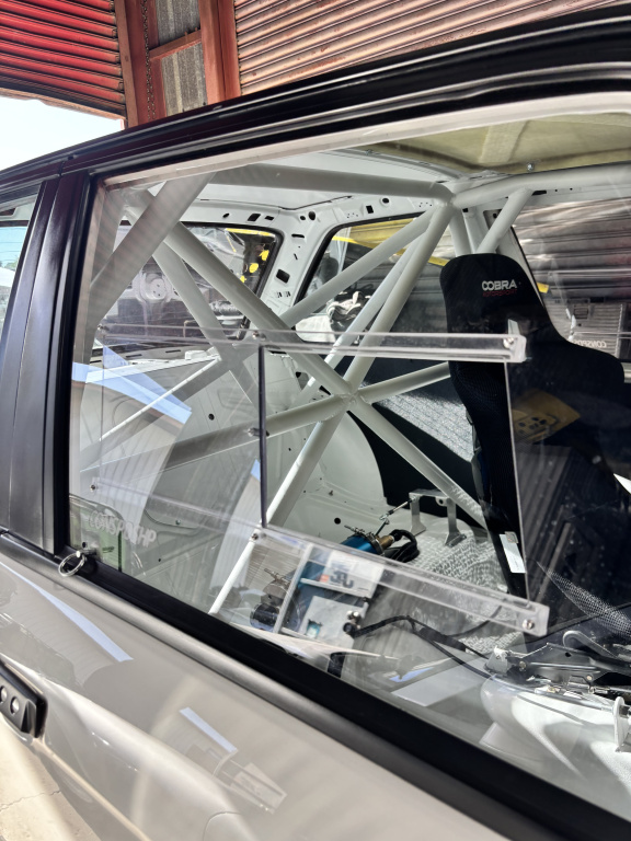

                          More update photos sent over by Elijah. Full cage is in and painted along with a bunch of functional upgrades and loose ends. Pick up this Friday then Haltech wiring starts.
