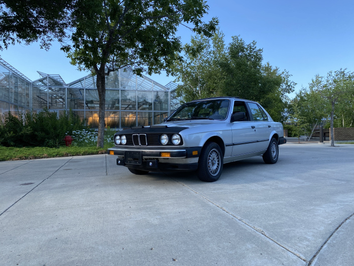

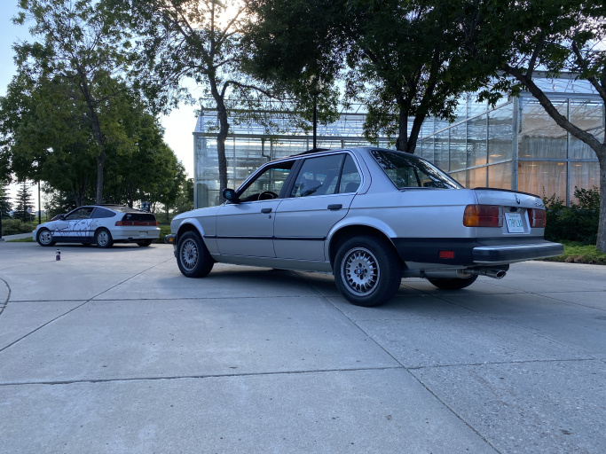

    Grandad-Spec '85 Slushbox ETA - Blank Canvas
    Hey R3V, not a full newbie (posted a few times on the R3V FB page and am more active on the r/E30 Discord), but I think I might try my hand at this journaling thing. I've lost too many pictures to bad backups and I lurk too much on this forum anyways. Going to summarize the 4 years of ownership and track everything I do starting in 2024 onward. I bought my car toward the tail-end of 2020. COVID was still raging on, and my 2 weeks off from college had reduced my summer to randomly cycling all around the city or daily bouts of COD Warzone with the guys to keep busy. Needless to say, I needed a change.
    I had my eyes on getting an E30 for quite a while, but a lot of the E30s in Canada were concentrated in BC or Ontario. Not enough yuppies in the rectangular province of SK. Saw 2 cars: 1 Alpine White '86 325E that wasn't running, and a red '87 325is with more speed holes than I knew what to do with. Then this one popped up about 2.5hrs away from me: Polaris Silver, Pacific Blue interior with comforts, 175k km, bone stock '85 325E. I was kind of uninterested since it was an auto ETA sedan, but my buddy convinced me to go and check it out. Not sure why I decided to buy it there and then, but I did. Did a crafty payment to avoid paying PST, and drove it back the 2.5hrs home. This is with my buddy's CRX Si (which is now in pieces thanks to rust). She's a Victoria car that was brought over to my province by the PO who owned it for ~3 months before I got my hands on it. No rust on the body, but I was pretty naive to think that a car this old could escape it (as I find out soon enough).

    most of the pics failed.
    noticed the greenhouse in the back, studying ag at u of s ?
    there's more of an active car scene in saskatoon than regina. for a few years there were some e30 folk up there. check some of the car clubs and social media, you'll probably be able to find a few of them.
