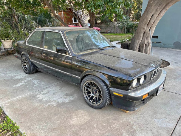

    Found the car on FB marketplace in South Pasadena and at the time it seemed like an ok deal and it had what I was looking for: manual, 325is and decent paint.
    Upon inspection it had been sitting under a tree for a long time so it was filthy.
    CONS
    • No maintenance history.
    • Interior was rough with ripped passenger seat and cracked dash.
    • Entire check panel was lit up
    • windows didn't work
    • car didn't actually rev to redline , only 5550 rpm which seemed weird
    • Power steering did not work
    • brakes were questionable.
    • Massive oil leak out of every orifice
    PROS
    • But it was clean title
    • rust free
    • straight body
    • manual
    • 325is
    • somewhat recent repaint
    • already lowered on H&R race springs and Bilstein B8s
    Since I didn't really know what to look for nor know how to drive a manual I brought my friend along who had driven and worked on some E30s before. Ultimately for better or for worse I ended up buying the car. Convinced the seller to throw in the original wheels for the asking price.
    Here is what the car looked like:
    Click image for larger version  Name:	331283452_906666624114783_1580738038629223546_n (1).jpg Views:	0 Size:	174.9 KB ID:	10135432 Click image for larger version  Name:	IMG_1527.jpg Views:	0 Size:	214.2 KB ID:	10135433
    Click image for larger version  Name:	330783085_742323460566574_824975462264292206_n.jpg Views:	5 Size:	192.4 KB ID:	10135434

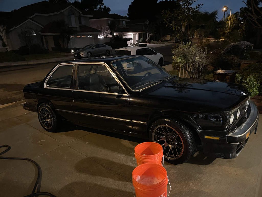

    Later that night once I got the car home I washed it to see what I was working with:
    Click image for larger version  Name:	IMG_9032.jpg Views:	2 Size:	295.5 KB ID:	10135438

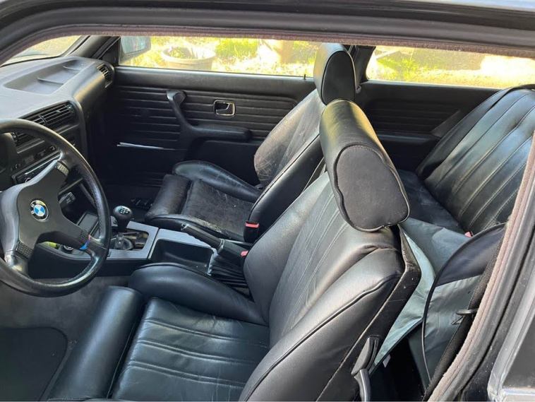

    Feb 22, 2023:
    Figured I should do a post-purchase inspection (out of order I know) to see what I got, took the car to Bullet Perfomance in Costa Mesa. They determined that the shifter bushings were complete toast, suspension bushings toast and the car has some pretty big oil leaks, but overall good bones. Then later that day the car was hit in the work parking lot. Damn! I hadn't even owned the car 24 hours! I was so glad I had added the car to my insurance the day I bought it. Luckily for me since I couldn't drive stick at the time, it wasn't my fault. Luckily for the car the damage wasn't too serious. Luckily for my friend, it was a low speed incident so nobody was hurt.
    Click image for larger version  Name:	IMG_1573.jpg Views:	0 Size:	221.3 KB ID:	10135437
    The seller had initially offered me a several day grace period to return the car back to him if I were change my mind, but with this happening, the car was definitely mine now.

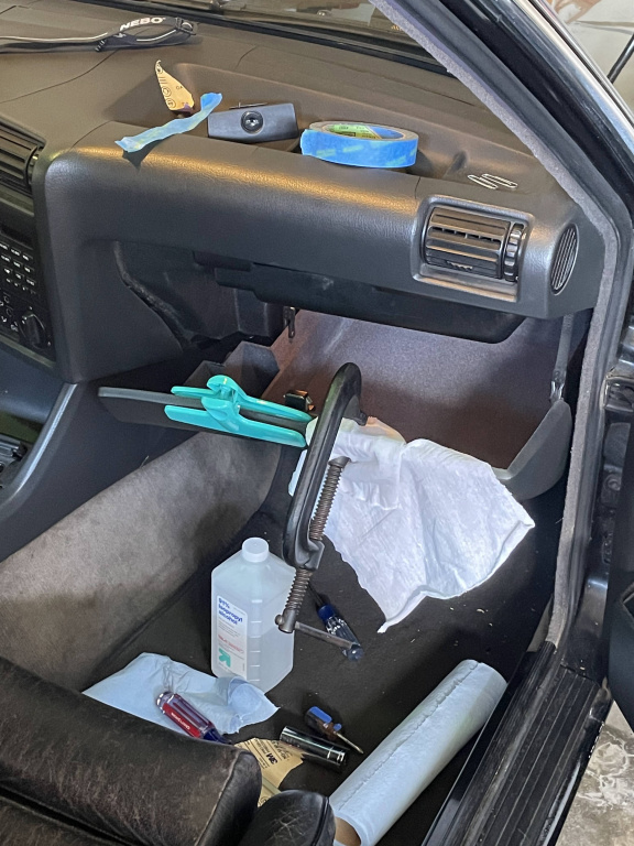

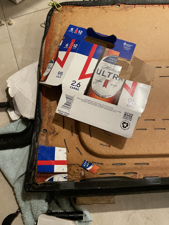

    The glovebox would not open since I got the car, the latch was broken and I was very curious to see what treasures may be lurking inside. I unscrewed the back from the hinge and forced it open which cracked it in the process. Not my brightest hour but it did open up. Bought a new Chinese latch for it on ebay and swapped the key over. Next I had to glue humpty dumpty back together:
    Click image for larger version  Name:	IMG_9101.jpg Views:	0 Size:	208.1 KB ID:	10135442

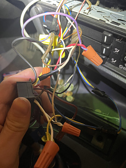

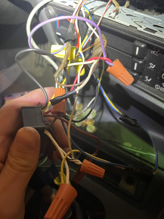

    The stereo was incapable of producing any sound so I decided to tear into that and was greeted by this previous owner job:
    Click image for larger version  Name:	IMG_9111.jpg Views:	0 Size:	174.8 KB ID:	10135444

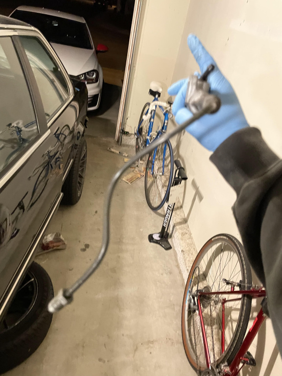

      The car attempted to strand itself for the first time, thankfully in my garage. I attempted to practice driving it and the clutch went to the floor never to return. My keen diagnosis from the puddle on the garage floor was slave cylinder. I jacked up the car and confirmed this to be the case, then accepted my fate and ordered new master cyl, slave cyl and new hoses. Seeing this febi slave cylinder die an early death convinced me to pony up for FTE components.

        After studying the radio wiring threads for retaining the factory amp, I figured out the 1987 ETK had a mistake relative to my car. The power wire for the radio was supposed to be grey/red not green red or something like that. Ditched all of the nasty wire nuts and recrimped everything. Finally I was greeted with some nice crackly audio. Sounded pretty bad but I was so stoked to finally have any sound in the car.

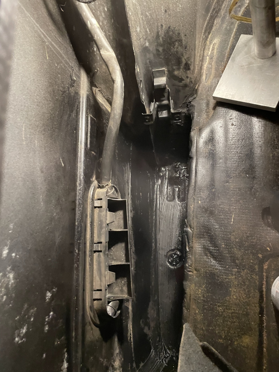

        The left side trunk pocket was pretty dirty when I got the car and I soon realized this was due to the power antenna being non-functional and the associated body grommet for it having disintegrated. Pulled out the trunk carpet to gain access to the power antenna and diagnose further and was greeted by this nastiness: Trunk mud and rust as well as upper shock mounts that were toast.
        Mar 20, 2023:
        My initial replacement parts haul from FCP came in. Ordered everything to refresh all the fluids, air and oil filters, fix the shifter, do timing belt, water pump, all suspension bushings, and take care of all the engine leaks.
        Removed the rust in the left trunk well and rust encapsulated it:

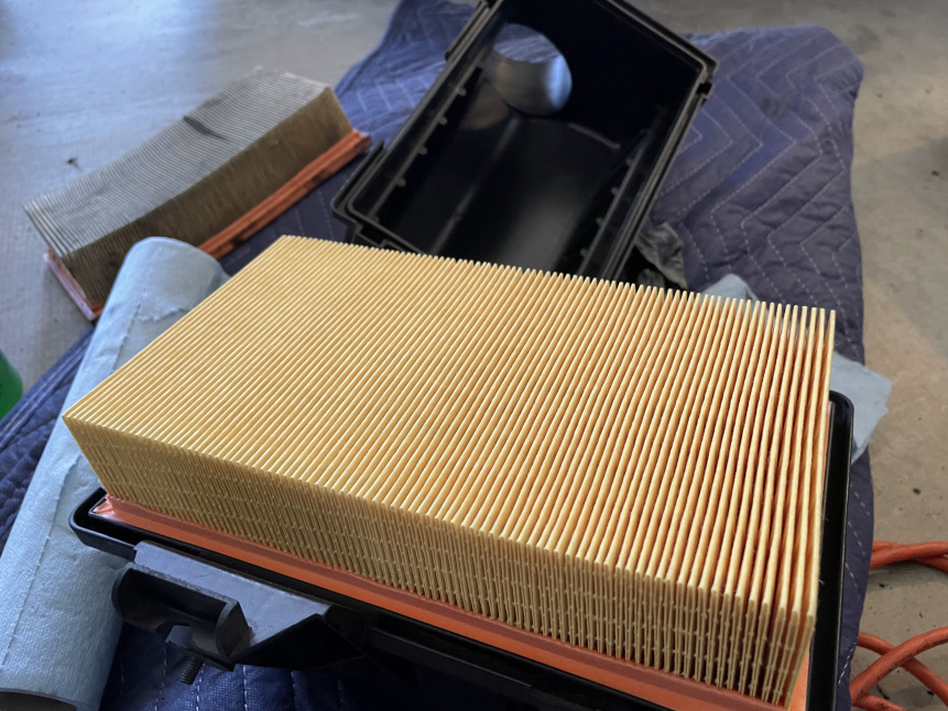

          Installed a new airfilter. So nice and clean!

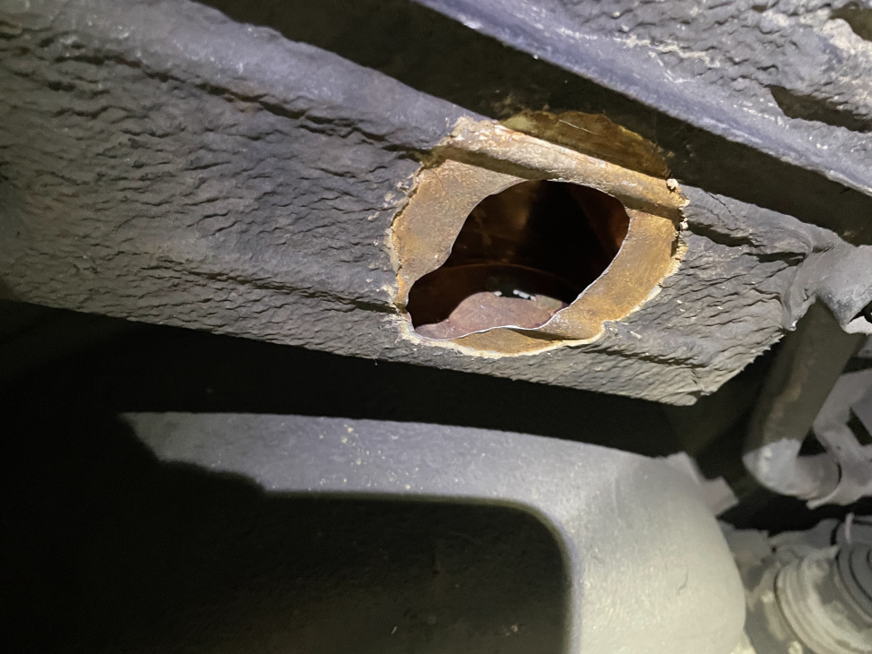

              Decided to check the right side of the trunk and discovered battery tray rust. Ground out all the rotted area:
              Click image for larger version  Name:	IMG_9462.jpg Views:	0 Size:	256.9 KB ID:	10135455

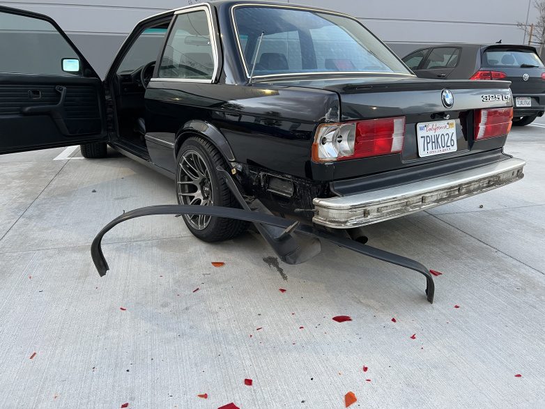

              Around this time I sent the car off to the body shop to get the damage fixed. I also had them weld up the battery tray and fix my bent antenna hole.

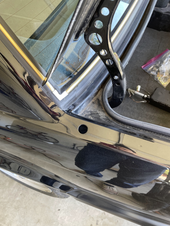

              Tore down the Hirschmann antenna unit and realized the the mast mount was cracked and the control board was toast. Picked up a spare in Fontana and rebuilt it with a new mast and combined the best parts of both antennas. Result: Power antenna works again!
              Fixed antenna hole:
              Click image for larger version  Name:	IMG_9826.jpg Views:	0 Size:	221.8 KB ID:	10135456

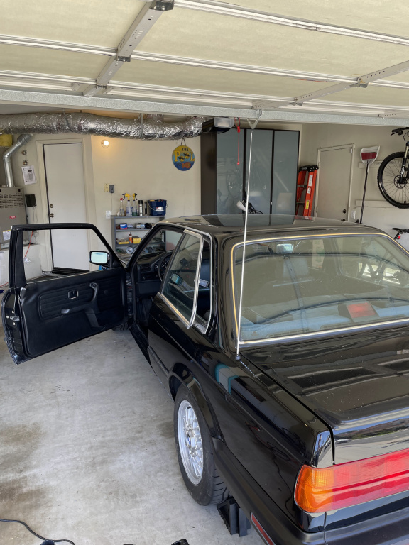

              Success! power antenna raises and lowers!
              Click image for larger version  Name:	IMG_9827.jpg Views:	0 Size:	195.5 KB ID:	10135457
              Here you can also see the repaired left corner. Rear bumper was replaced with new since it was an insurance job and left taillight and diving board side trim was also replaced.

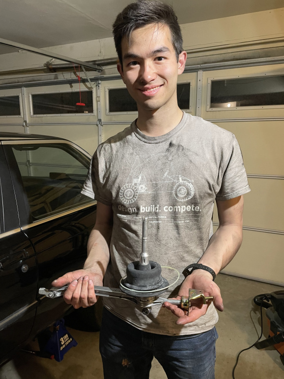

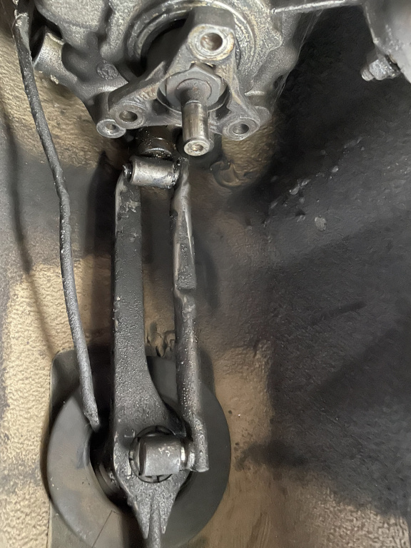

              Next up was replacing the shifter bushings. Underside was disgusting with a major oil leak going on. Got the shifter carrier disassembled, cleaned up and reassembled with new parts. Replaced all with oem style so I could see how it was supposed to feel before deciding to upgrade anything.
ID:	10135458 Click image for larger version

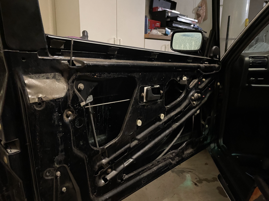

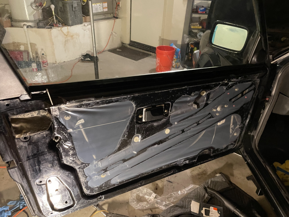

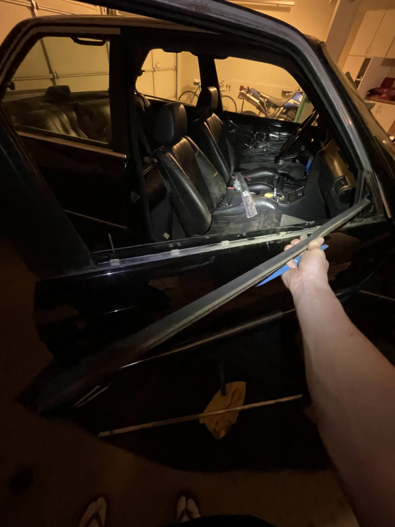

                The door window scraper seals were super dry rotted with chunks missing. In light of the rust I discovered with the antenna hole, I was worried about water intrusion into the doors so I decided to tackle this next.
                Click image for larger version  Name:	IMG_9886.jpg Views:	0 Size:	135.7 KB ID:	10135461

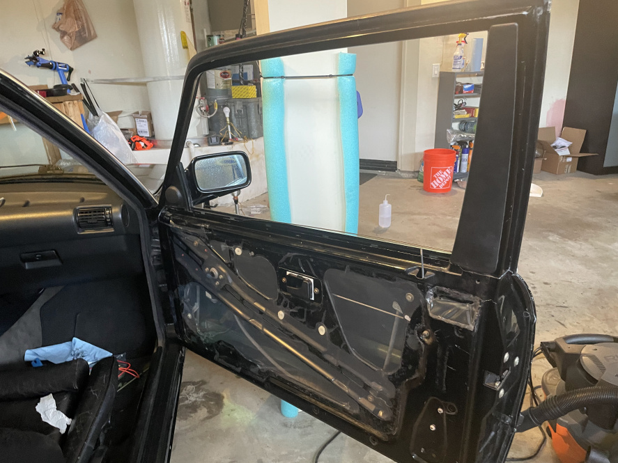

                I used some carpet shield from Home Depot to make some new door vapor barriers. For these, I just stretched the roll over the door and then post trimmed with a knife.
                New vapor barriers
                Click image for larger version  Name:	IMG_9875.jpg Views:	0 Size:	331.4 KB ID:	10135462 Click image for larger version  Name:	IMG_9969.jpg Views:	0 Size:	254.3 KB ID:	10135463
                Since I had the door cards off it was time to fix the sagging corner on the drivers door card, I reinforced the backside of the pressboard material with some Michelob ultra and gorilla wood glue. This worked really well. I also reinforced all the clip holes.
                Click image for larger version  Name:	IMG_9876.jpg Views:	0 Size:	224.8 KB ID:	10135465
                So much better!
                Click image for larger version  Name:	IMG_9968.jpg Views:	0 Size:	175.1 KB ID:	10135464

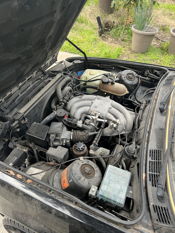

                      Nice pick up. Looks like an honest survivor car which is a great starting point. Post some engine bay pictures.
                      Here's how the engine bay looked when I bought it.
                      Click image for larger version  Name:	IMG_1525.jpg Views:	3 Size:	280.7 KB ID:	10135524

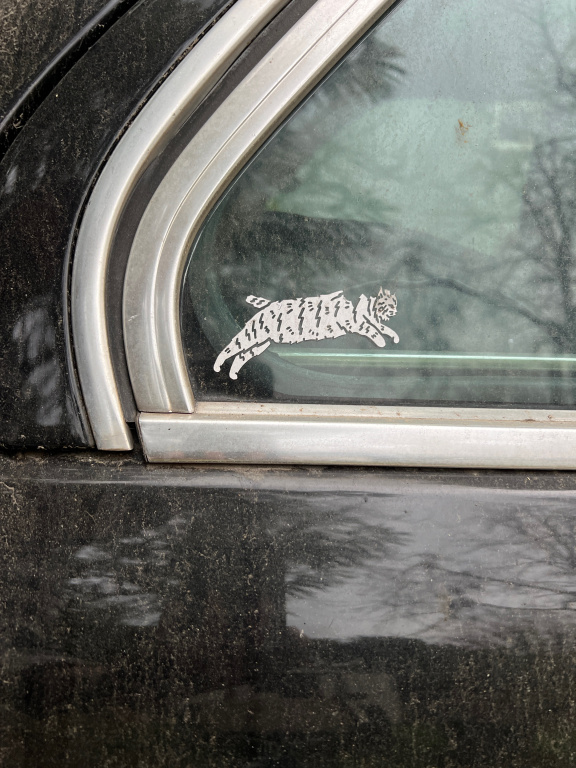

                      Apr 30, 2023:
                      I really liked the leaping cat sticker on the window, but sadly during my first trip to the gas station after buying the car, the cat lost its head to the window squeegee. Thankfully my friend had snapped a pic of it. Cleaned it up in photoshop, got it printed and trimmed it out with an x-acto, and voila!

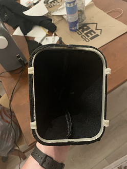

                        May 28, 2023:

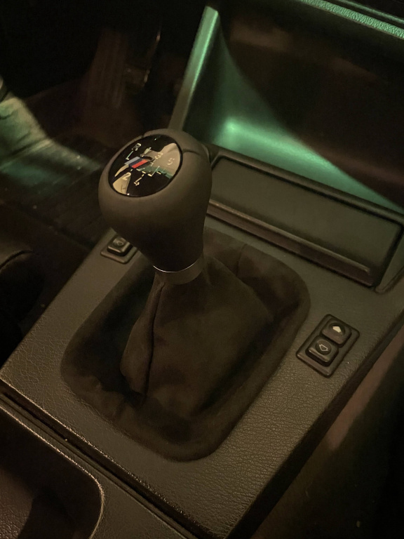

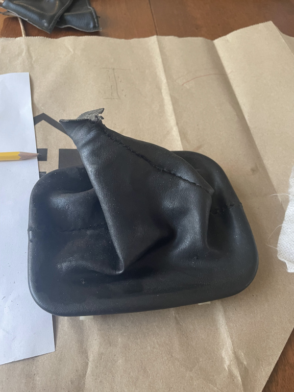

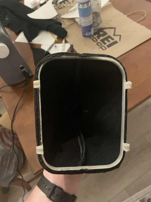

                        The lack of a shift boot had been on my list for awhile. My roommate bought a sewing machine to make shift boot for his car so I figured I should make one too. First, I bought the grungiest boot I could find on ebay. Used a seam ripper to pull it apart and trace it for a pattern.
                        Click image for larger version  Name:	IMG_0394.jpg Views:	0 Size:	147.4 KB ID:	10135528
                        We picked up some micro-suede from A1 Foam and Fabric in Santa Ana. The material pretty cheap and gave us plenty of material for screwups. After my second try I got the fitment right.
                        Click image for larger version  Name:	IMG_0398.jpg Views:	0 Size:	131.5 KB ID:	10135529
                        Glued the sewn boot to the original frame with contact cement.
                        Click image for larger version  Name:	IMG_0400.jpg Views:	0 Size:	129.7 KB ID:	10135530
                        Finished product all installed! The existing knob in the car was broken and would spin around on the shaft. Decided to see if the ZHP knob lived up to all the hype and ordered a fresh one from FCP.

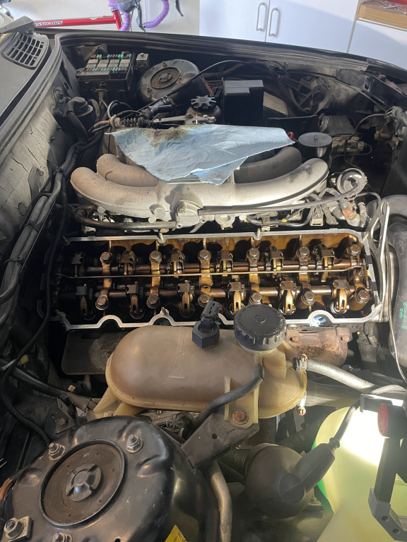

                              May 28, 2023:

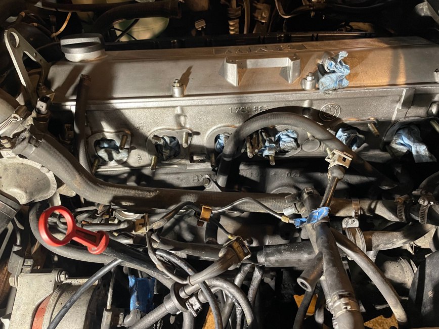

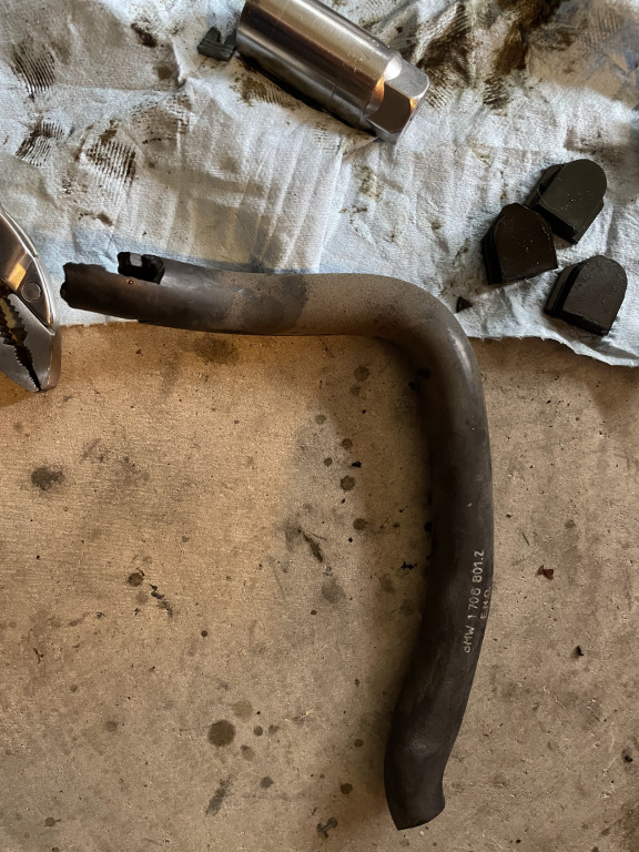

                              Did my first valve adjustment. Realized the rocker shaft plugs were shrunken and the PCV hose to intake was so old it shattered on me.

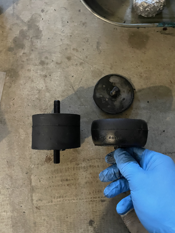

                              Replaced the motor mounts. Unbolted the motor mounts and jacked up the engine from the oil pan using a 2x4. The passenger side one was split into two pieces!
