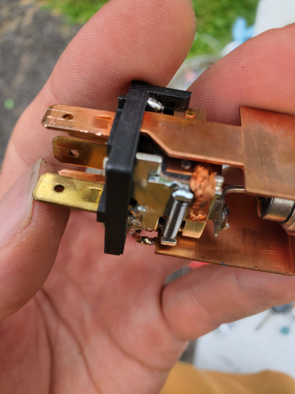

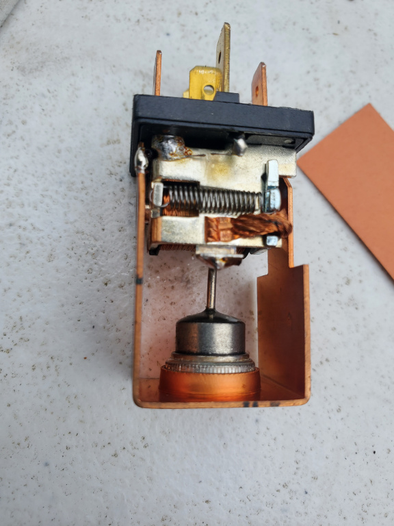

                              Installed my ABS unit, new master cylinder, bled the system. All is well, pedal feel is decent car stops decent but still not great. Still have ABS light on after start up and stays on.
                              Removed the ABS module and disconnected the relay above it. And discovered the Fuse inside that is blown. It also looks like the copper coil isn't soldered into the pool of solder. Seems like it's resting on it? I posted two pictures
                              Anyone know what material and gauge that wire is? I'd like to get that soldered up and reinstalled asap.
                              Planning on pressure bleeding the entire system again. After that is soldered up and installed.
                              Help!!

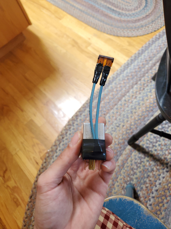

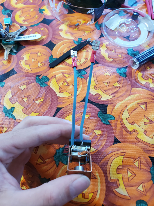

                                Installed a little circuit onto the relay to hold a 7.5 amp fuse and it fixed my ABS system. Light is off and pump is operational.
                                Jorden from MTechniqueabs is a master at his craft, he rebuilt my ABS and got it back to me in a week.
                                Some pictures of my relay fix. 18 gauge wire soldered to the relay, female terminal that fits the Fuse crimped to the wire. And the 7.5 amp fuse to complete the job..
