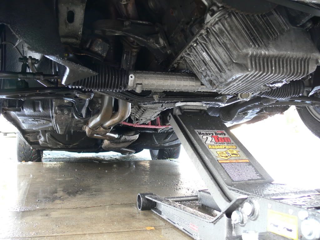

                Had fun with the pressure washer today. This used to be completely covered in grime. I'm going to try and spot my PS leak now.

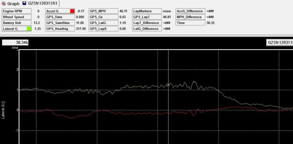

                            this car its awesome. im really impressed with all the work done one it. the R888s seem to stick pretty well(i wasnt able to push it, due to being on the street), i heard >1.4Gs i thinks is what he said. as soon as that CSB and diff get changed its gonna rock so hard.

                              Thanks bud, it puts a smile on my face every time I drive it. Oh and it's 1.2G sustained actually, but I did technically peak 1.43 :p
                              I'll have to do some more logging when I have an actual alignment and the tires are warm.

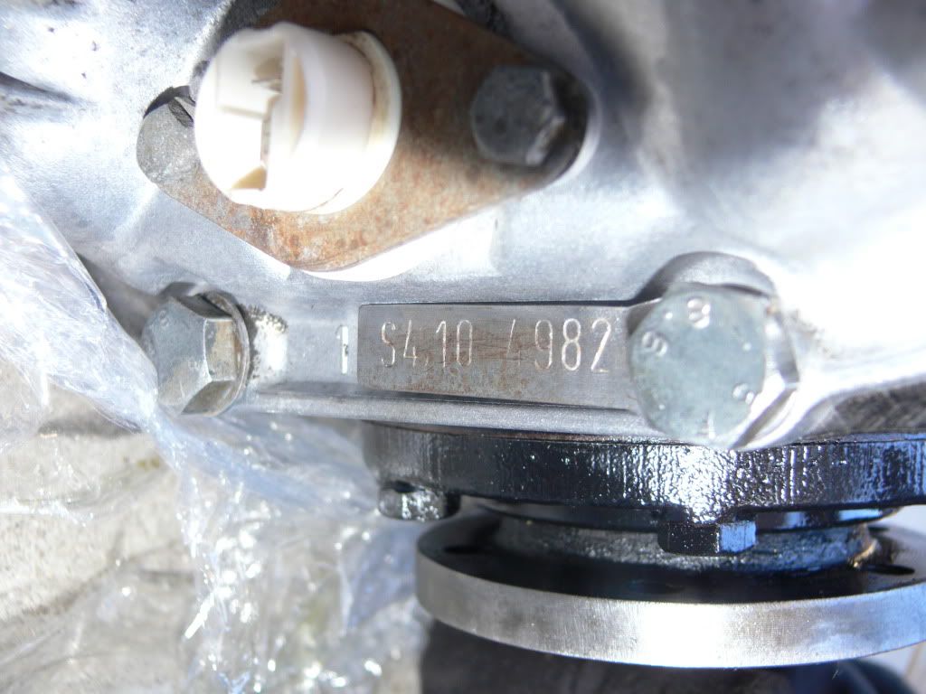

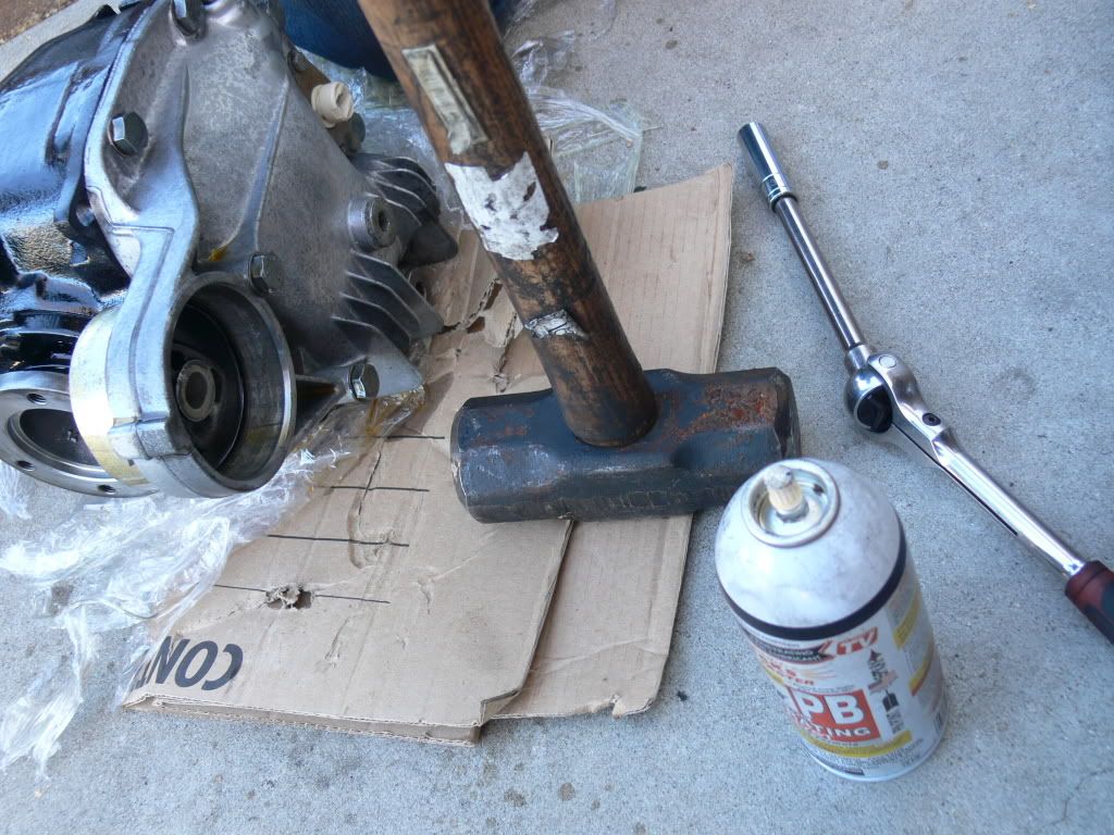

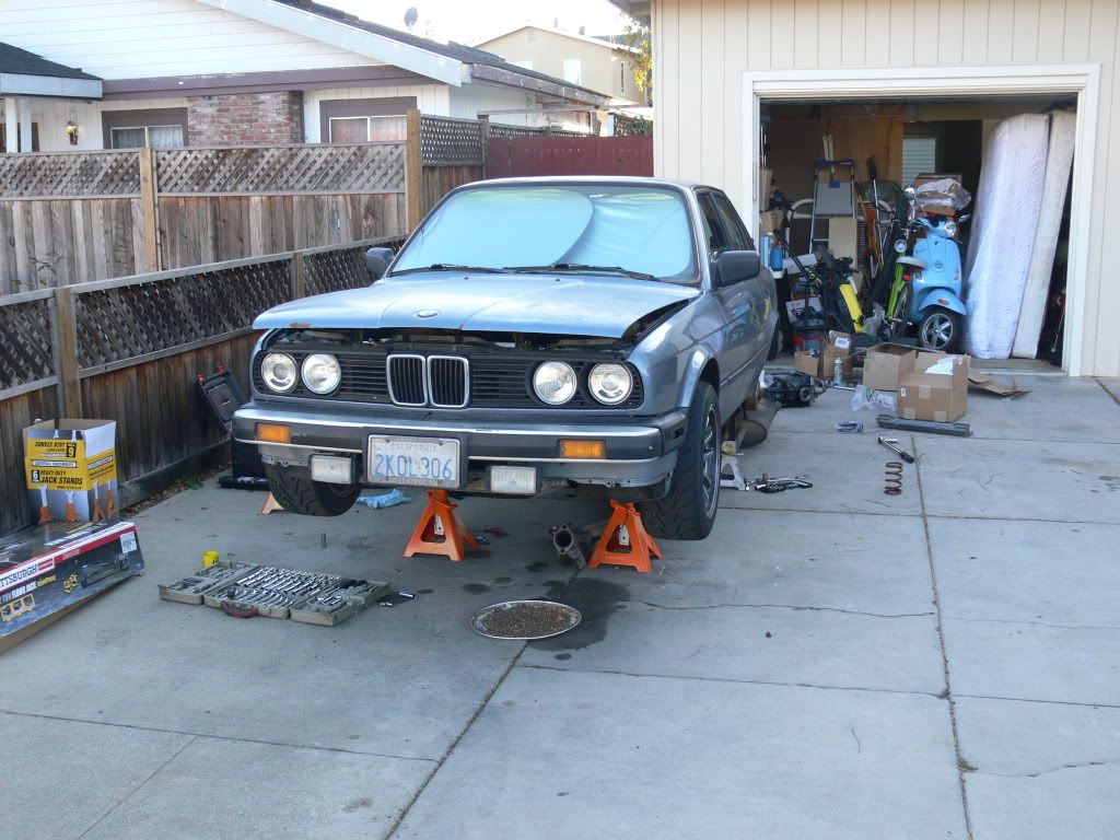

                              Anyway: oh herro

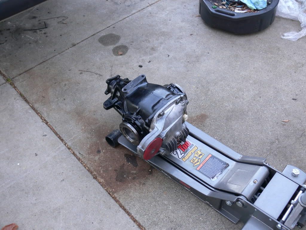

                              Out with the old
                              Here's the new (quiet) diff
                              Knocking the diff bushing out of the 4.10 was a matter of PBblaster and a BFH

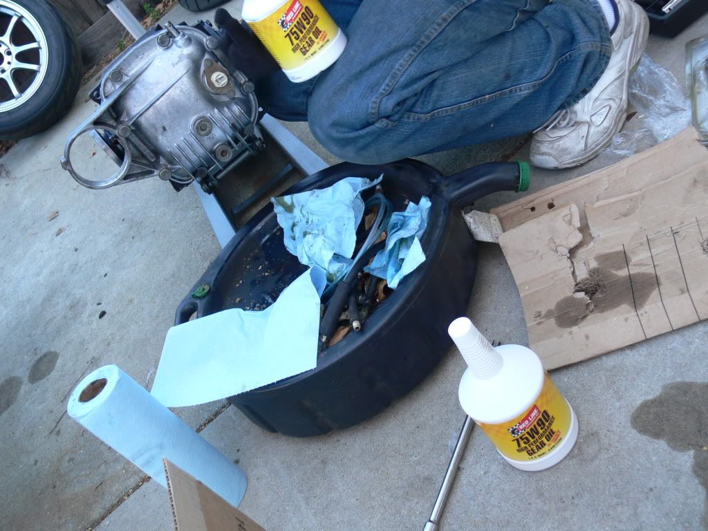

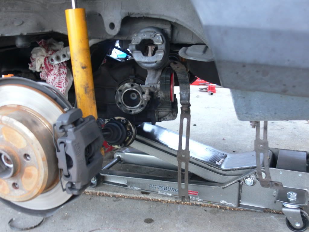

                              Filling the new diff

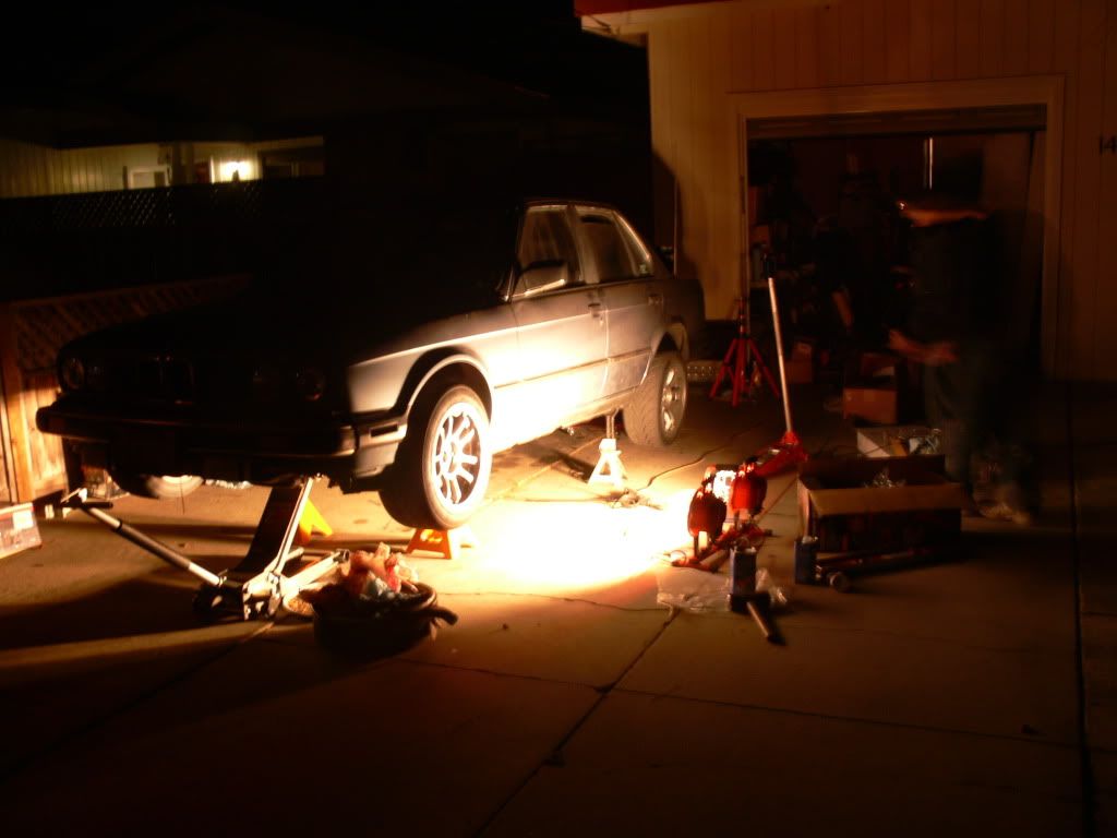

                              Aand in with the new

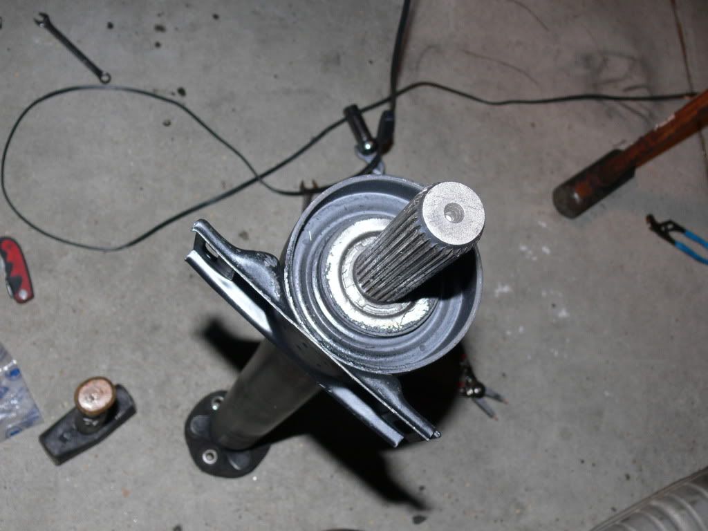

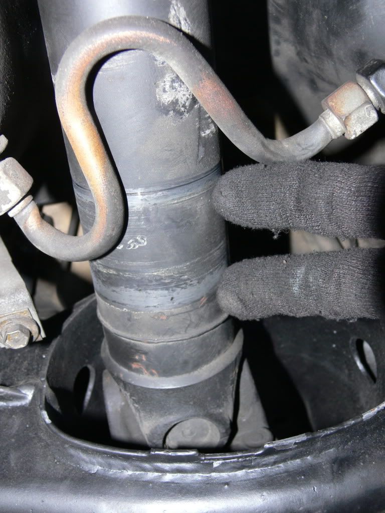

                              Here's where my driveshaft was rubbing

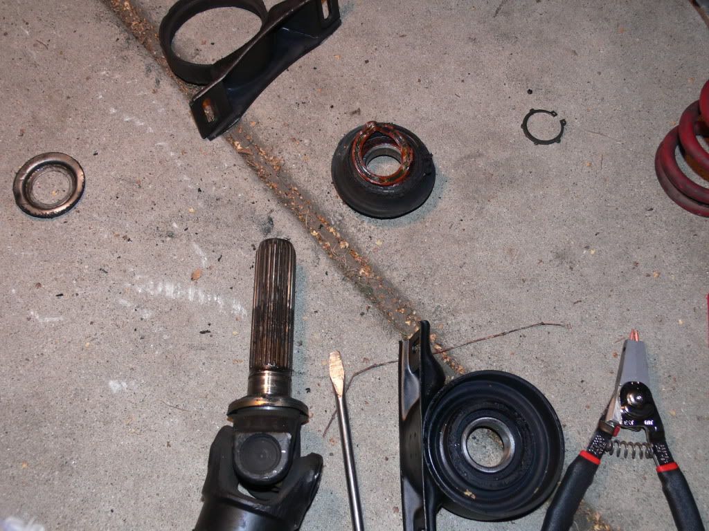

                              Off with the old CSB
                              On with the new
                              Last pic before we wrapped it up
                              Now my driveshaft is vibrating when I get on it hard, due to the angle. I think I am going to get new u-joints put in because they are binding and causing the bad vibes, so to speak.
