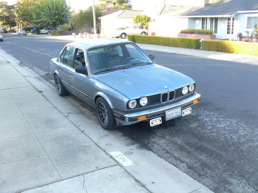

                              Anyway a recent pic--got rid of my fogs for some Hella 550 driving lights.
                              I am not impressed really. My high beams are way brighter than these already. I think I am just going fogless for now.
