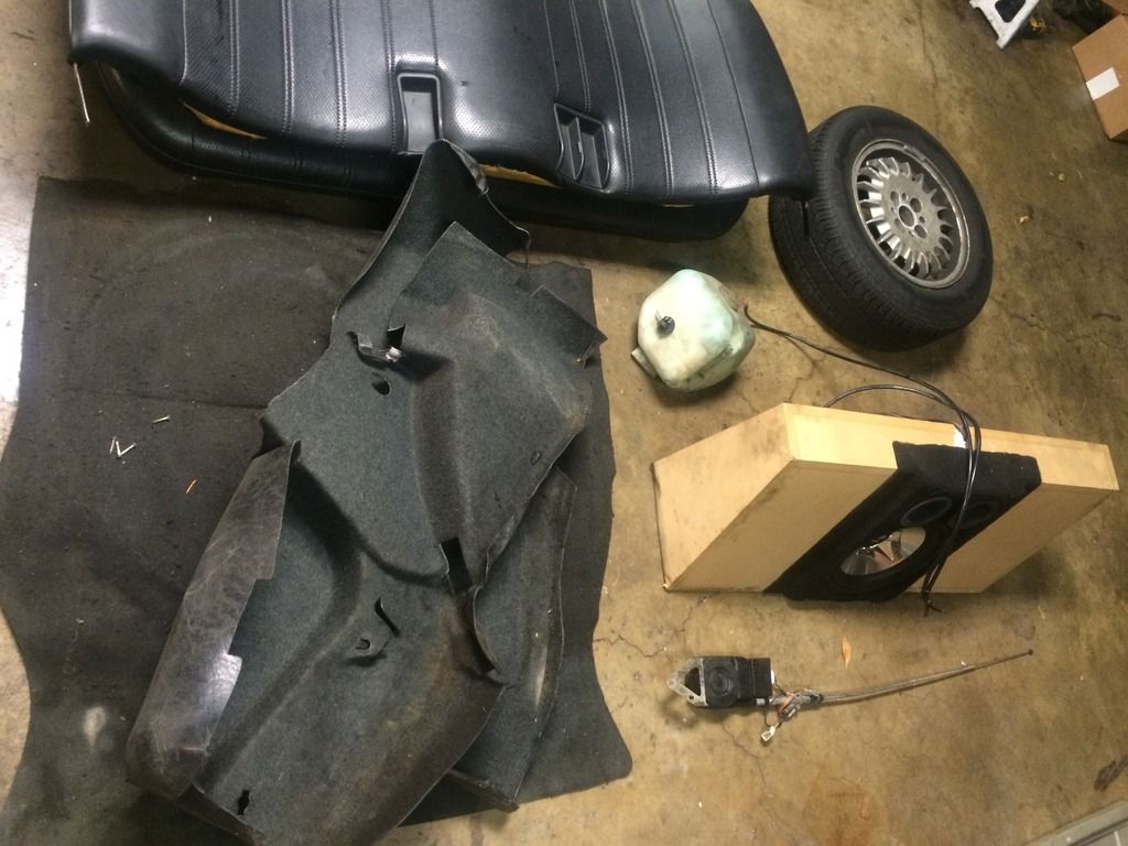

    Next, time for a track day. I have always left everything in the car for events including the spare and sub, but now I am starting to care about laptimes so I removed about 140lbs worth of stuff including the 65lb lukebox/amp and spare.
    (Re)installing racecar stuff!
    After taking some weight out I was able to manage a 5.7 0-60, not exactly fast but not bad considering you need 2 shifts.
    I'd like to do a full 1/4 mile run but that's a little tougher to do on the street.

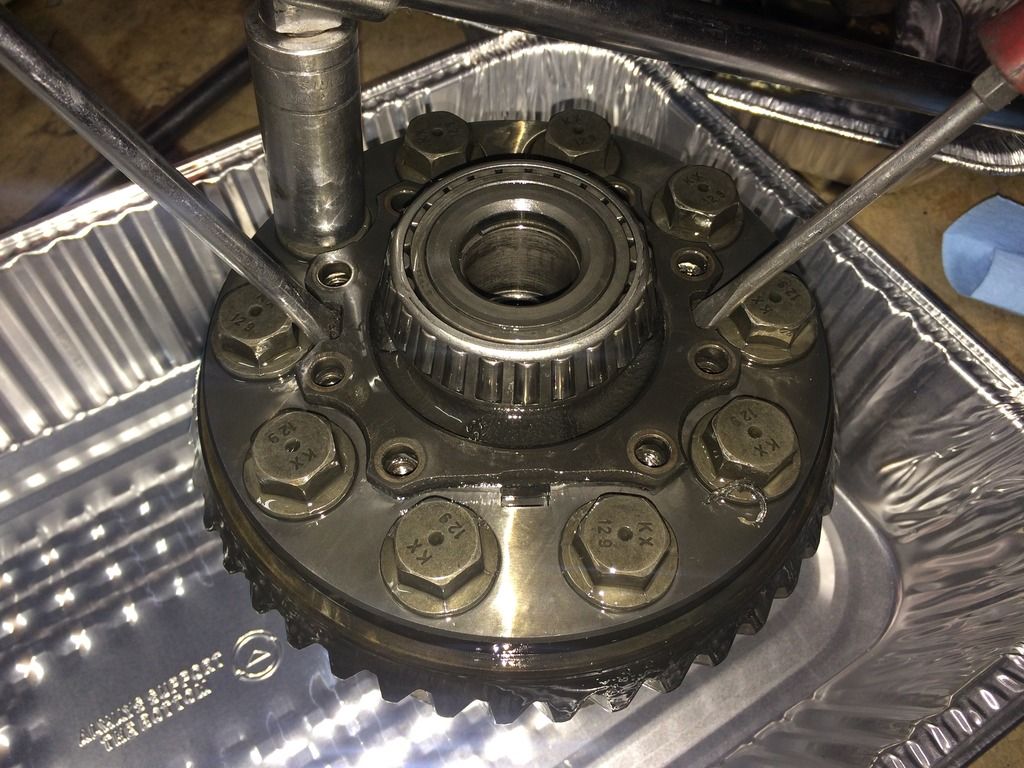

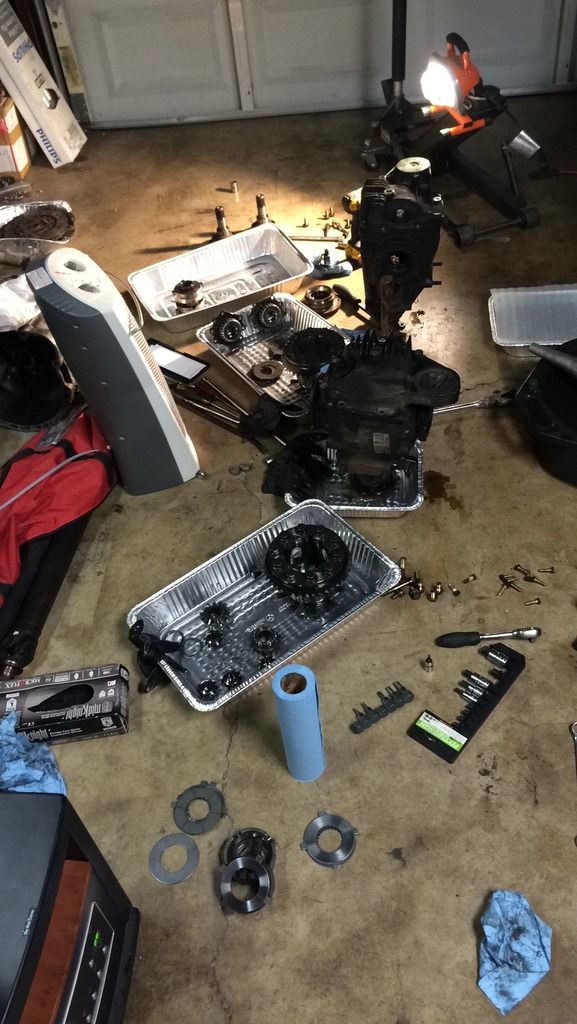

    So now the G250 and the 3.23 diff are in, but the diff doesn't want to lock. It feels tired. So, out it comes.
    My patented double-screwdriver method of cap removal. Much more effective pulling from both sides at once than going around and prying slowly with just one screwdriver.

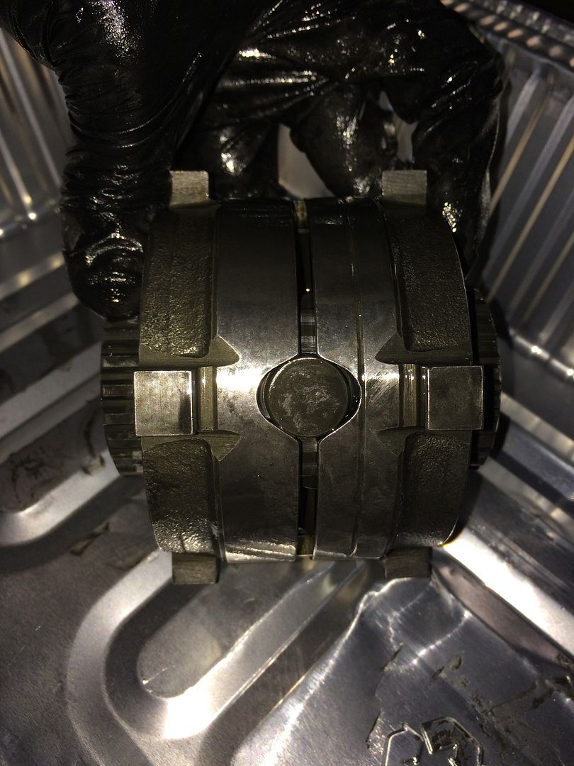

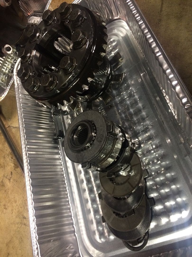

    I also gutted my 3- clutch 4.10 in case I needed parts. Messy oprtation.
    Here's what I found inside the 3.23. A factory 4 clutch diff! Pretty cool, haven't seen one before.
    The clutches don't look worn at all, plus they measure out to 2.0mm apiece.
    Hard to tell from the pic but the 4 clutch top cap (on the right) is 1.5mm thinner than the 2 clutch top cap (left), to make some extra room:

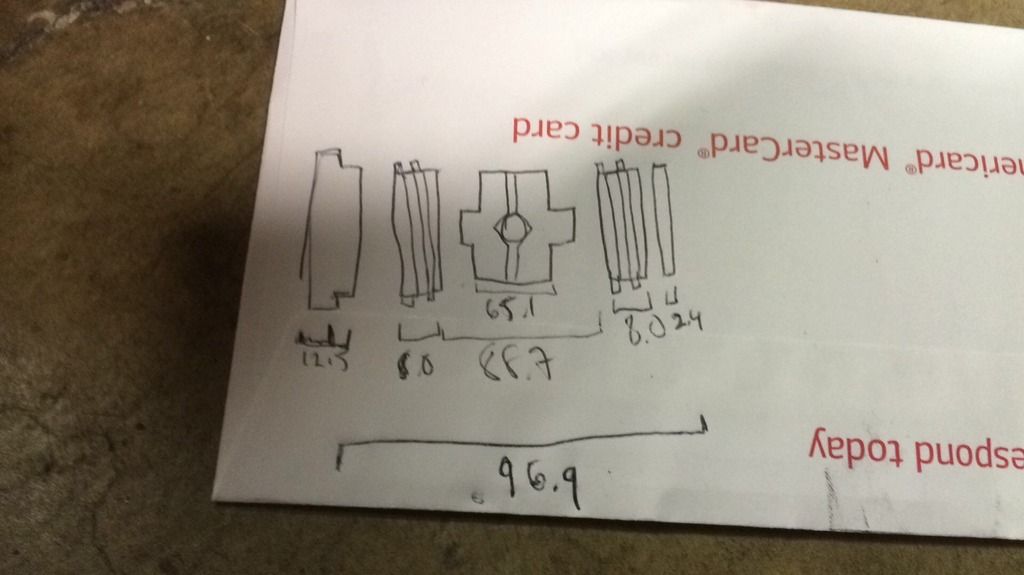

    Here's my shitty diff guts diagram.

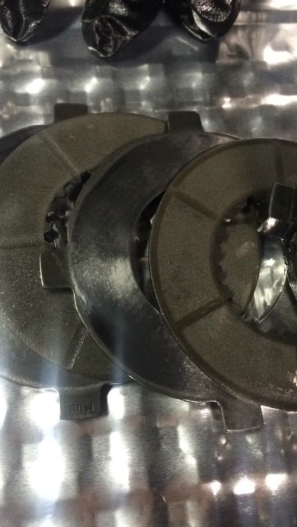

    So, if the clutches are in good shape, why isn't it locking? I notice two differences between this diff and the 3 clutch I built.
    1. Belleville washers. These are basically circular springs inside the diff that provide preload. The 4 clutch 3.23 didn't have any in it, which will mean there's no preload.
    2. The ramps. The ramps in the 4 clutch are asymmetric but are also quite tame, looking like 60 degrees or more.
    Here are the normal 45 degree ramps in the 3 clutch that locks well:
    And here are the grandma ramps in the 4 clutch that won't lock:
    The weaker ramps are also asymmetric which means they could have been installed backwards making lockup even weaker.
    So, I put the more aggressive 45 degree ramps in and replaced the 2.4mm spacer with a Belleville washer in the 4 clutch diff and put it back in. It locks fantastically now, but has a bit too much preload for my liking. I may take it out later to remove some of that preload as it makes the car push mid corner.
