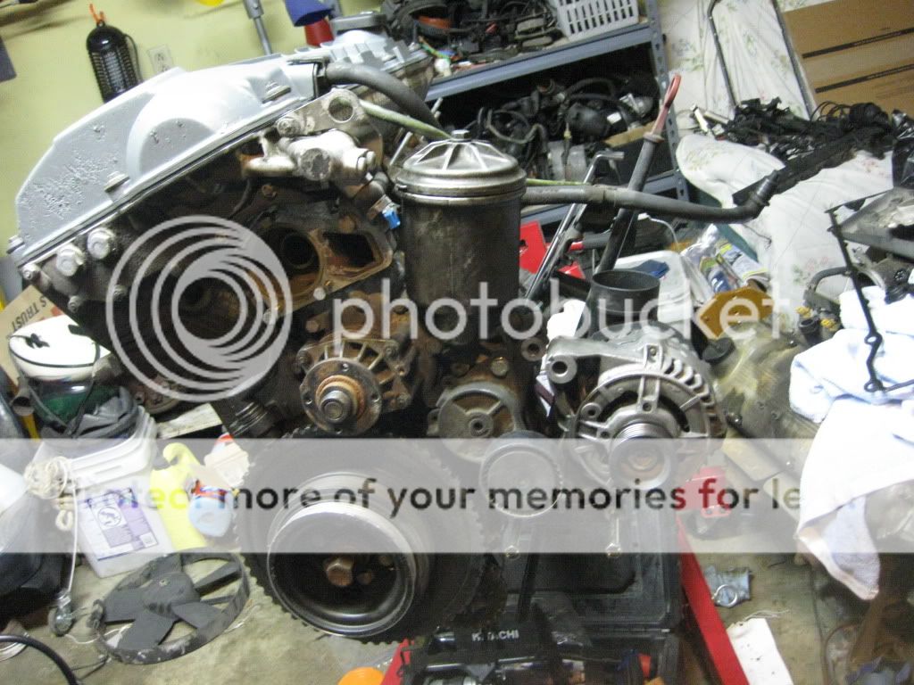

    Motor is starting to come together now. Just need the PS pump and im pretty much good to go.

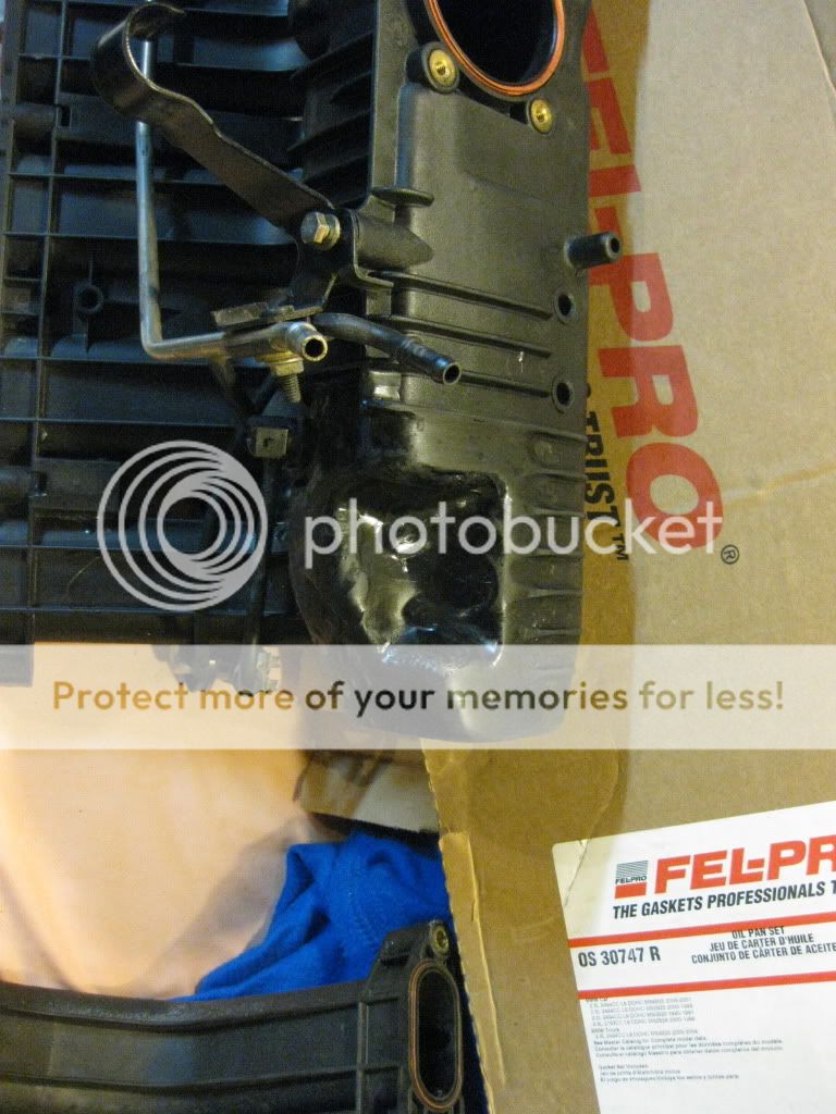

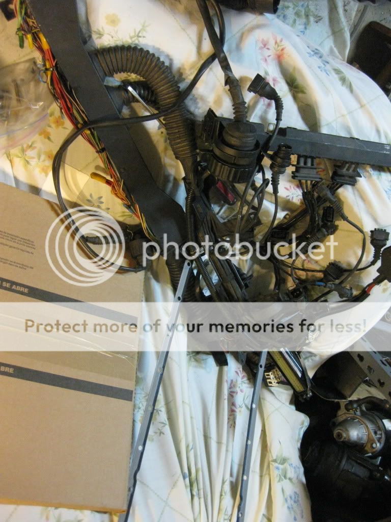

    Got my modified manifold from Castros
    Wiring harness and oil pan gasket too

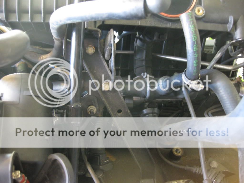

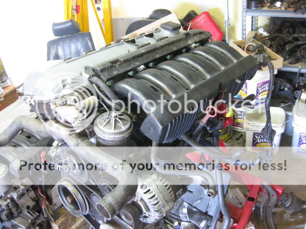

          intake does not look all that bad

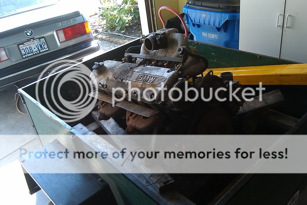

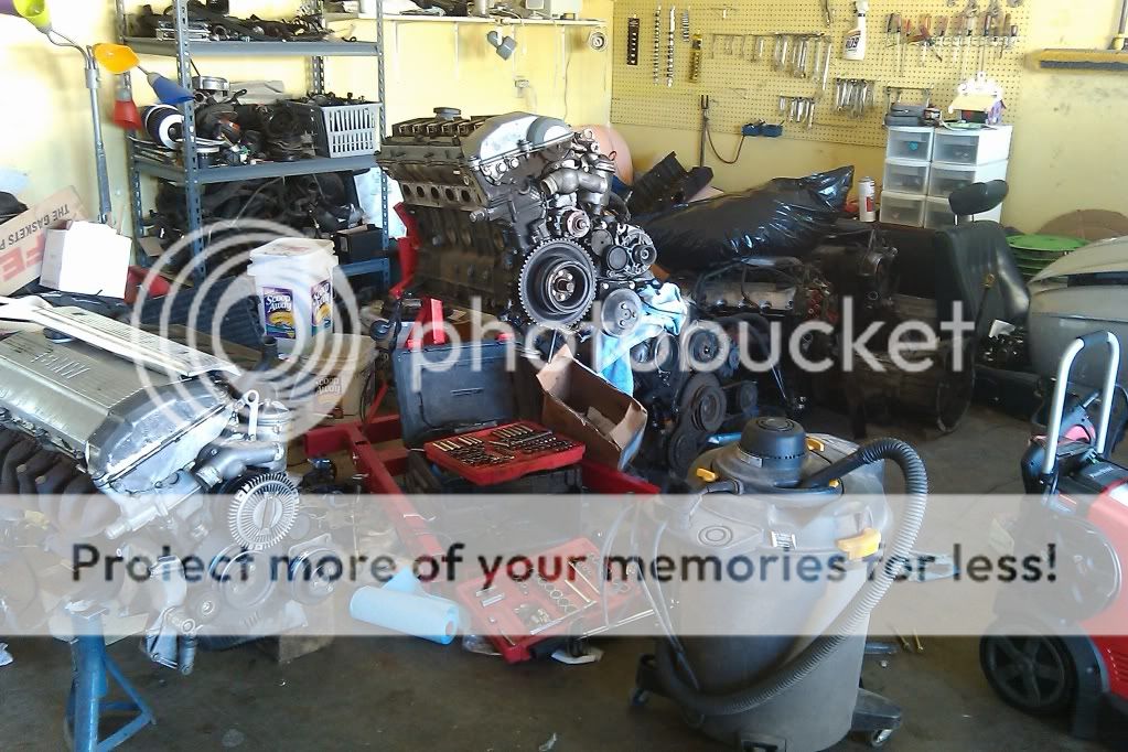

            I bought this NV M50 out of an E34 for the oil pan but I paid less than most oil pans alone go for. 244k but runs great and lots of maintenance including rebuilt head. Last owner had it for ten years before it got rear ended.
            This is completely mental now. NV M50B25, M50B25 TU, M30B35, M20B25, M20B27. Once I get my swap done I will start clearing house though.

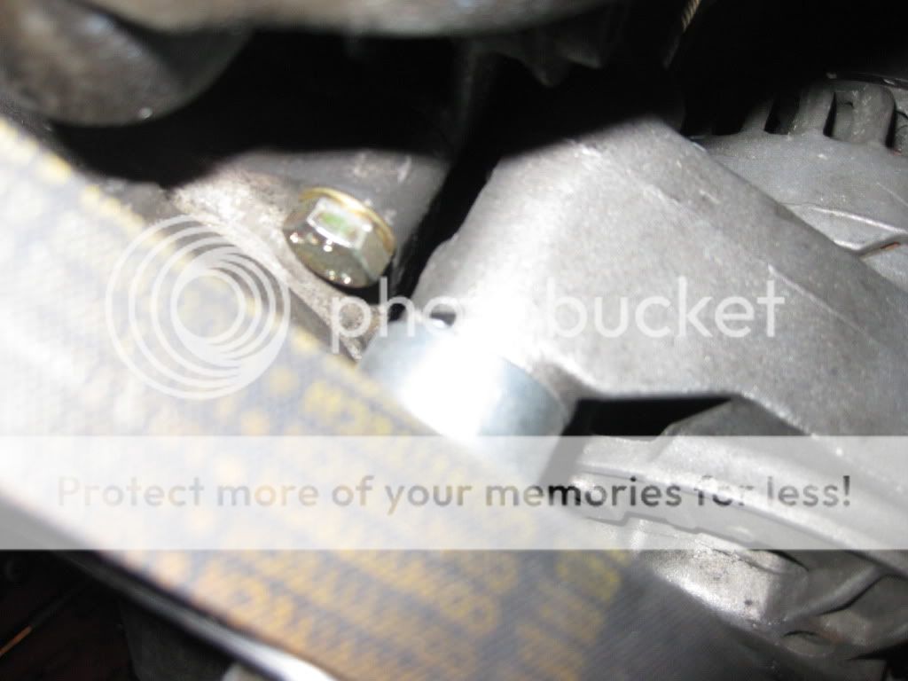

                  I am assuming this belt orientation is no good correct? I just cant see how I could possibly get the belt to go under the idler pulley. There is not enough slack.
                  • Danny
                    • 14217
                    #174
                    You need to rotate the eccentric.
                    • Wishno87
                      • 6025
                      #175
                      It has this little notch in it though that fits perfectly into this little indent in the alt so i thought you cant move it? Does the notch not matter?
                      • Danny
                        • 14217
                        #176
                        Loosen it, rotate it, then slide the belt on, rotate it back and tighten it. Its a mechanical tensioner.
                        • Wishno87
                          • 6025
                          #177
                          Massive success :p Thanks dude.

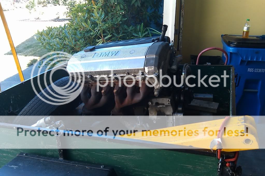

                              Finally found a home for the M30 so up and away it goes
                              My buddy from high school is going to rebuild it and put it in his 87 325i sedan.

                                Updates today!
                                Van Westervelt was kind enough to come plug in my wiring harness and give me some pointers.
                                Did my heater core safety bypass thing.
                                Engine is pretty much complete now.

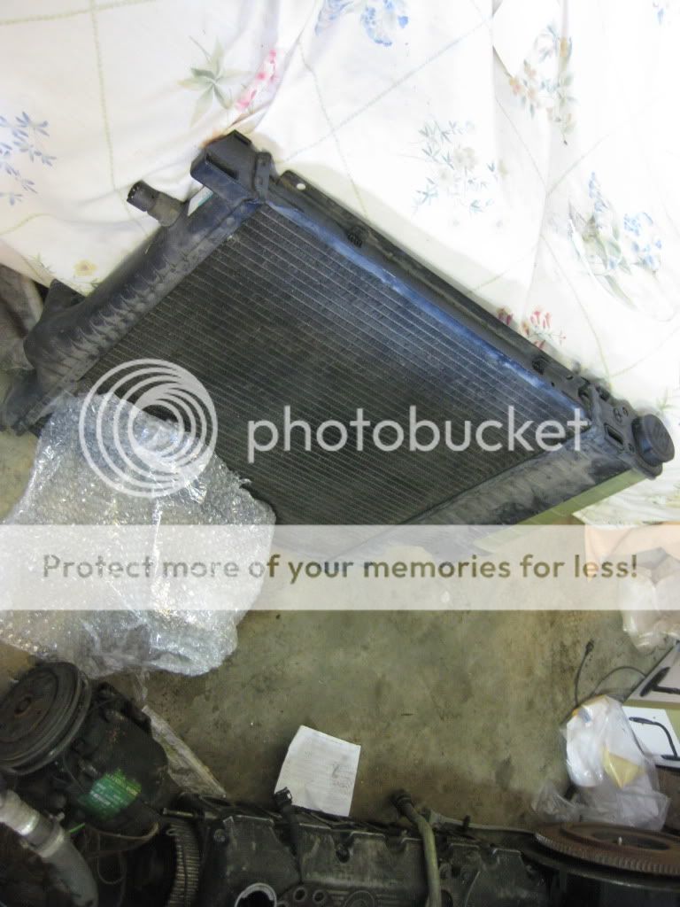

                                M42 rad I picked up.

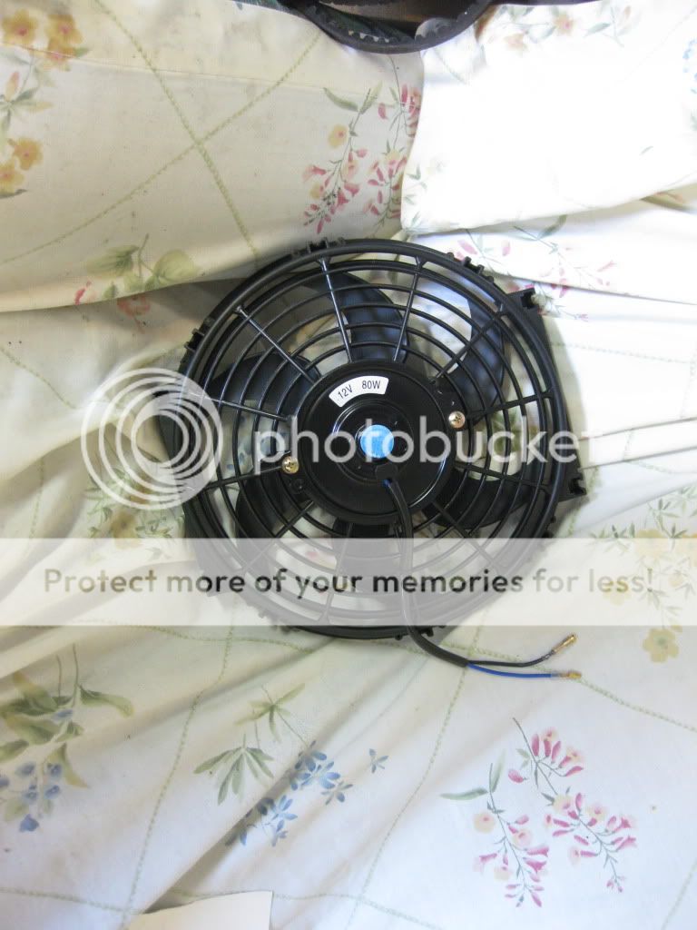

                                I plan to use this as a puller behind the M42 rad. The mfr claims it pulls 1600 CFM

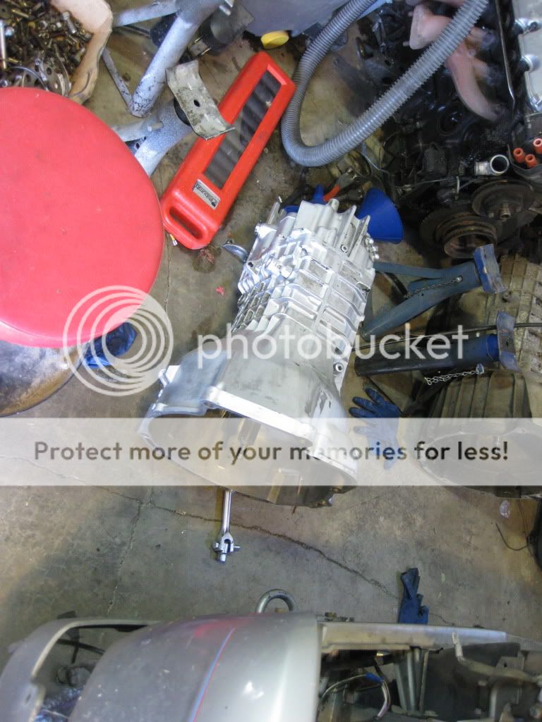

                                The G260 I will be using. The output shaft seal was already replaced and I replaced the input shaft seal.

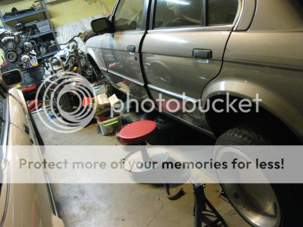

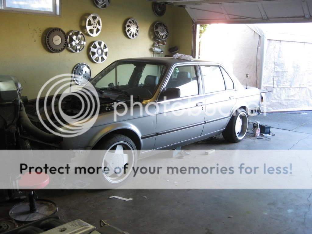

                                I put all the wheels on and put the car on the ground. Looks more like a car again then some junk in my garage.
