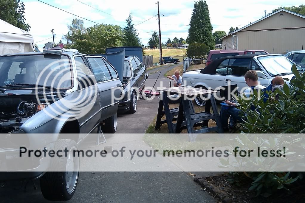

                            #208
                            Originally posted by Wishno87
                            Great Picture
                            Lookin good man
                            I like those type As on an early model
                            We're out there in here.
                            • Wishno87
                              • 6025
                              #209
                              Ya it was pretty cool to get all the local guys over. I had 5 E30s in my driveway at one time. Got the shift linkage all together tonight. Turns out im going to need to shim my motor mounts to get the headers to clear the subframe.
