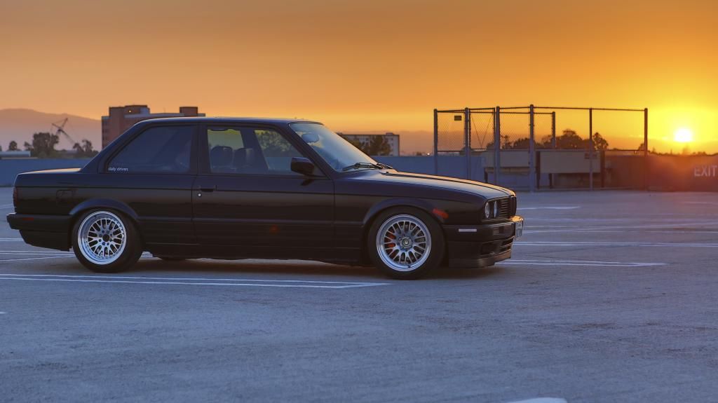

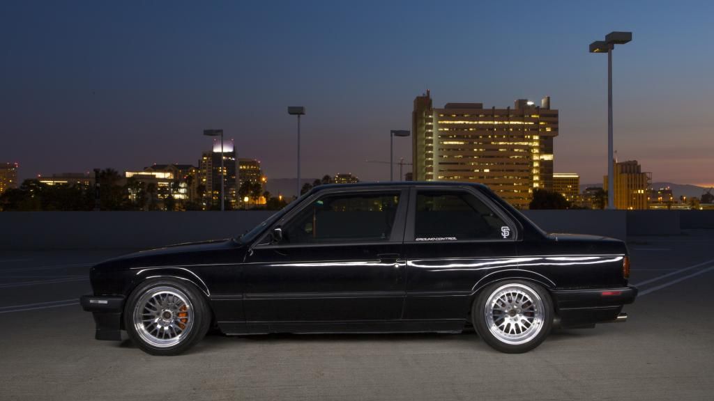

    A friend, Eric also took some pics of my car...with my new wheels...very happy with his pics and the way the wheels fit compared to the RX's although I will miss them too. But I got that STIGGEDY STAGGERED STANCE now BrO lol.
    Less talk, more pics right??
    Bling Bling
    309k and counting...

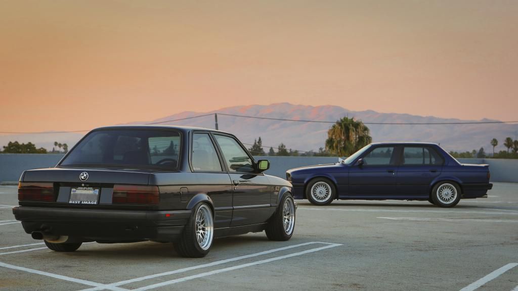

    you may recognize the 2014 e30 (blue 4 door) haha...damn near everything rebuilt/replaced on that car...its sooo nice and smooth and quiet.

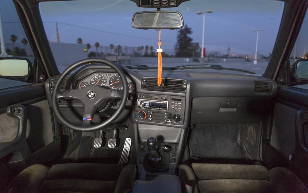

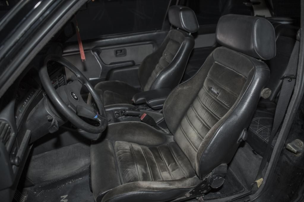

    and interior shots ive been dying to have.

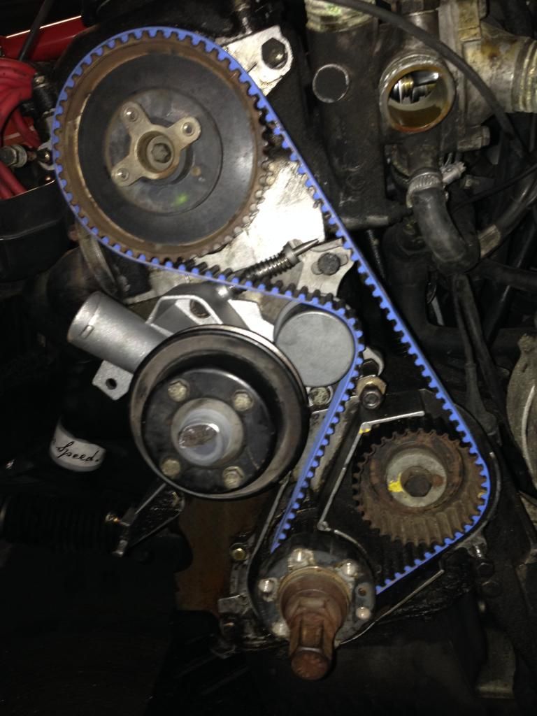

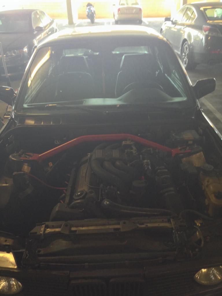

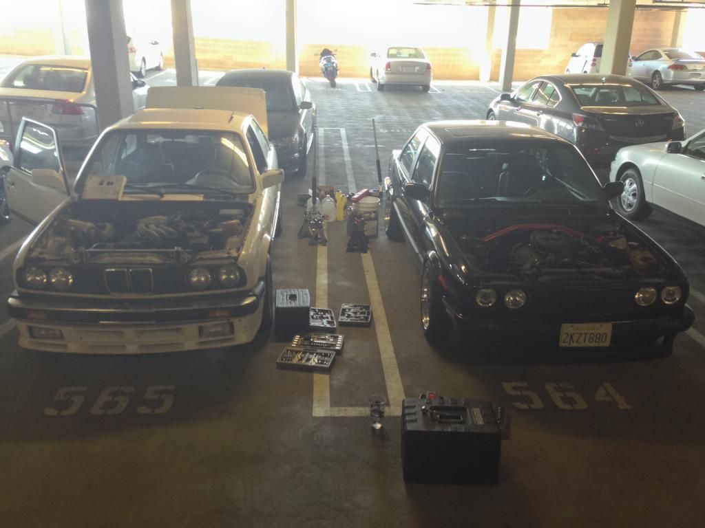

    Went to a buddies house to finally do the waterpump/timing belt I have been putting off for the last 10k miles. Figured 70ishk was about time...
    It was his first time with it so he was eager to start, after completion he says he will never do it again haha.
    I love the way it looks with no hood :)
    That Bar.
    Everything out...Oh How I'd love to stuff an intercooler and turbo in there...look at all that room!
    But because stupid CA laws, must wait until built m20 goes into 2002.
    And that +10 hp ultimate fuuulll racccceeee racing timing belt.
    I managed to strip both my alternator and ps tensioner star wheel things. so Steve @ BluntTech is gonna be sending me those soon. Got my alt belt tensioned by hand then set, but couldnt do it with PS. So no ps for a while. lol...its not the first time i havent had ps before.

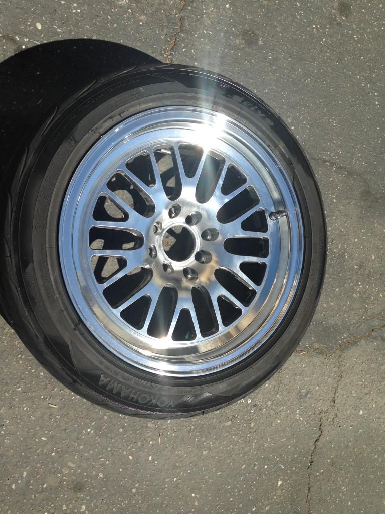

    They're 16x8 et 20. They're actually 3.5 lbs lighter than the Rx's which were 16x7
    I'm gonna be trading two wheels to my friend who has these in 16x9, so gonna be staggered. And the stripper works great!

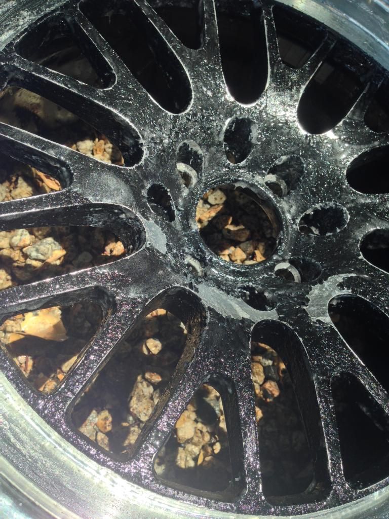

    Today I am going to pick up some aircraft stripper..I'm going to strip the black and clear on the lips and fully polish the new wheels
