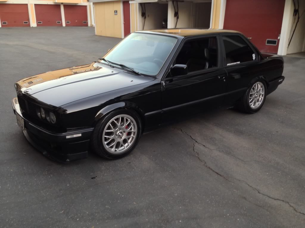

also, my BBS RX's with fairly new 205/50s. Worth much? Theyre 16x7 et35. I wanna run atleast a 225 up front and i'd like more in rear, so I need new wheels. I have my eyes on a 16x9 set but have no money to buy em, unless these RX's can get some $. Ive realized I dont see them too often. I know theyre NLA. But what are they worth? So I guess I'm testing waters?Leave a comment:

I wish I had more pics those wheels were the ccw classics replicas. They're a friends, just tried them on to test offsets. I'd say its safe to say a 16x9 et25 fits with a 225/45 with no spacer on back with lots of room. The pics have a 10mm spacer with still enuf room
For no rubbing. Or maybe no spacer + more tire!

I also tried on my friends wheels (16x9 et25) with a 225/45. I found a 10 mm spacer makes a 225 sit PERFECT in my rolled fenders. What you think? I've decided on the wheels I'm gonna get. Just gotta figure out if they'll fit the front...I'll tell ya this. I want 16x9 square.
