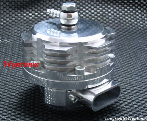

      Oh its running now. Took it to the adams kart track meet and raped it around the track. I torqued it to 65ft lbs. I'm going to re torque it to 70 and bump it up to 14psi on friday along with installing a 51mm wastegate. Got one of these bad boys but i think the spring is too strong. I'm going to put in a weaker spring off a bosch diverter valve and hopefully that will give me the instant response and get rid of my compressor surge. Either that or i'll cut off some of the existing spring so its not under so much compression.

            So today i decided to delve into my compressor surge issue. At first i was just going to install the new blow off valve but decided that was only going to be a bandaid or possibly no change. So the first thing i did was take apart the original BOV and made sure everything was working in order. The BOV had an inner and an outer spring so i removed the inner spring and re installed it. No luck. So removed the vacuum line and held it up to my lip. Almost no suction so i needed to relocate the T. I disconnected wastegate line and plugged it in to the BOV and success. But it was so strong that it barely took any pressure to open the it. So I cut the inner spring in half and reinstalled it and T'd off the wastegate line. Compressor surge like crazy. So i removed the spring. Still surging but not as bad. So i took it apart again and put it together in case i did not seal it correctly. Still surge. Pinched the wastegate line and success. So i guess the wastegate line is too long and uses up a lot of the energy and delays the BOV. So i'm going to have to tap the manifold for a new source.

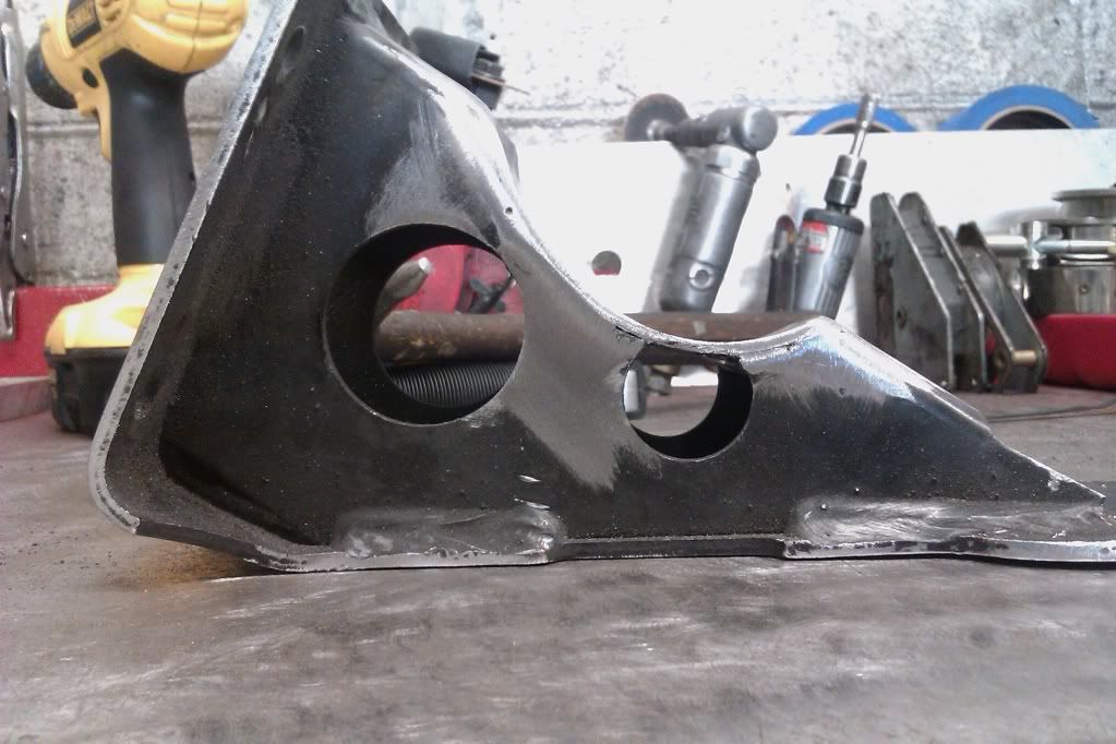

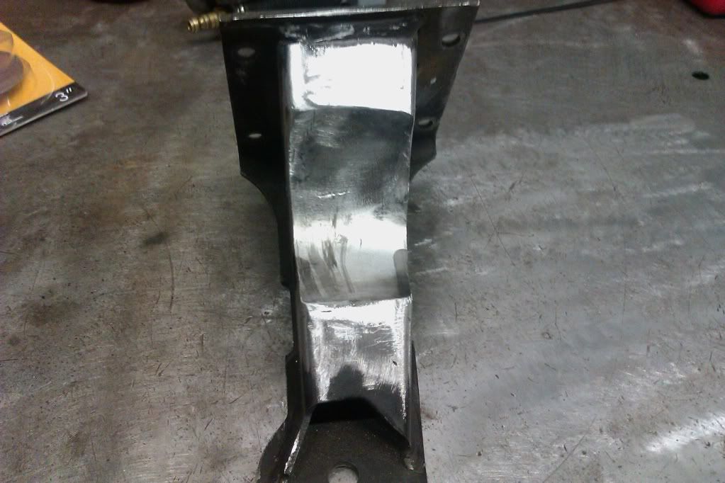

                                Got started on the motor mount. I only needed about a quarter incho of additional clearance but I decided to make sure I had room to upgrade.
