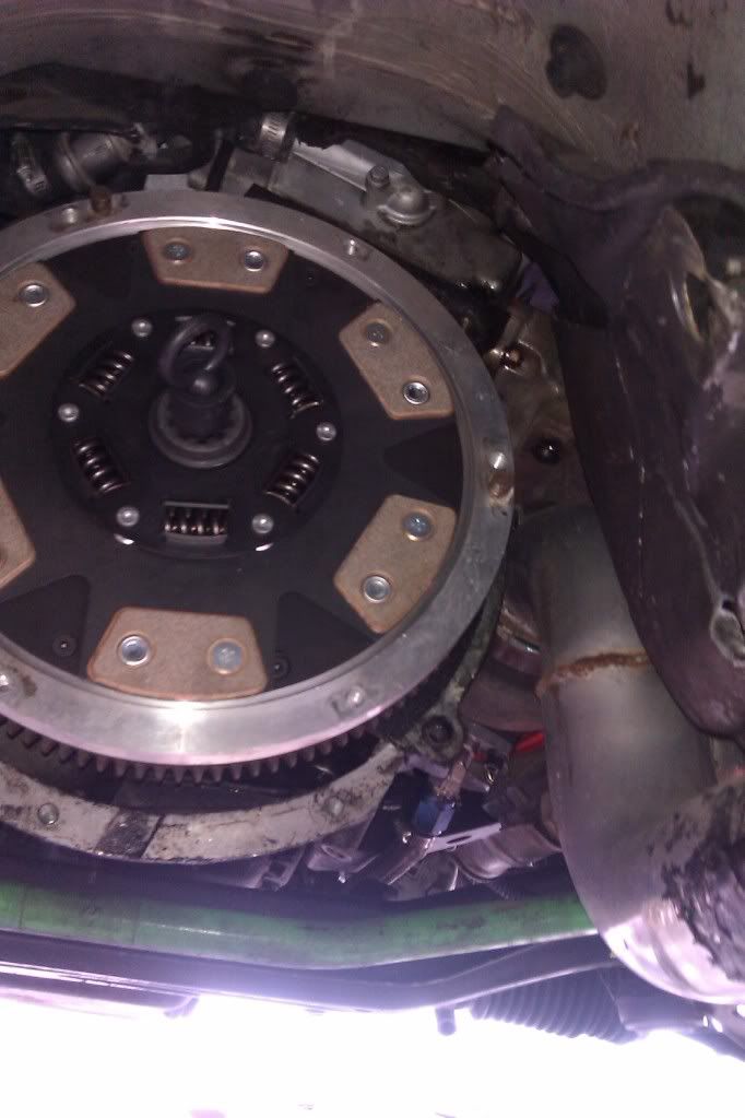

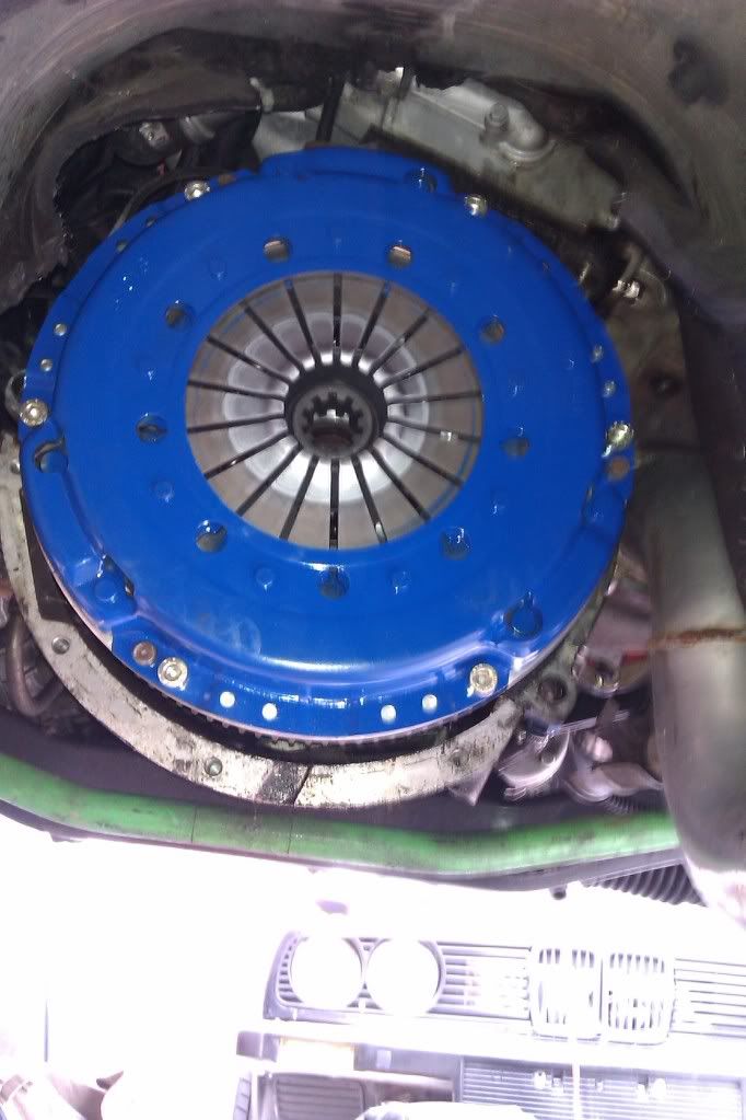

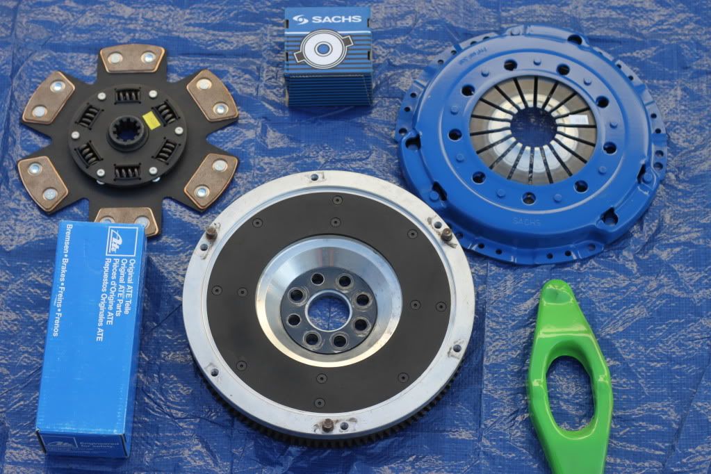

    I have not updated this thread i forever. Have not really touched the car since it was rear ended. Well i've been hoarding parts and i had the quarter panel repaired so i hope to have the car better then ever by this summer. Before i build a new motor i need to address some issues. The biggest of which are the ecu and clutch. I sold my ecu to ocgrinder after the car was hit. I have a new ms2 system that i built but it needs some finishing touches. I'm pretty swamped with work and school so whodwho is going to give me a hand with that. The clutch started slipping long ago and i've been slowly building up my parts stash to do an s52. Castro Motorsports has hooked me up with a starter and light weight flywheel. I took it down to AASCO and they put a new surface on it. I'll be running it with a grip force stage 3 sprung 6 puck disc and pressure plate.

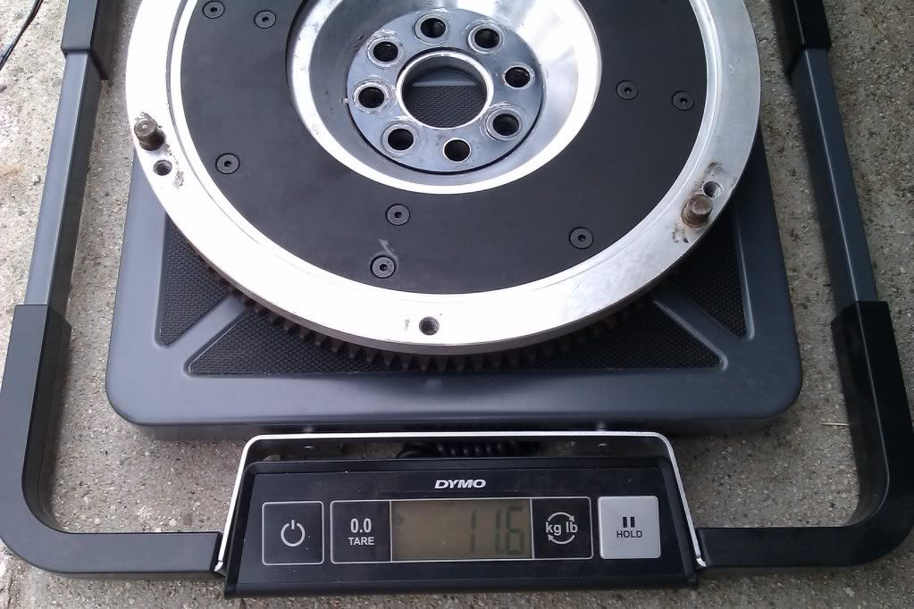

                                Got the clutch and transmission installed today. Also weighed the flywheel for shits and giggles.
                                Sorry for the crappy cell pics.
