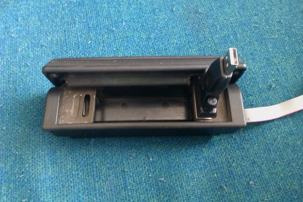

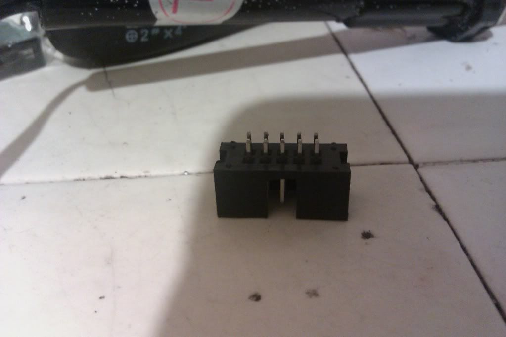

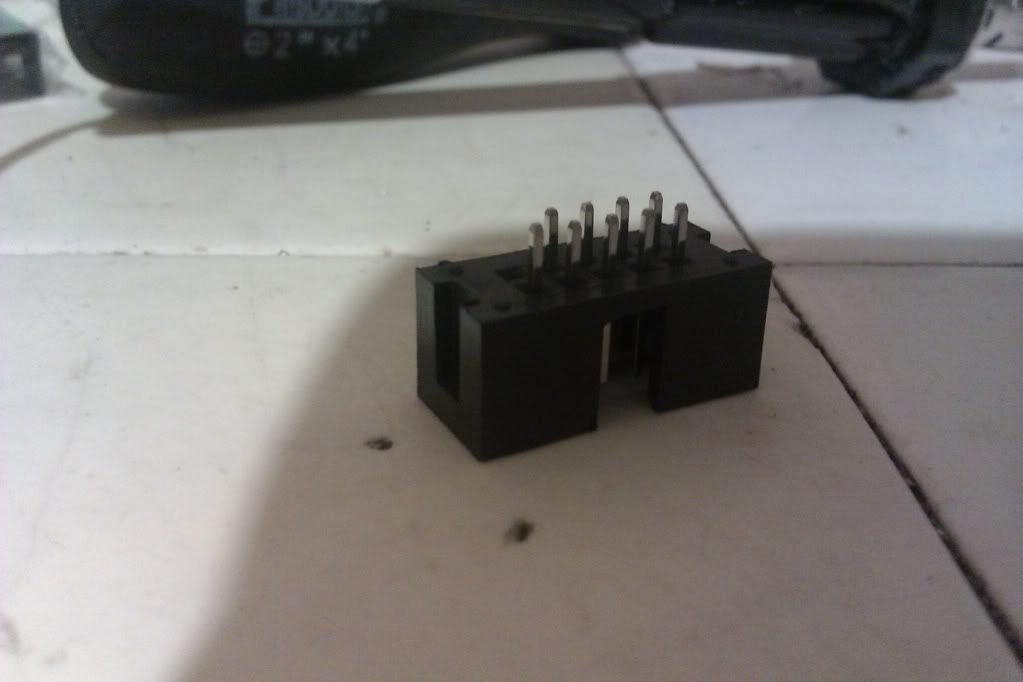

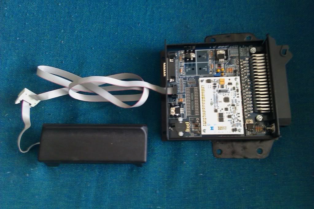

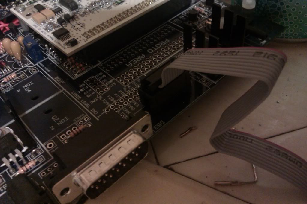

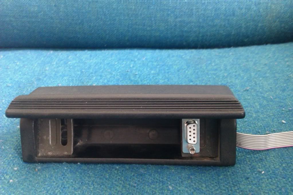

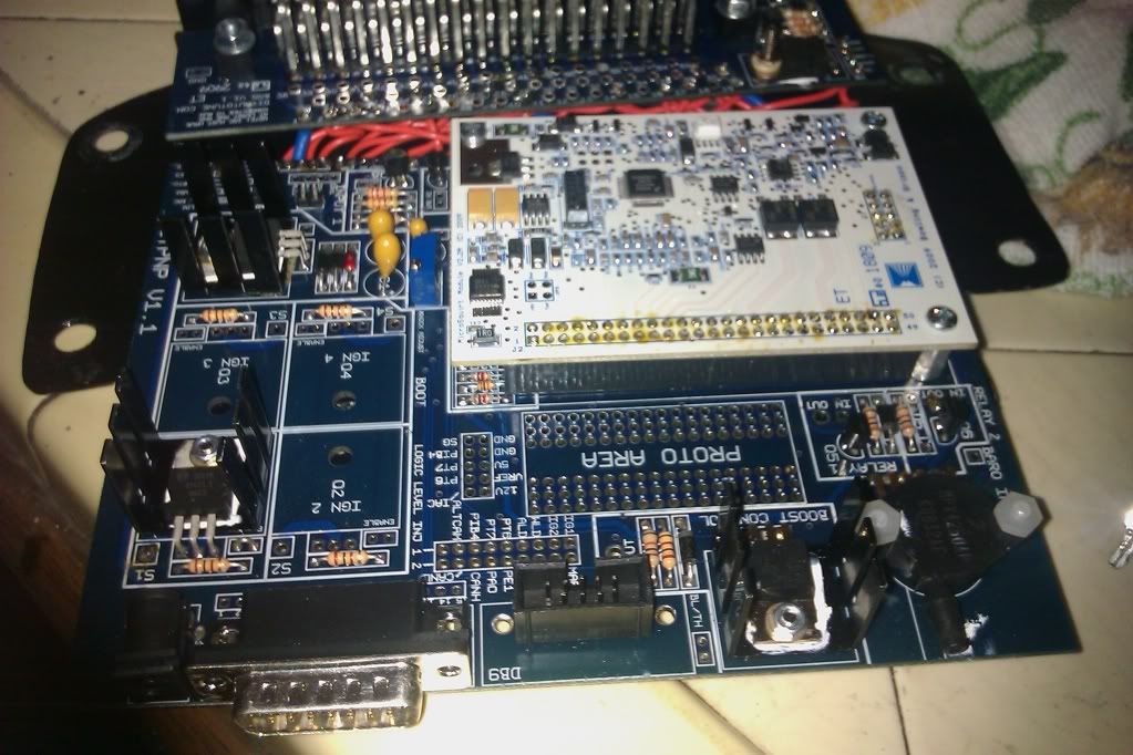

                So i got tired of having to have my EMS dangle un mounted in order to do any tuning so i decided to do something about it. After coming up with many elegant and simple solutions i decided to do the most elaborate and expensive way possible. lol. Excuse the crap photos and work station. My desk was taken over by a six year old.
                So the first thing you have to do to modify an existing completed MS unit is to de solder the db9 plug. I fount the easiest way was to pop off the back and heat up and pull each pin one by one.
                Next was to modify a idc 10 plug to work on the board. I removed the # 10 pin and bent the remaining pins to fit. Pins 1-5 need to be spead apart and 6-9 need to cocked over. (no homo)
                Then i soldered in place and test fitted idc to db9 cable. Now i could have stopped there but that would have been to easy. So i decided to make an extension cable so it could be remote mounted anywhere in the car. Almost everything used had to be purchased in bulk so i have enough to make 9 more kits if anyone is interested.

                  ^ very good work. i like that idea of the ashtray plug and play.

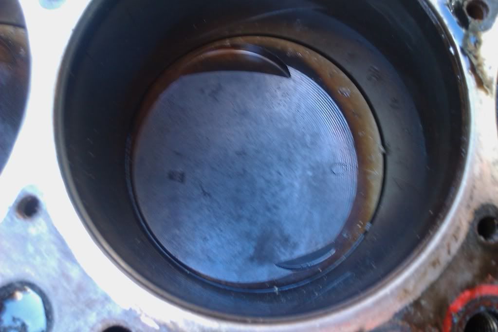

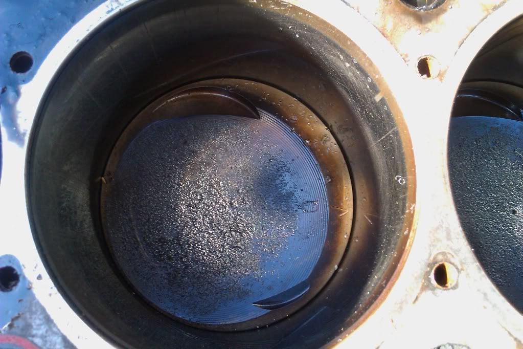

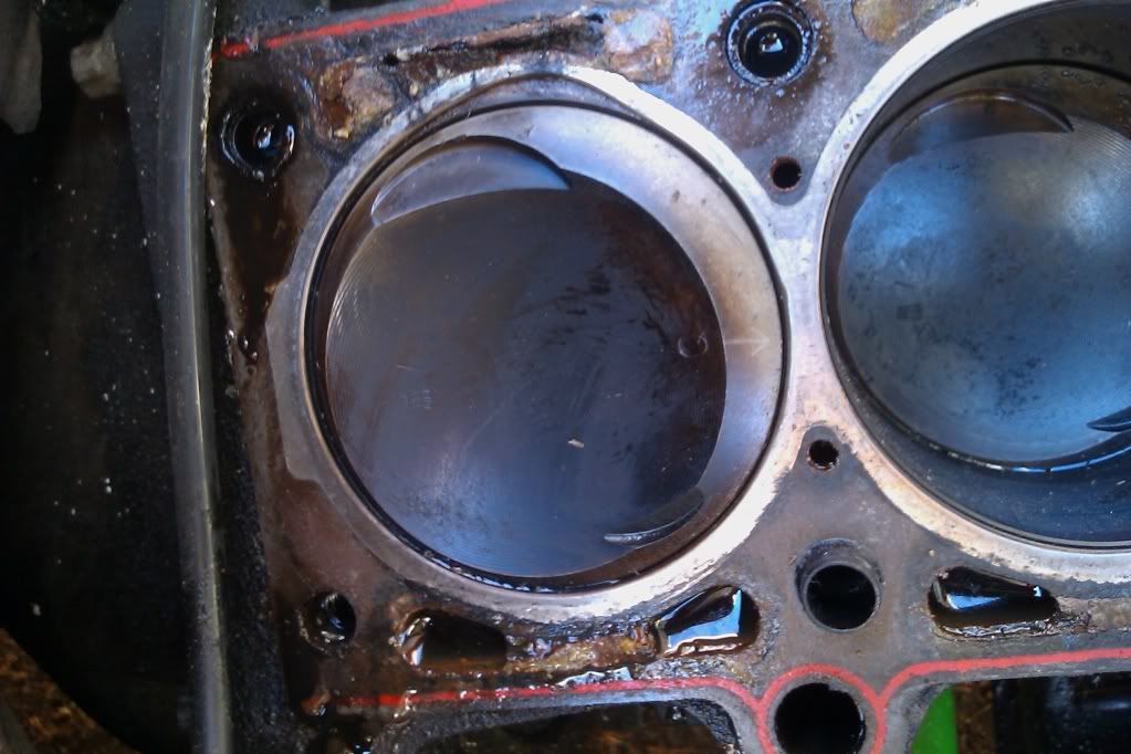

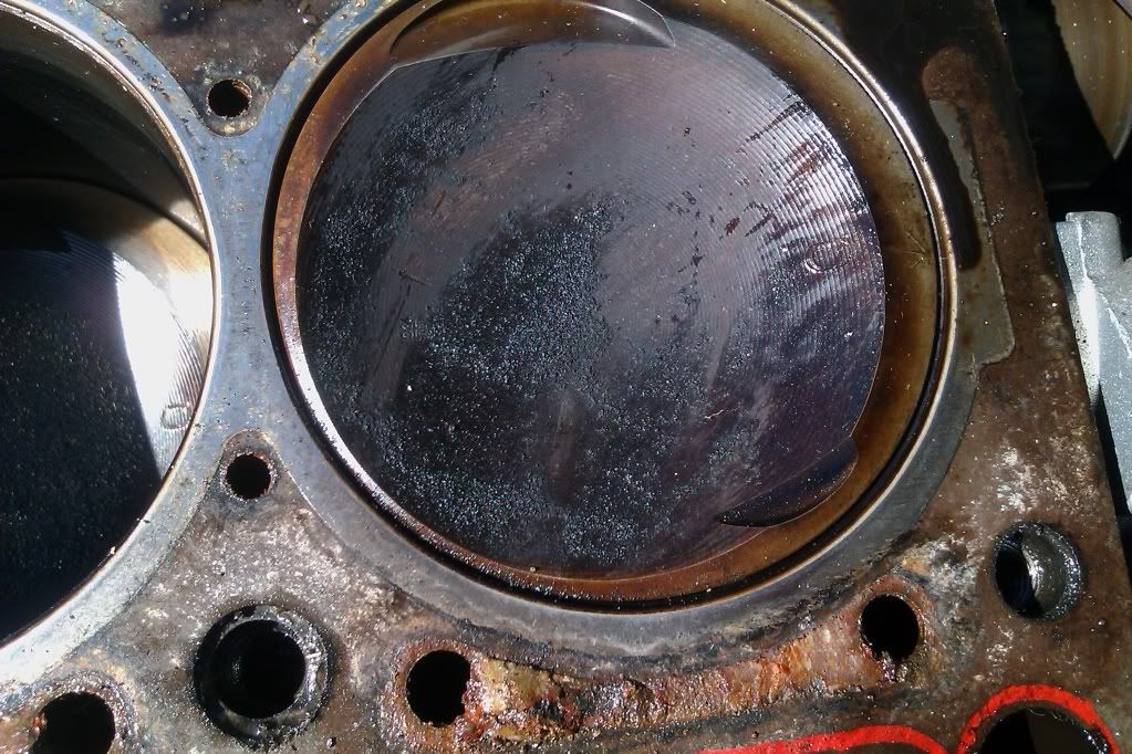

                    If you ever wonder why people say "use this tune at your own risk." Needless to say CA has crap gas and we need our own special tune. Unfortunately the moment i changed my timing maps to IXERS map my computer took a dump. So the two weeks i drove around waiting for new parts and software created irreparable damage which led to a blown head gasket once i did correct the tune.
                    Took everything out at once. Seemed like a good idea until i picked it up off the block. Lol. But it was to late to set it down and risk causing further damage
                    New parts
                    I had the head rebuilt and its back on the car. Did not take any pics cause i was trying to beat the rain.
