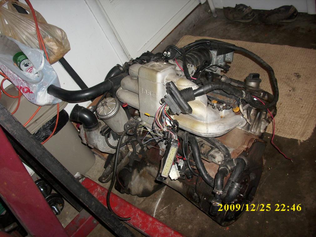

    Another M30B35 swap

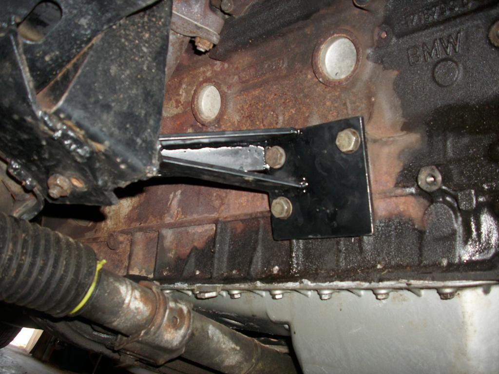

    Just thought Id post of few pics of the swap. This car belongs to a member on here, graveshaker, and it already has a b34 in place. However the motor was overheated badly and head warped. Some custom mounts are already in place so should be a somewhat straight forward swap. Ill be posting a few pics here and there.

    You're going to need a different passenger side mount. B35's have different mounting bosses on the engine side. Koala motorsports makes an adapter plate that would work though.
      or
      I've heard that just the passenger mount is different, and then I've heard that both mounts are different.
      Originally posted by Good & Tight
      Both side are different on the B34 compared to the B35.

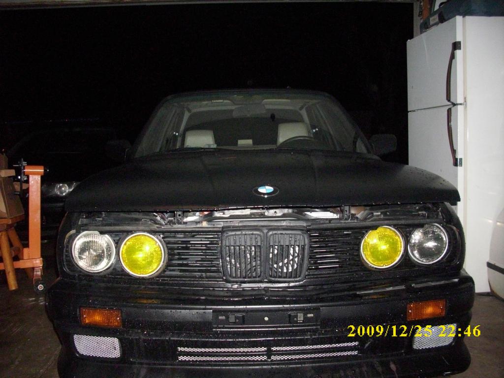

                  Old blown b34
                  Superior big brother b35
                  Patiently awaiting transplant

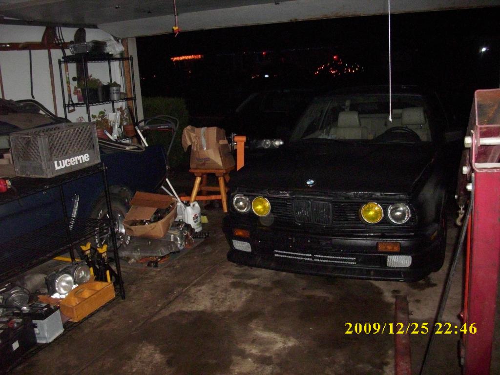

                  A few after satin paint to start the rat race theme.
                  Once swap is done safety equipment will be installed.

                    I love the satin paint.... however it would have been nice if you finished all the bodywork before hand... and give the car some contrast...i.e. some chrome..
                      This car will solely be a track rat so I'm not too concerned with looks right now. My focus is more on safety items as this car will be tracked by my son and I. I do have two other BMW's that I style around in however;).

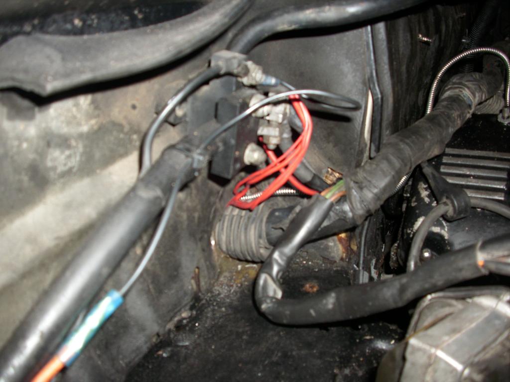

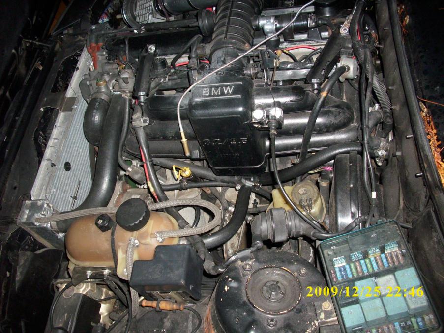

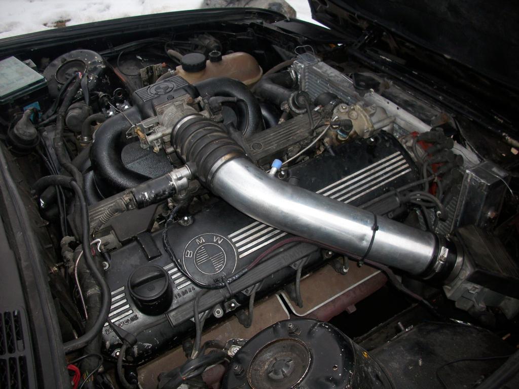

                        Project finished! first B35 swap I have done, and along with the 3.46 LSD,
                        very quick, as Im sure the owner can attest to, anyone else need a 3.5 swap!
                        pics up soon
                        • theuberness
                          • Dec 2009
                          • 18
                          here are a few pics
