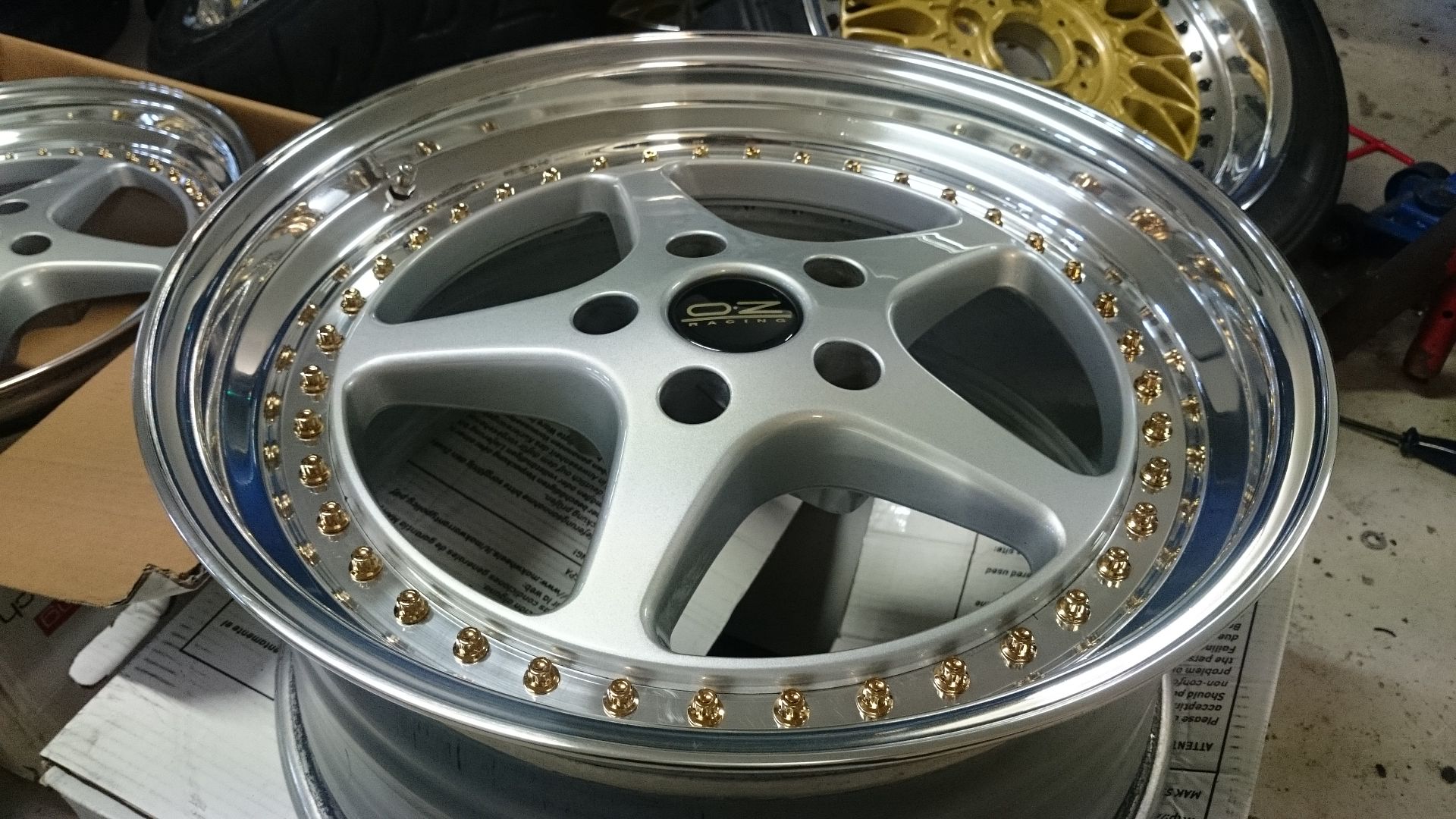

              Adding some wheel porn as well. Deivered the OZ's to the new owner couple of weeks ago. He was very happy with what he got, and I can't deny that I was very happy with how they turned out after the repolish.

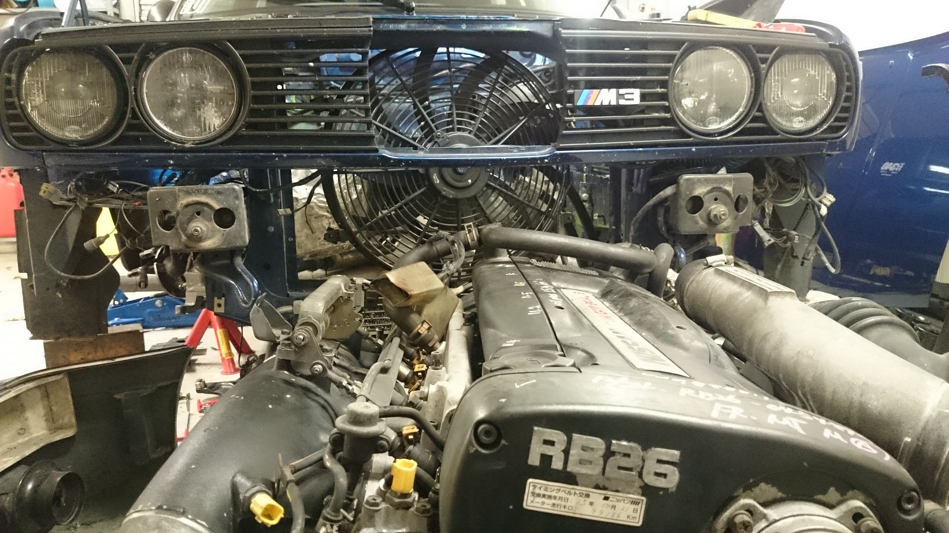

                  Got some work done today. Trying to get a overview of the project. I'm at this point seeing single turbo as an option, thought I would not like it.
                  So, I just hoisted it into the car to have a look at what I have to work with. First thing was that the exhaust from the rear turbo did hit the firewall.

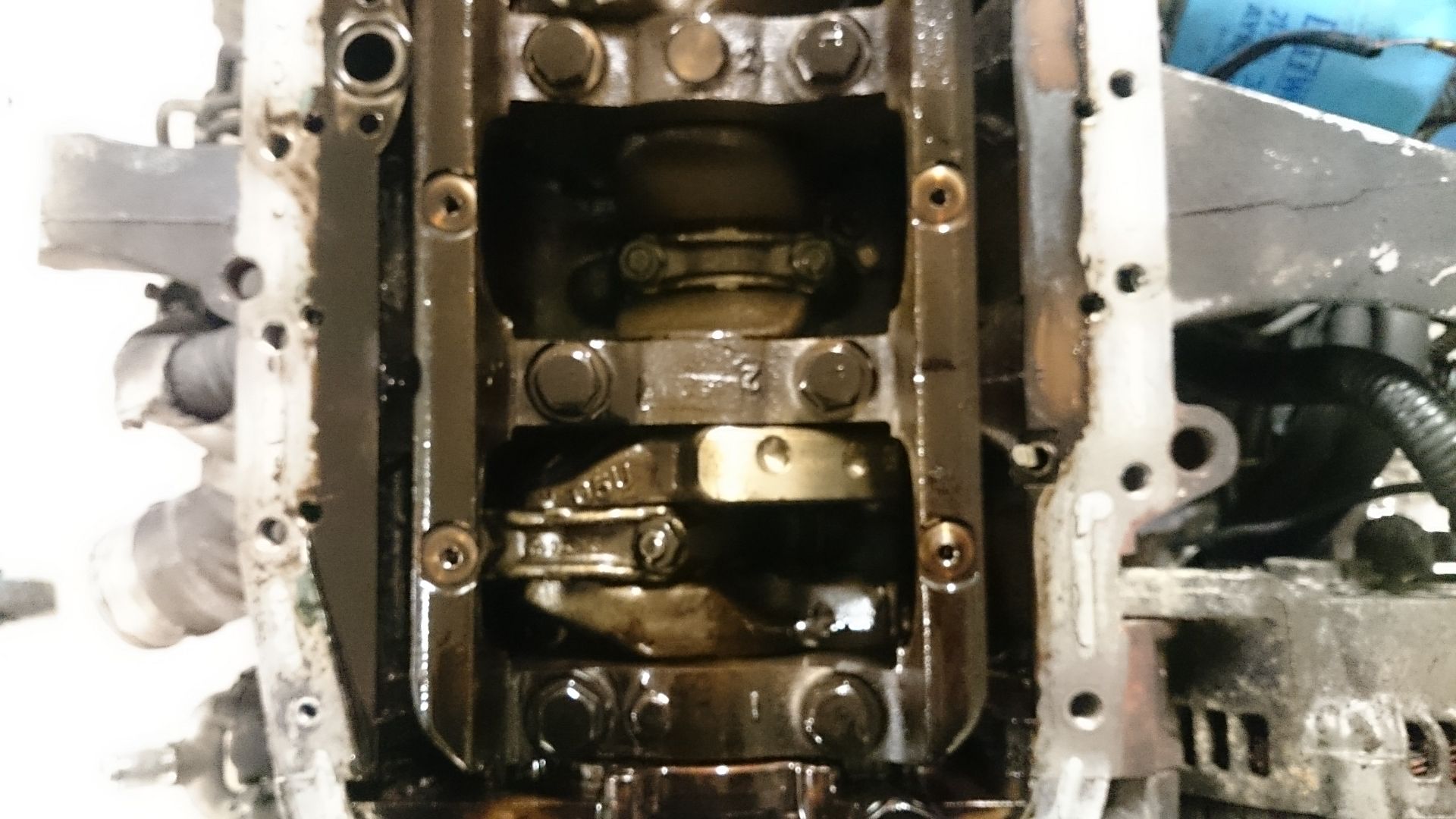

                  I removed the dumps from the rear turbo and hoisted it in again. At this point the front differential was stopping to get the engine into posistion, so that have to me removed from the oilpan before I can go on in posisioning the engine.
                  Removed the oilpan/diff and removed the diff itself from the housing.
                  I like that it have these braces between the bearing caps, I can't remember what it is called. It also have piston squirters.
