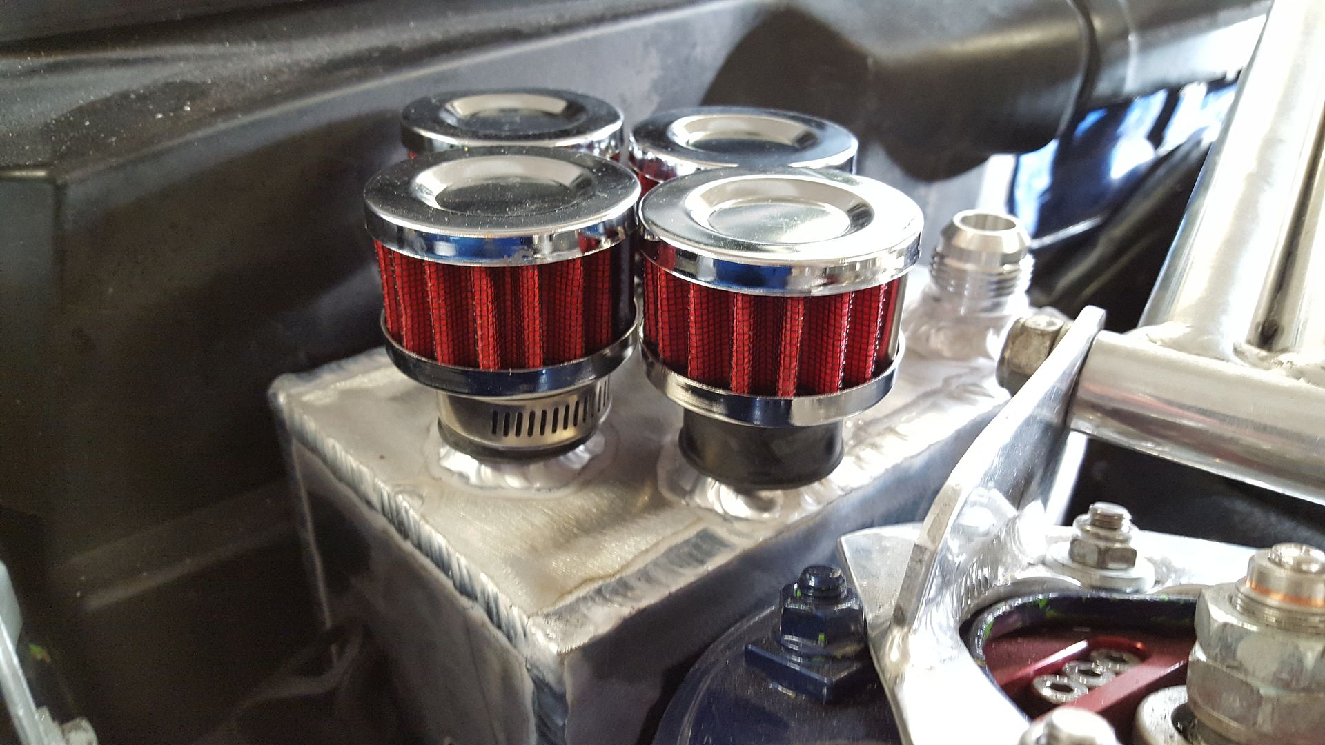

                  I got some things done with the car this weekend. Not that everything can be seen on photos. I removed the engine to put on the remaining parts in the oilpan. And sealed it for this time.
                  As usual, I start off with a coffee break!
                  The air filter I will be using.
                  And the filters for the catch can
                  Got some silicone radiator hoses for R32GTR, but I do not think they will fit.
                  Oil drain for the back of the cylinderhead arrived
                  And some fittings. AN10 and AN12.
                  Fitted the head drain
                  Welded myself an AN10 for crankcase ventilation where the drain for the rear turbo was before.
                  Got the ATI Superdamper torqued to spec and the waterpump pulley. As well as the complete TBS and intake bolted up with gaskets.
                  Flywheel and clutch mounted.
                  And that leves this for the next time I'm traveling to work on the car.

                      Some of the mushroom filters are known to suck in som small screws used to attach the filter to the base.
                      Worth checking out!
