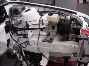

                              thanks for the write up-i'll be using this as a basis on my euro s50 swap:)
                              quick ?....how will you be using the e34m5 booster dual chamber booster? are you going to mount it remotely like on the e34 540 or 740i?
                              i'll be doing the said mod...my swap will consist of the remote 740i booster/mc using the brackets from the same car-it should look like this(akg website pic):
                              • Mr. Horsepower
                                • 386
                                #45
                                I will post pictures of the booster when it's mounted. It will be mounted on the fire wall, using the joint from the stock booster. I will then have to cut a little bit of the intake plenum an weld. I have not decided if I'm going to remote the reservoir or not yet. Have to see how much it does build and how the access will be.
                                If you place the booster in the 540 place, I think air filter will be an issue or it will be a tight fit.
