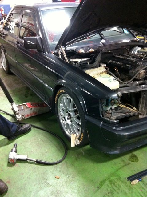

              I've had a very difficult time finding a wheel and tire package that does what I need it to do for this project. The W201 chassis has tiny wheel wells to start with, and things have gotten even tighter after swapping in the coilovers. Since we're building the car for vintage racing, we can't just cut out the fenders to make room. On top of that, I'm running the Evo II Brembos, which adds yet another dimensional constraint to the picture.
              After trying out a whole bunch of different wheel/tire combos and spending literally thousands on wheels that didn't quite work, we've finally found a combo that looks promising:
              These are 2-piece BBS RX II 503 alloys in 17x8" ET35. They're a bit heavier than I would have liked, but at least they fit properly. The tires are 225/45-R17 Continental Challenge semi-slicks, which are rebadged Hoosier endurance racing tires (basically R5's with a harder rubber compound). They should hold up well for HPDE and amateur racing.

                Nice work - those rims with the raised yellow letter tires are cool!
                  I 2nd that!!! #SAPPHIRE
