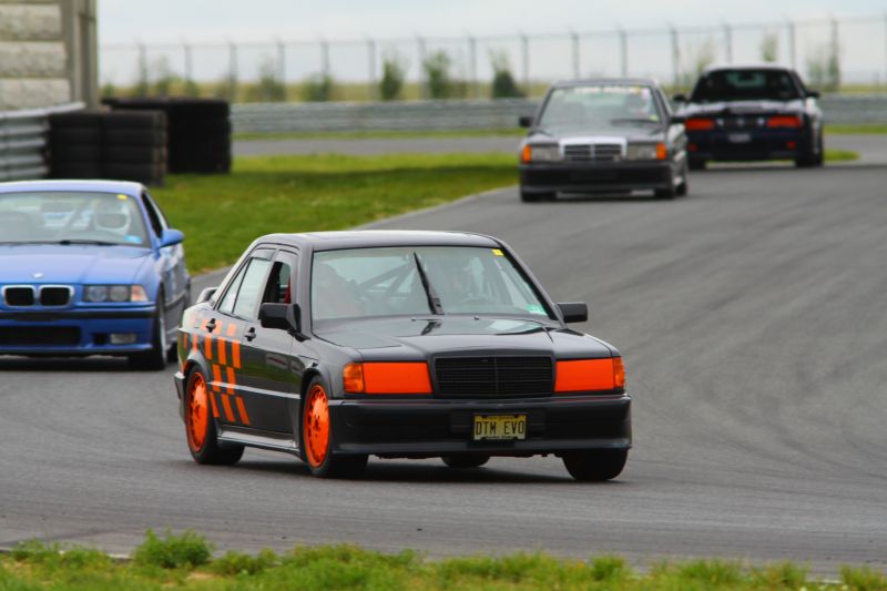

        Just had the wheels refinished in GT3 orange and added some cheesy graphics. These were taken this past Sunday at GFest '12:
        My ridiculous vanity plate:
        Today, I had the car on the track (NJMP--Lightning) with the NY BMW CCA. The car is FINALLY running right! We were able to pass most of the early M3's (E30 and E36) running in the instructor group...except for one guy with an insanely fast E30 M3 2.5L stroker. Not bad, considering I've got a bone stock (165 hp) engine under the hood. With twice the HP and 25% more rubber on the ground, the race-prepped E46 M3's were out of reach.
        Found a fellow lunatic to play with:
        Dicing with the Bimmers:
        Look, ma ... no body roll!
        Well, that's it for now. After two years of work, things have finally started coming together on this project. The suspension and tires are working beautifully. The engine is strong. The car feels great!

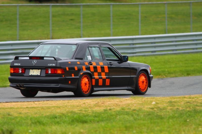

            I had the car up at Tremblant last weekend with the BMW Club of Quebec. It was Canadian Grand Prix weekend, so attendance was pretty light and everyone had plenty of track time. The weather was gorgeous: sunny, dry, and not too hot.
            Anyway, here's the 16v in action at my favorite track:
            You'll notice in some shots it looks like the car is smoking a bit. That's because I hadn't seated the dipstick properly and some oil was splashing onto the headers in left-hand corners. Unfortunately, that session was the one where the track photographer took the coolest pics!
            Also, in a few of the pics it looks like the car is squatting hard under acceleration and rolling quite a bit. It's funny, but it feels good from the driver's seat, so I was pretty surprised when I saw the pics. I'll have to check in with the guys from Ground Control to see what they think. May need to reconsider my spring rates.
            All in all, it was a great weekend. I drove 450 miles to the track, did 7 or 8 hard sessions on the track over the course of 2 days, then drove the 450 miles back home. The car ran like a top, despite the oil leak for that one session (totally my fault).

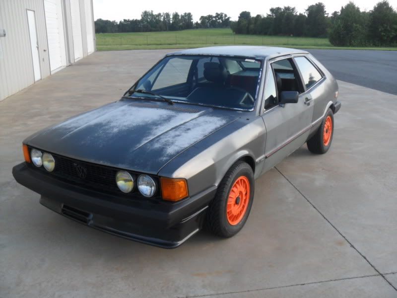

                Hey I did the same thing with the wheels on my Scirocco (Porsche GT3 Orange):
