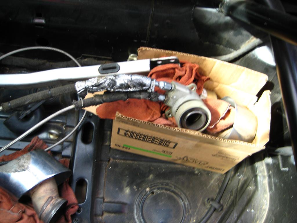

          Look, the car wasn't drivable without working brakes or a clutch. This car - like many others - has a hydraulic throw out bearing / slave cylinder combo. Which... Has fluid and had to be bled. It's called a hydraulic TOB in many circles. :)
          Before I left for the Solo Nationals we finally got a working brake MC and replacement caliper bled and working. TOB/Slave is still giving us grief but was halfway working.

            Yep, hydraulic throw out bearings are a pain in the butt to bleed. My race car has a Sachs one on it (car has a 997 GT3 Cup 5.5" triple plate clutch) and it took forever. Fantastic build (as is everything you guys do) and I look froward to seeing some videos when it is completed.

                    Some of the hydraulic failures could have been avoided by NOT using used hydraulic parts. Lesson learned. This insanely low budget has led us to make mistakes in judgment. Sometimes there's a fine line separating "cheap" and "stupid".
