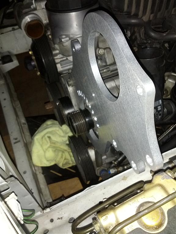

      Test fitting the bracket in the car and it clears the ABS pump just fine.

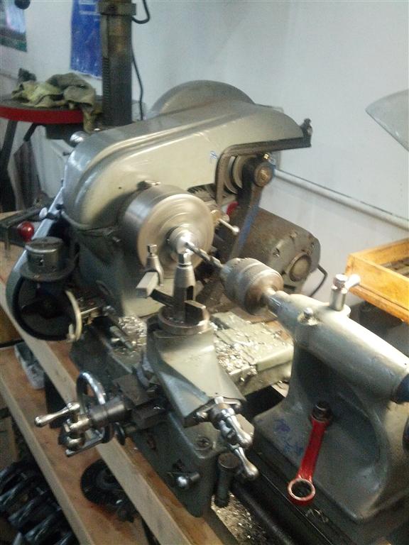

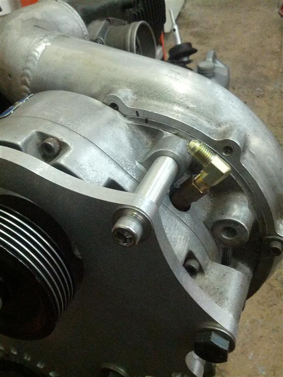

      I then took the bracket and supercharger over to Accuracy Automotive, JParkr's & James Criv's shop and used his spare S50 to mock everything up on. I had to make a spacer that goes between the bracket and the lower alternator bolt.
      spacer goes here
      Then I made the spacer fur the longer 3/8" bolt that goes between the bracket and the supercharger.
      All bolted up to the mock up S50, now I am just waiting for materials to come it to make the intake pipes and the idler pulleys so I can figure out the belt size.

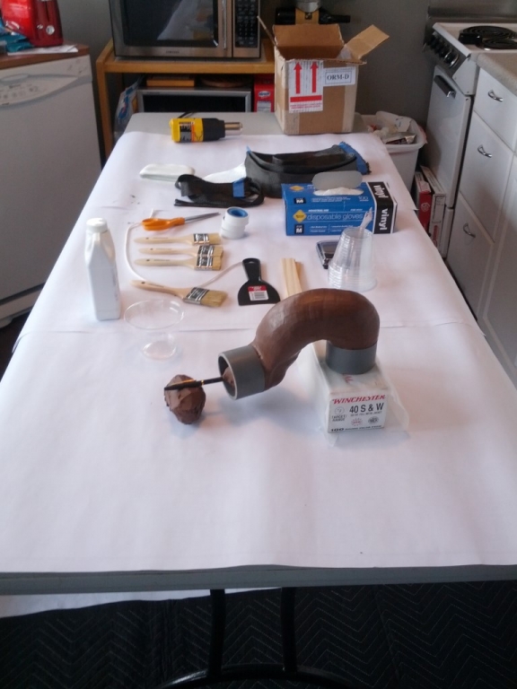

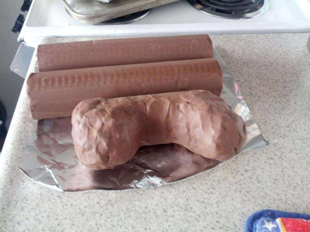

              Update: Making charge pipe

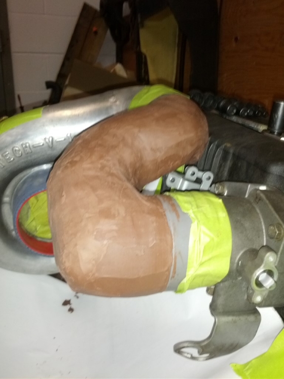

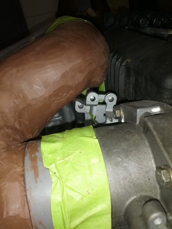

              I had to make an intake that would go from the supercharger to the throttle body. It has some tight bends in it and has to clear part of the throttle linkage. I decided to make the intake out of composites. I got some Chavant Y2-Klay automotive modeling clay to use to make the intake in the shape I needed it.

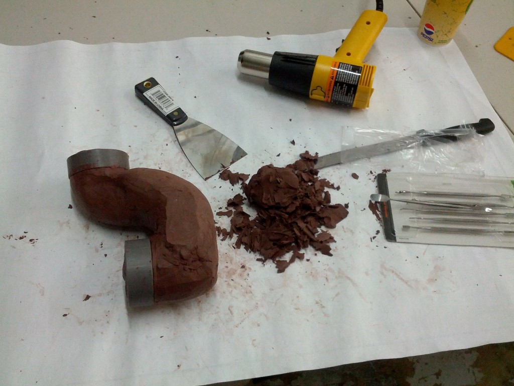

              I got 3 (only used 2) sticks of clay the two in the back are how they come and then the front is the beginning of shaping it, you have to heat the clay to work with it.
              Got the rough shape done, you can see the tight bends and the linkage it has to clear.
              Smoothing out some more and some of the tools I used
              I then got all the supplies set up
              Brushed a few coats of PVA mold release on
              Let that dry and started cutting some carbon fiber pieces
              First layer laid down, I used some biaxial carbon sleeve and ended up having to cut it into sections because the bends were to tight.
              After a few more layers and letting the epoxy cure I then had to remove all the clay from inside the part. Not fun at all.
              The hole will be for the diverter valve and the idle control valve, just need to bond an aluminum bung into it, and it still needs a little more sanding.
                              How did you go about removing the material? Did you find a way that was fairly efficient? I'm assuming you had to be careful with the heat gun.
                                Nothing really efficient as I didn't want to use any chemicals that might damage the epoxy. I just used a spoon for as far as I could with little heat and then just used my fingernails to scrape the rest out. If I used high temps epoxy I could of just left it in the oven and let the clay melt out.
