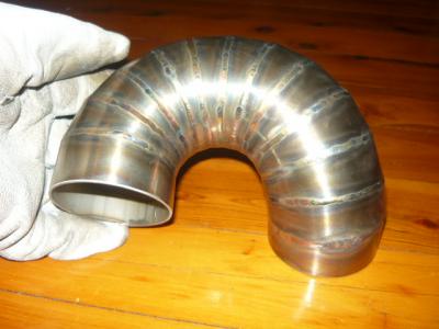

    You should talk to my buddy at speedfactory, He could tig up something wild. Also he could cut back the supercharger neck and rework that as well. You will have to take me for a ride when its done!
    Another wild idea would be spinning that thing around and mounting it on the passenger side then have the outlet go to an intercooler then the intake.

      ^ Zeke are you referring to something like this:
      If so would be awesome as well.

          Here is an even tighter one. The pie cut method can get some super tight radii.
            Did you make that? Props on the welding if you did!

              No, I googled it.

                I LOVE tig welding, can't wait to get to that part of my build.

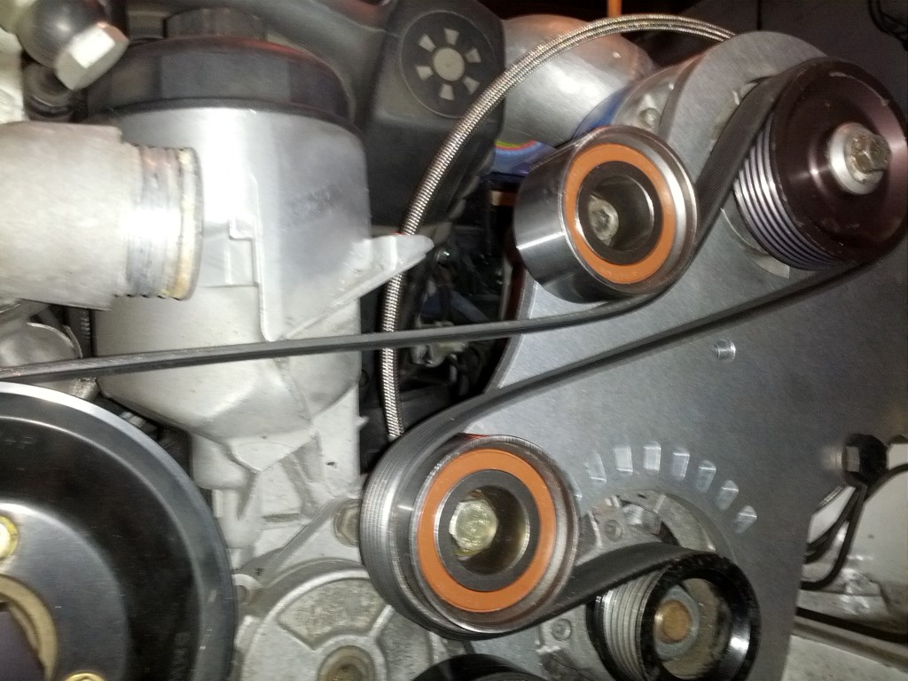

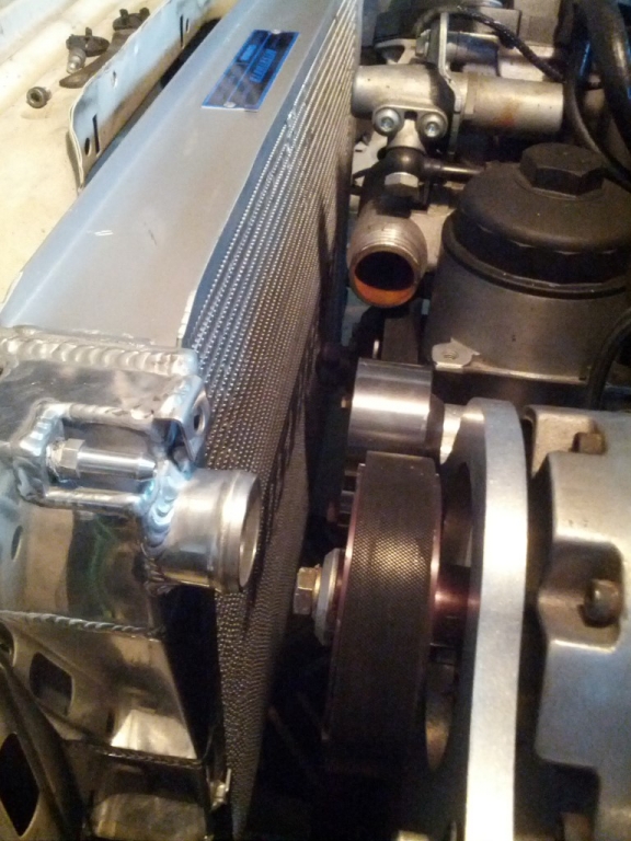

                        A few pics of the supercharger bolted up, right now I'm just waiting for more parts.
                        Have to modify the radiator a little, I new it would be tight with the Z3 s54 radiator. I will probably use a different bolt and washer for the supercharger pulley that will give me a little more room.
                        Belt layout, this is with the old belt it's not around the crank. I used some sting to get an approximate measurement and picked up a belt at the local auto parts store. The belt I got is a little long (6pk2237) so I will be exchanging it for a shorter belt.

                            what idlers are those?

                              What fan are you using with that radiator?
                                Electric pusher fan, I think it is this one:
