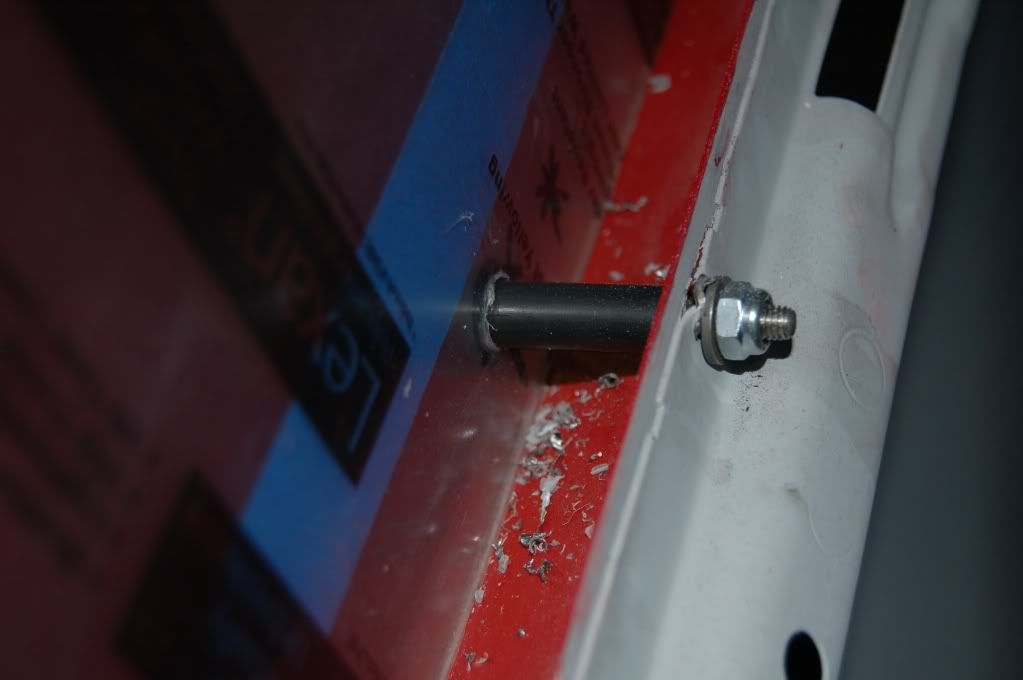

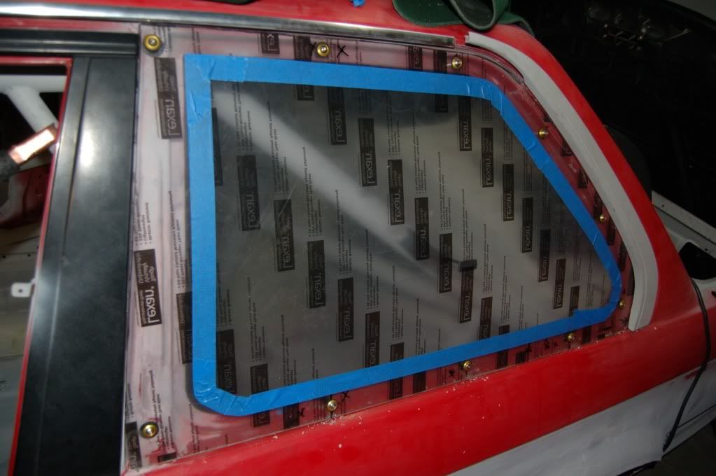

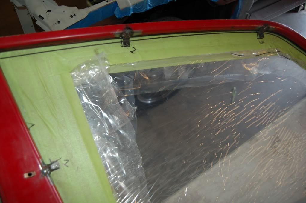

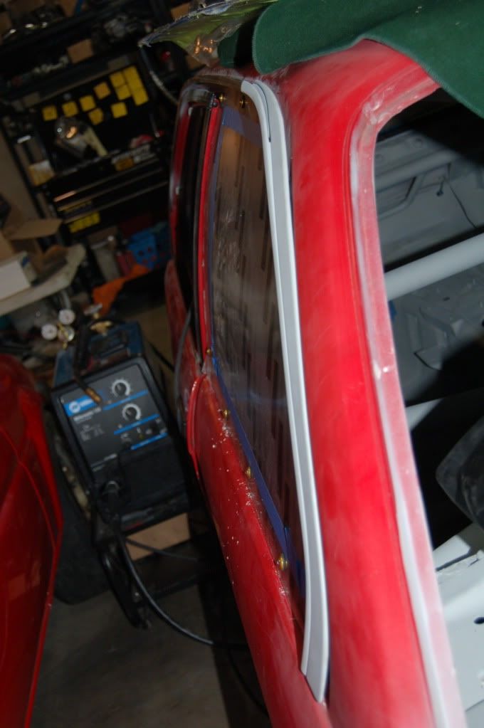

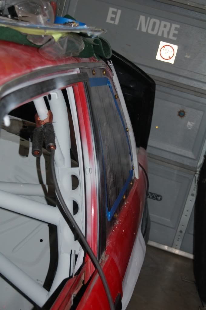

      I finished cutting and mounting the rear quarter lexan today. The tape is where I will be painting a black border.
      Made some spacers out of some carbon fiber tubing along the bottom to space it out.

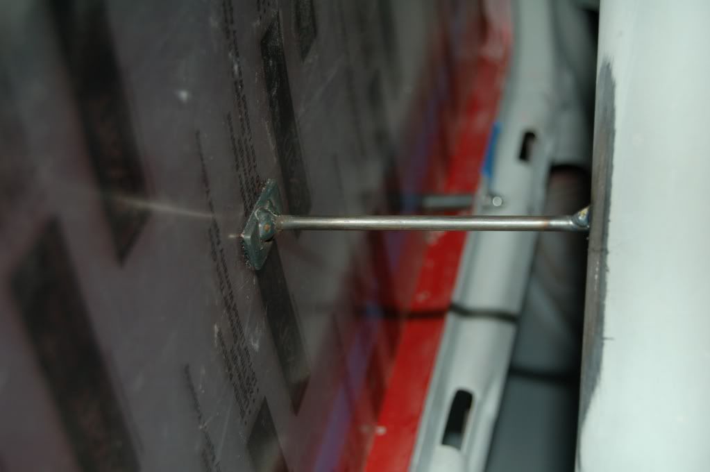

      The windows sagged inward once mounted and looked like crap, so I made these small mounts and welded them to the cage to push the windows out. I backed them up with the fuzzy side of some sticky velcro so they wont scratch the lexan.
      They look ok now.

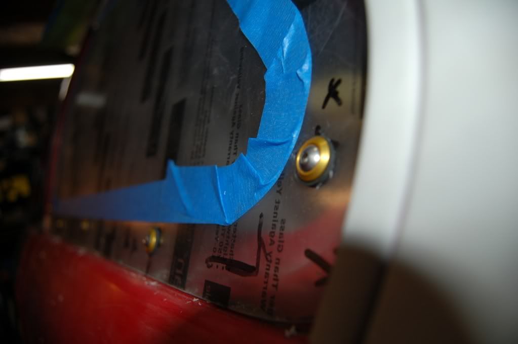

      Nice aluminum finishing washers with a rubber washer behind it.

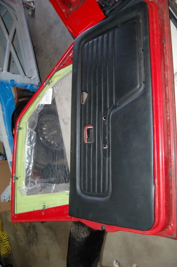

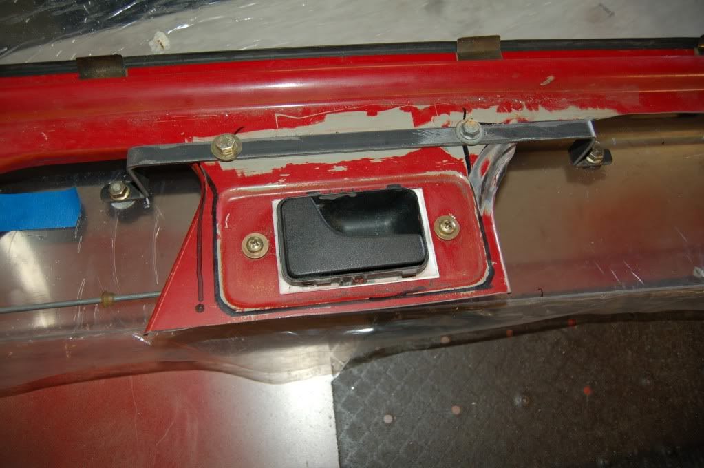

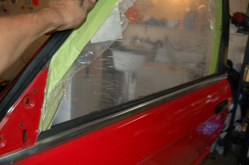

      I did the door lexan last week.
      All the trim fits!
      Welded some tabs to hold the upper part in place during an accident. The window fits in the oem trim great, but I was not confident in just my lower mount holding in a rough crash.
      The lower mount

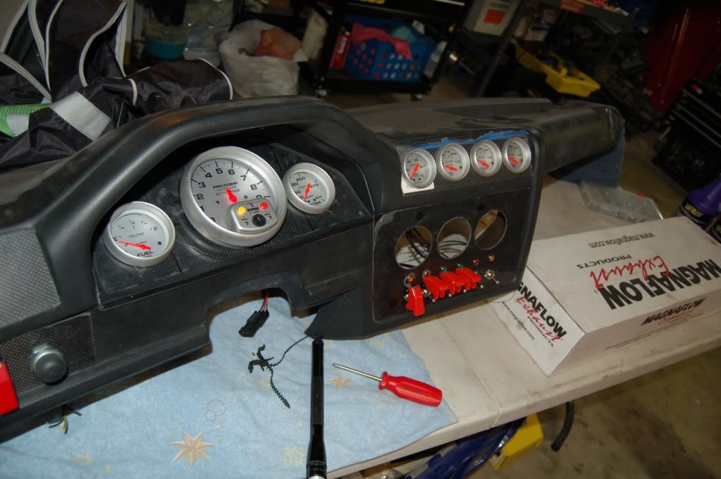

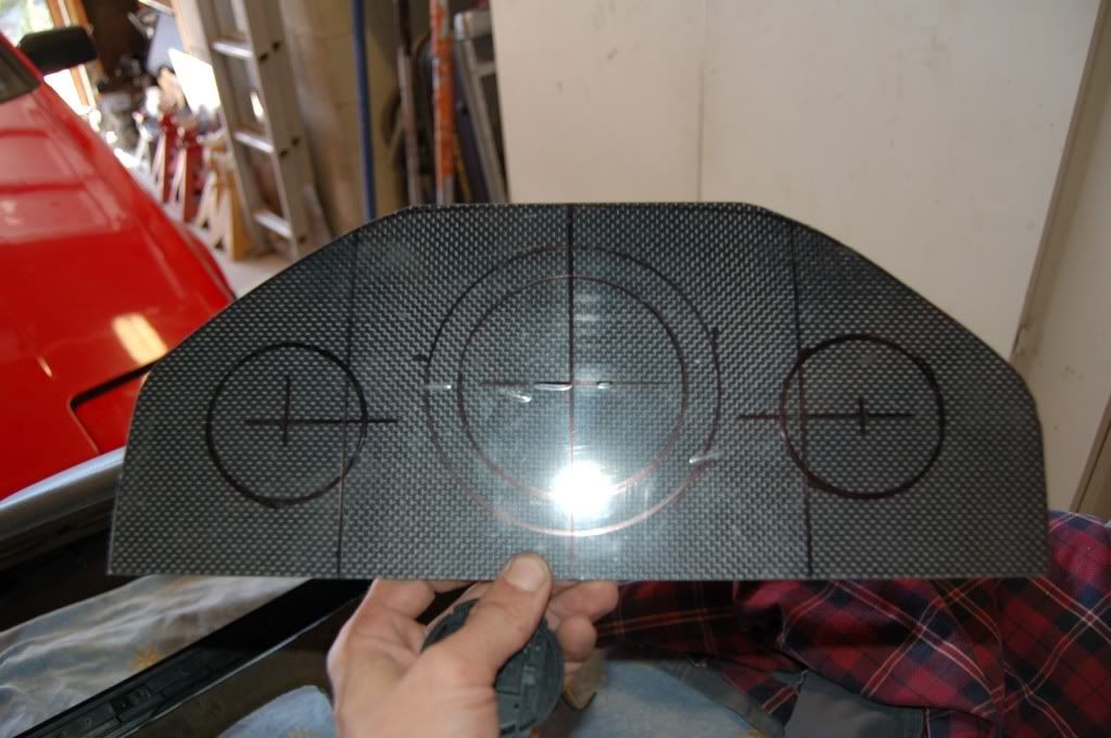

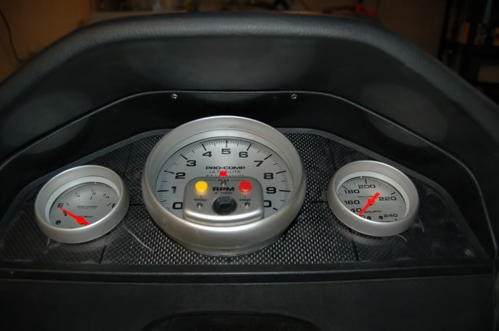

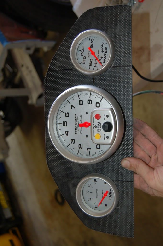

      Made the gauge bezel today too.

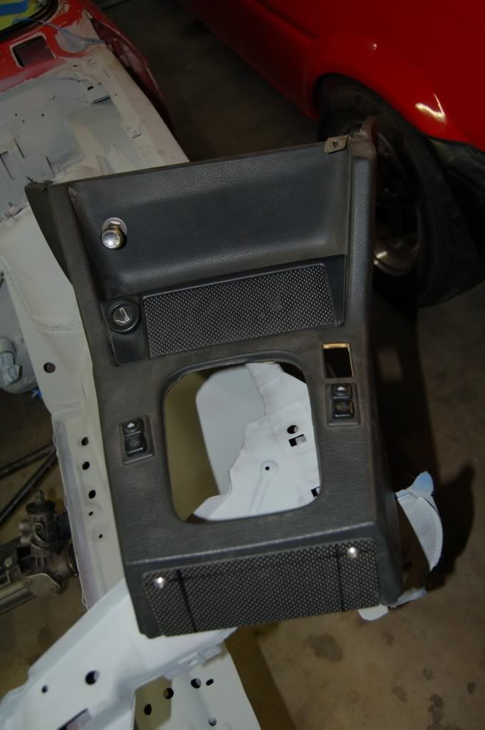

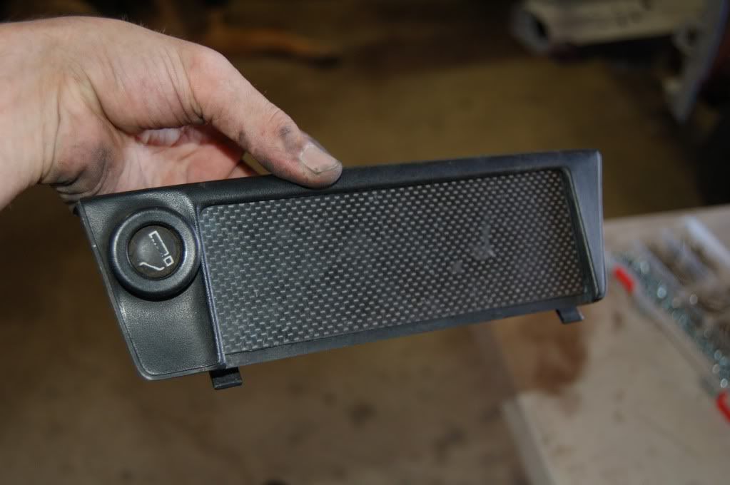

      Made a plate to cover the end of the center console and a cover for the ashtray.

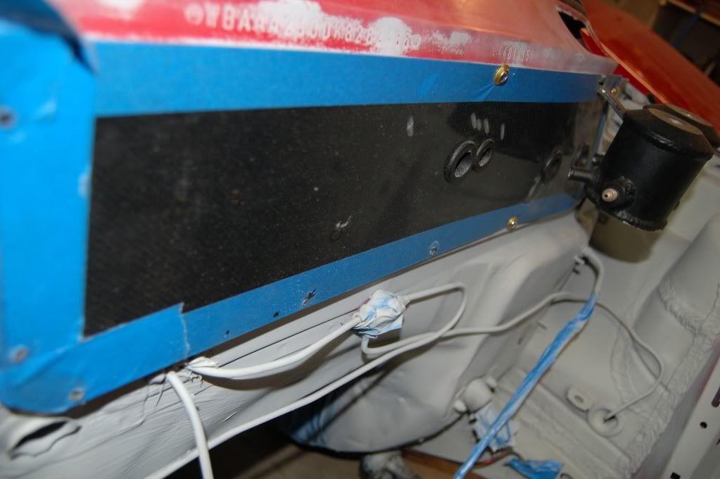

      Carbon fiber firewall panel I made a while back.

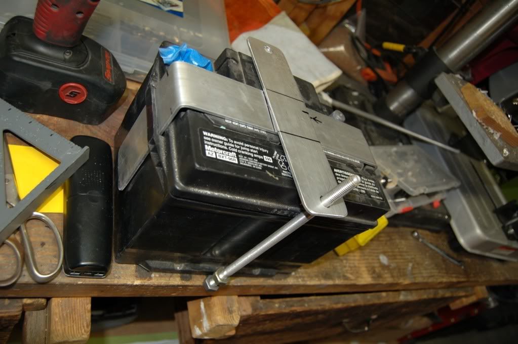

      Just finished a design for my battery mount a few minutes ago.
      Thats all for now, I'll post up the battery mount when I get that finished.
