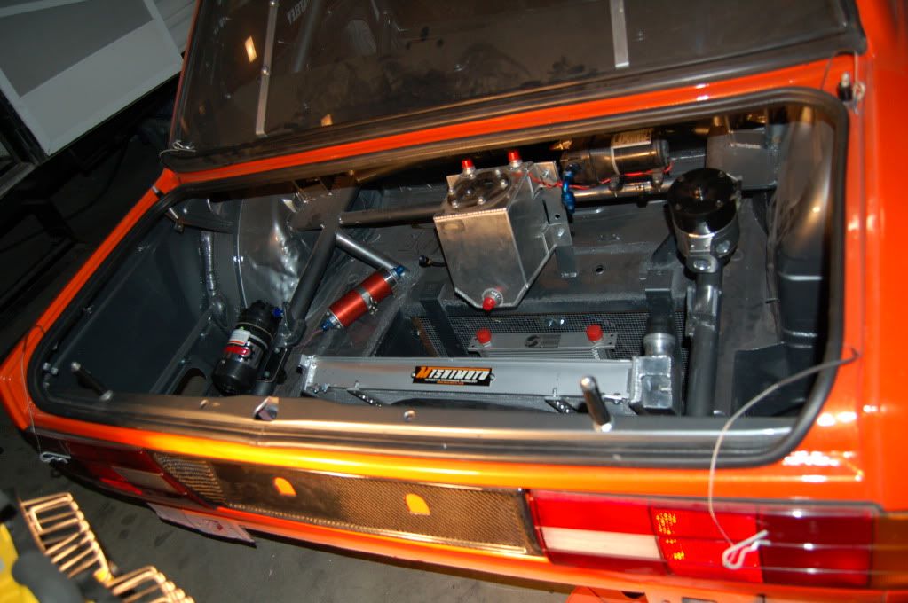

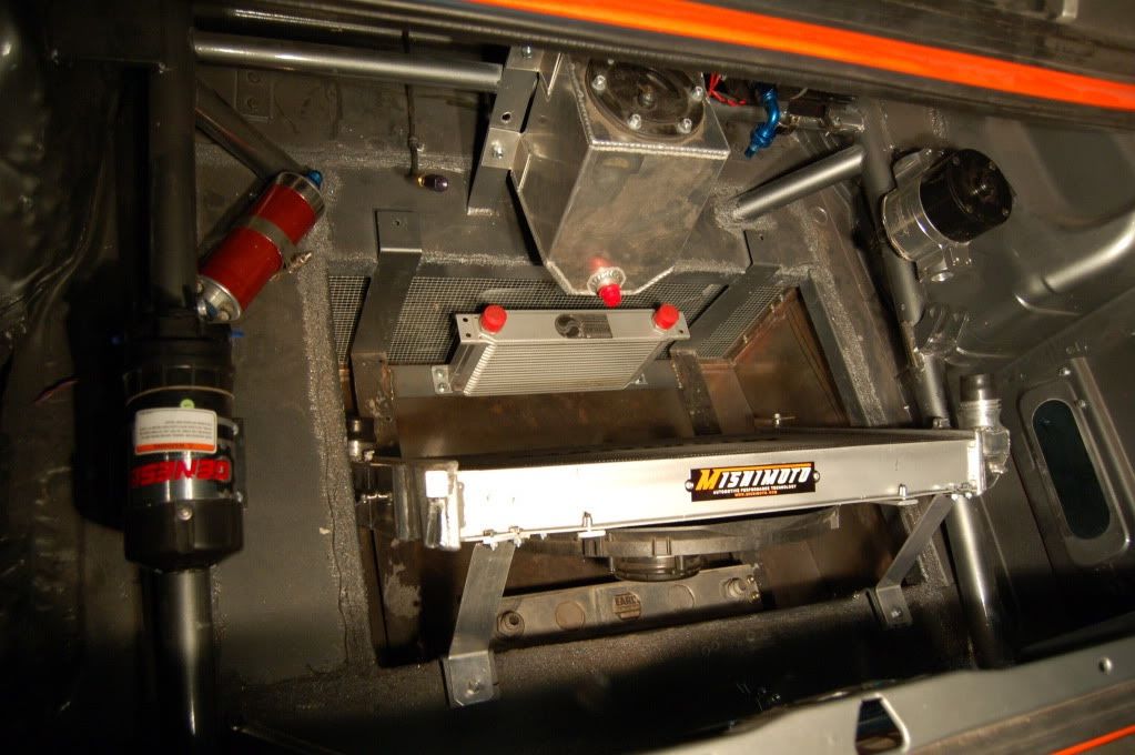

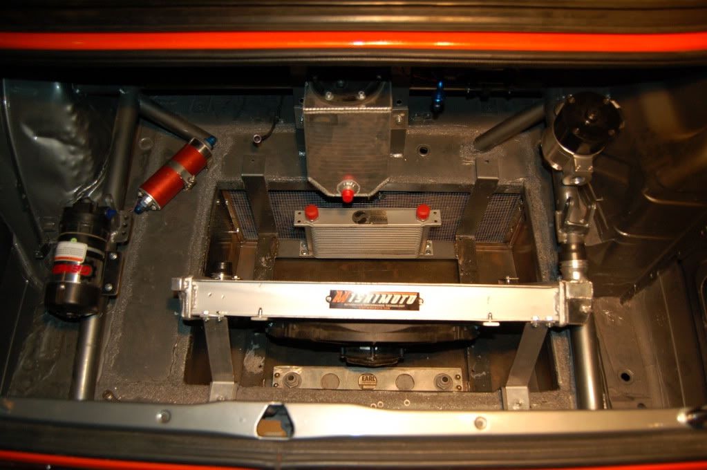

      I decided to use the stock gas tank, it was was lighter than the huge 25 gallon fuel safe cell, and it's mounted in a better spot. So I cut out the old battery mount, and it fits fine. I will find a new spot for the battery when we corner balance the car.

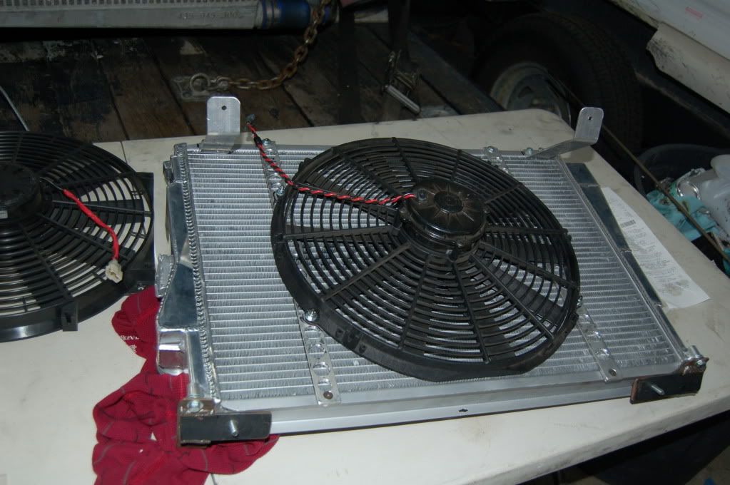

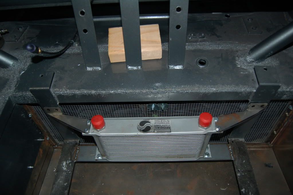

      The gaping square hole where the fuel cell used to be made me sad, so i put the radiator there, and it fit great. This will take about 20 to 30lbs off the front end and give the car a better balance. I made some mounts for it and an angled undertray for the bottom to scoop up some air from under the car and to protect it from debris. I will be sticking the trans and diff cooler in the same spot back there. I made a template box to cover the top of the gaping hole, to seal it off. But I want to see how it works as is before I put in any more effort. If it runs hot I have options: I can make the cover and seal it off, I have room to add more fans, I can make vents out the license plate area, or I can run NACA ducts in the fenders and run tubes with fans though the rear seat back and into the trunk area. I have a few options, but I want to see how it runs first to get a better estimation of how much more cooling I will need.

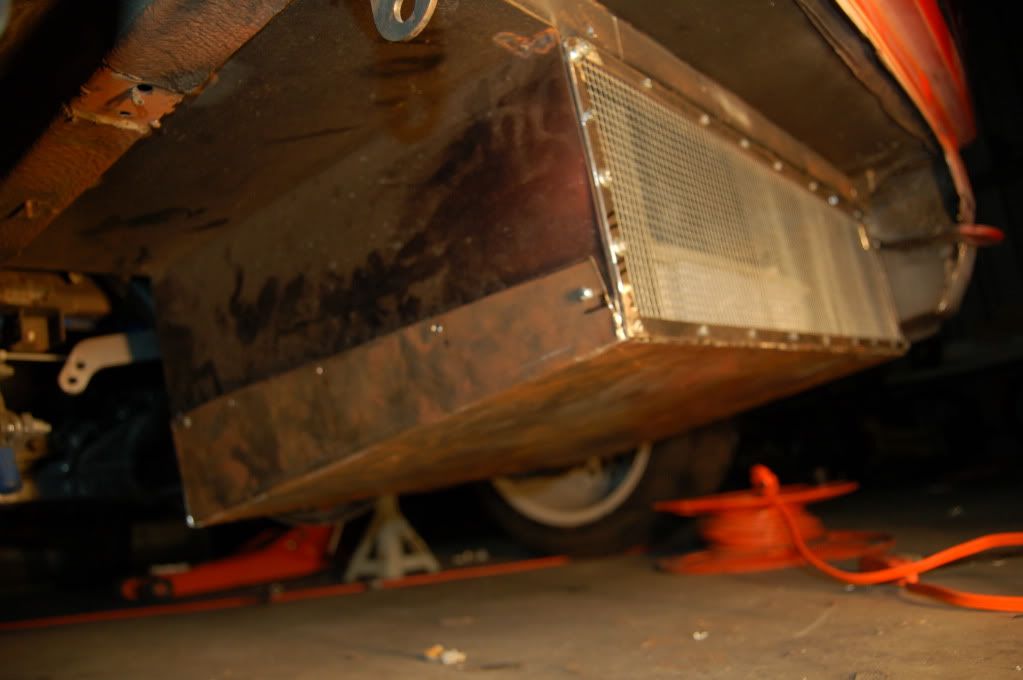

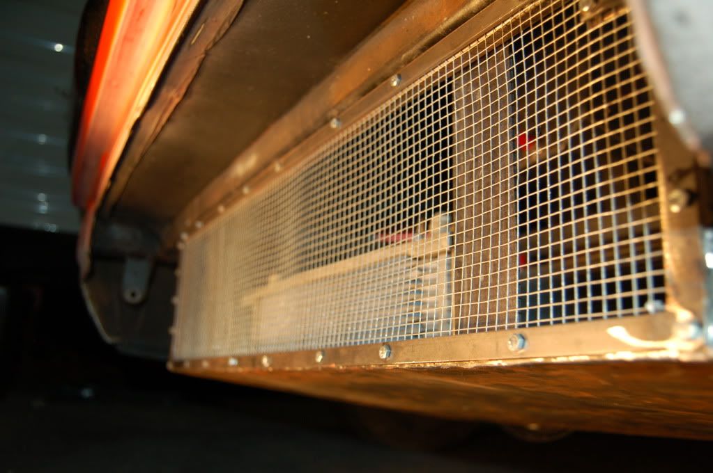

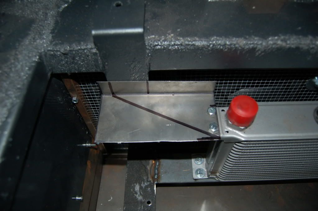

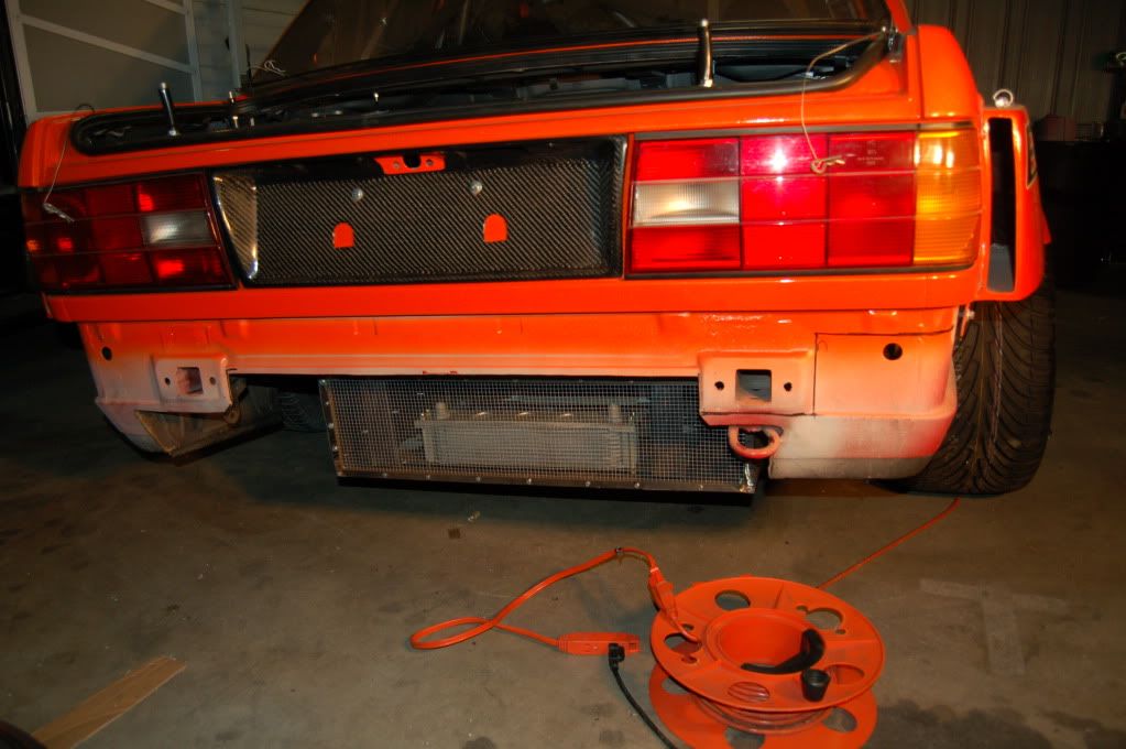

              Radiator under tray:

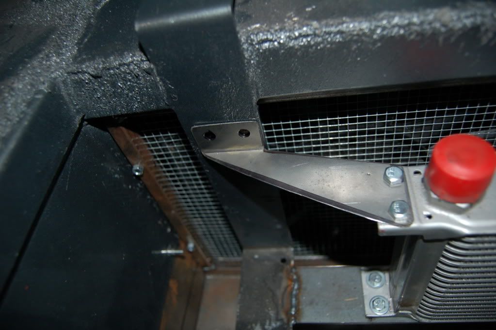

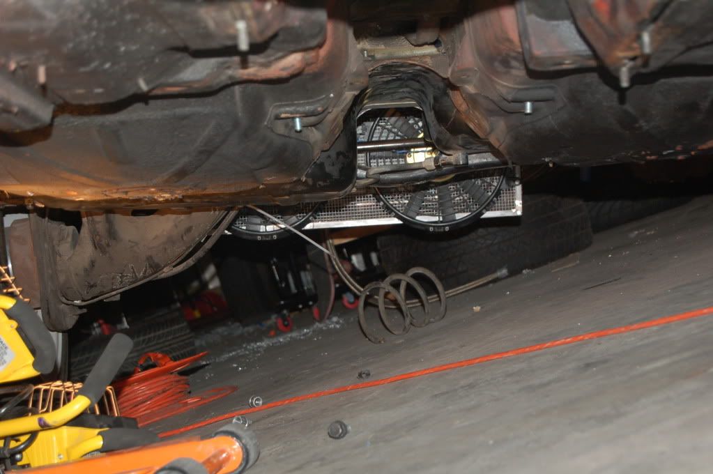

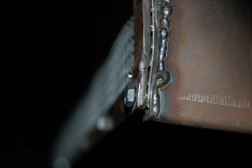

              I started by making the "tray" part out of 040 steel bent down at angle in attempt to scoop up air from under the car. Then I made two 1/2 inch square steel tube frames at both openings and welded them to the pan. I installed rivnuts every few inches in the tubing. Then I made a frame of the existing tubing out of 1/2 inch steel strap and drilled out holes where the rivnuts where located. Then I sandwiched(mmmm) the mesh between the steel strap frame and the tube frame, cut the edges and mounted fans.
              Steel and mesh sandwich:
              Made some cuts for better airflow:
              The tray from underneath with fans mounted up:
              I attached it to the exhaust sheild with more rivnuts
              Trunk is getting there:

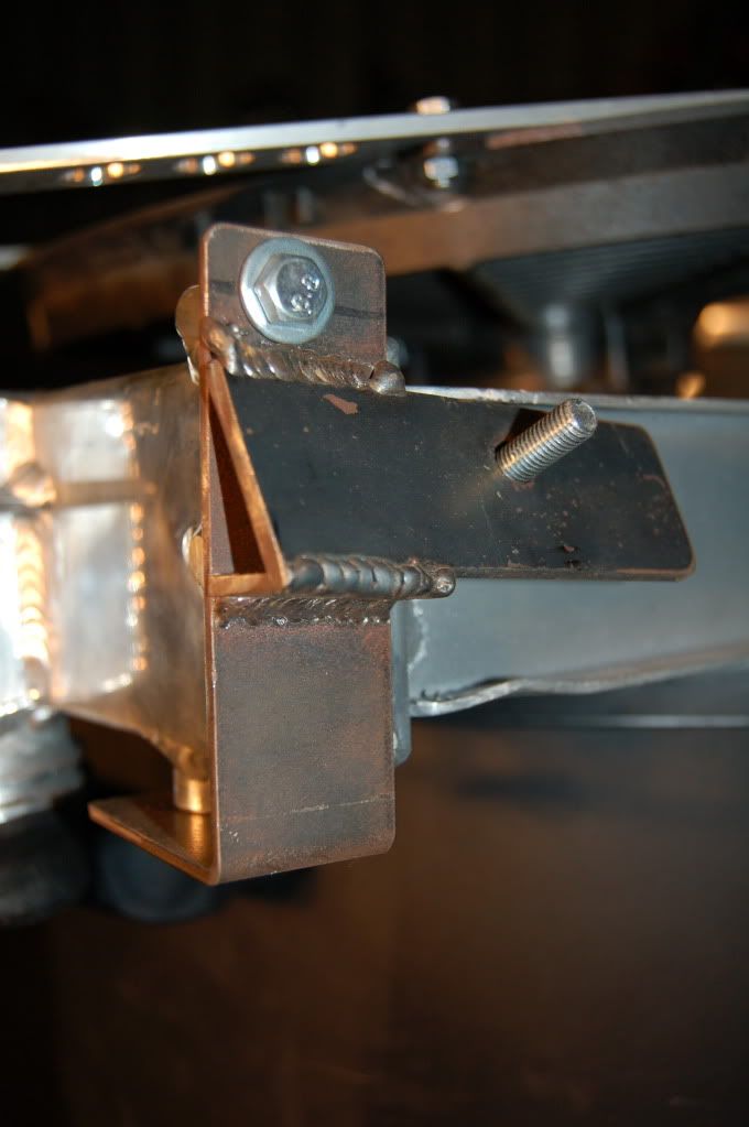

              Radiator mounts:

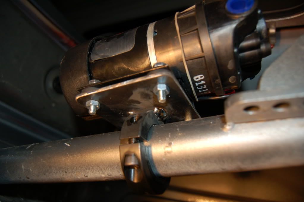

              Mounted all the pumps with retaining rings welded to plates:
              Fan mounts:
              Oil cooler mounts:

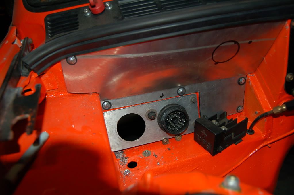

              Twistlock plugs for the harness and making the battery thru firewall connection:

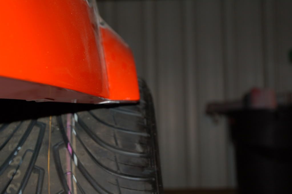

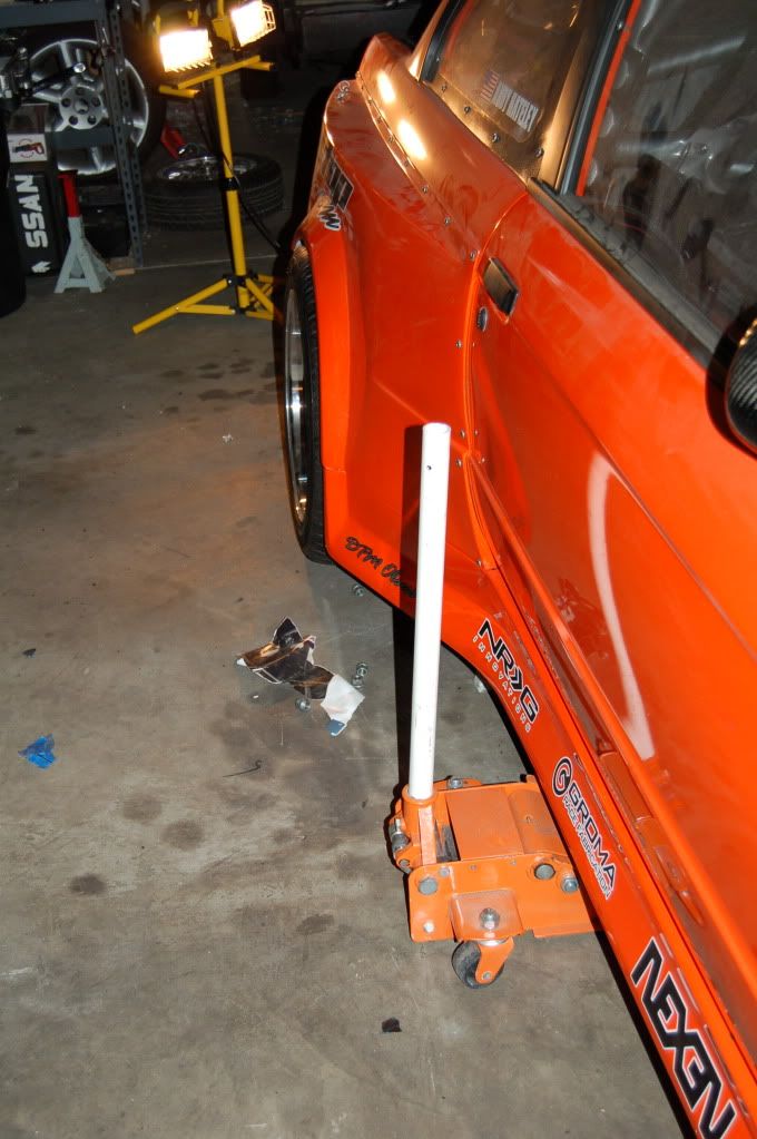

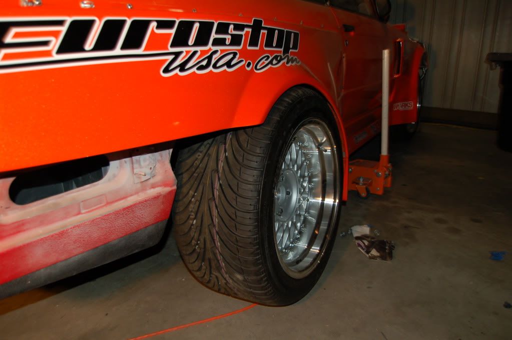

              Messing around with wheel fitment:

                      Originally posted by Dominic49
                      great idea pulling the hot air off the diff in order to cool the diff/motor :facepalm
                      Most cars are designed to stay cool in traffic when they have hot exhaust blowing on the radiator. That can be a hot situation too. I don't quite know if my setup will stay cool enough or not. If it runs hot, I have many options with the setup. I can vent from the windows or fenders to the trunk, cut out the license plate area for more flow, eliminate the lower flow by blocking off the mesh screens or just add more fans At most drifting events we take runs for about 30 seconds to a minute and then sit it line with a bunch of cars, not exactly your typical racetrack conditions. Many drift cars that have rear mounted radiators and work just fine. I many have a few bumps along on the way because I've never done this before, just give me some time and I will get it working right.

                        looks like you passed hella-flush and are almost up to mexi-flush

                          #102
                          Yea its got a little south of the border flavor in those pics! That's just a test fit to see what it looked like and to find out what offset range I really want to be in. That pic has both front and rear spacers bolted together, it's ridiculous. I will get it right before I order wheels.

                                depending on the CFM i would think the fans would could keep you cool while waiting in line for your next run. plus the length of the pipe the coolant has to travel, heat will be dissipated there too.
                                how about putting some rubber mounts or bushings on the radiator mounts so there is no chance of vibration causing Alu welds to crack? (just a suggestion)
                                putting some kinda shrouding from the inlet air scoop (thing where you have your two small fans mounted) to the radiator would help with directing air flow through the radiator making your design more efficient too.
