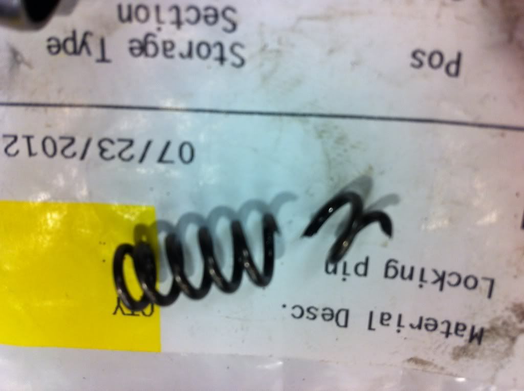

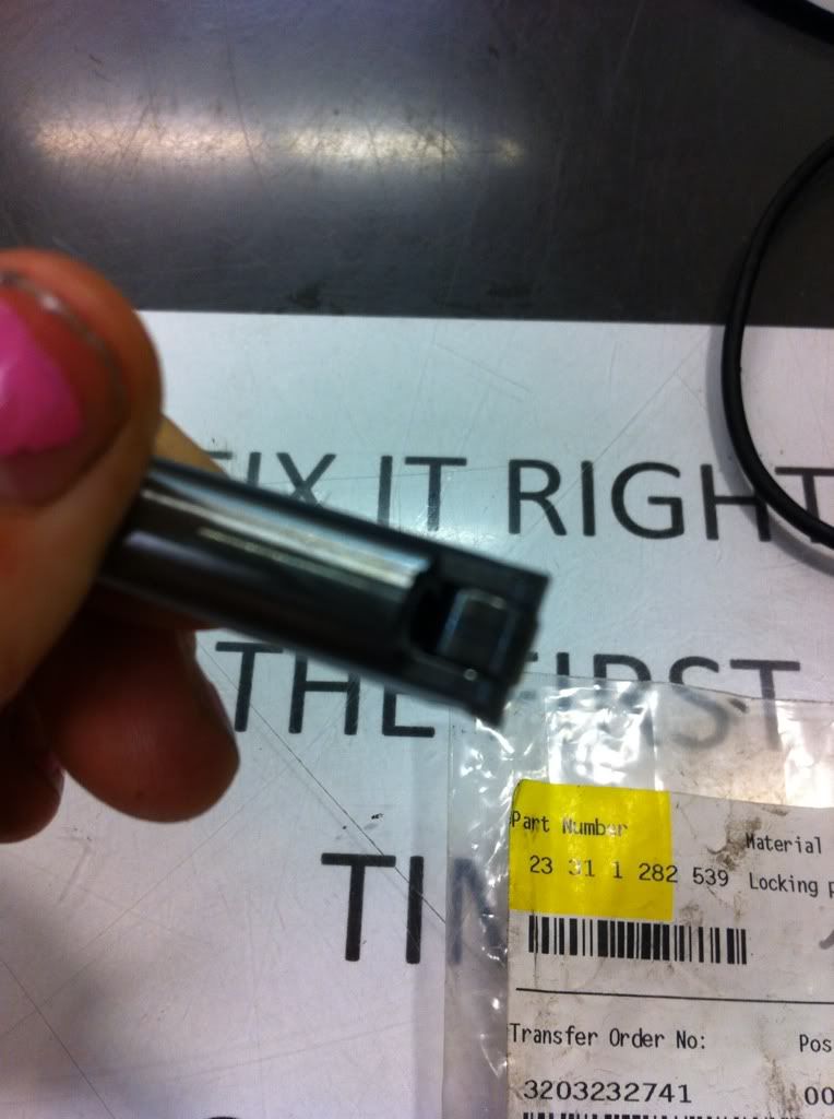

                              Update on the trans issue:
                              Lock pin wasn't broken like I originally thought but the spring that holds tension on it was. The only possible explanation for the shifter intermittently not going into any gear was since there wasn't enough spring tension on the lock pin it was able to rotate in its orafice causing the relief cuts in the selector shaft to jam on the sides of the lock pin and not "roll" on the bushing like it is designed to do. I took it for a drive and the shift actuation is much for positive. Doesn't feel like I'm crunching it into gear any longer. It has a nice subtle "clunk" when going into gear. Everyone pray to baby jesus or allah or whatever that this fixes it and I don't have to pull this trans out!! What you can't see in the picture is the spiral pattern on the lock pin from it rotating in its orafice and the marks left on the end of it from the selector shaft mashing into it. I also don't usually wear pink nail polish, that's my girlfriends finger nail.
