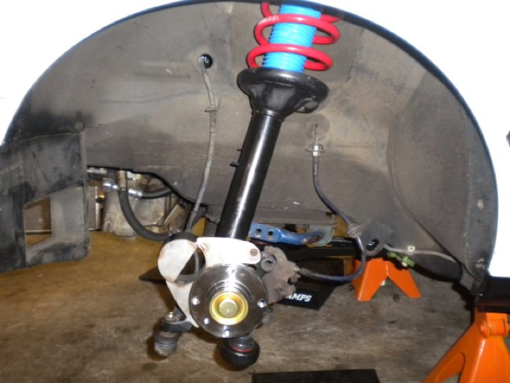

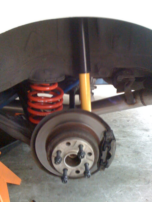

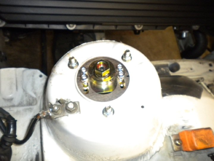

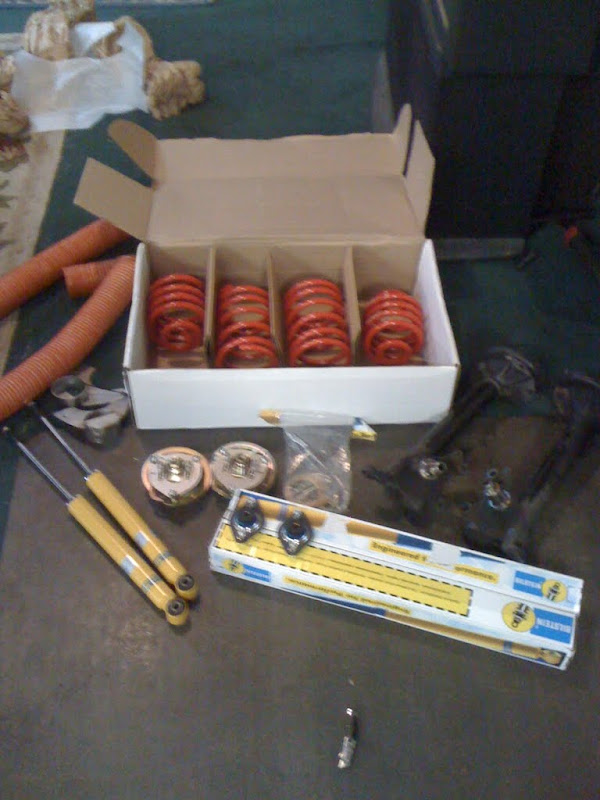

                        More pics from the weekend. Got all of the new suspension on. New control arms, wheel bearings, H&R race springs, Bilstein sports, JT design RSM, Vorshlag Camber plates, Brake backing plates with hose, Vorshlag 90mm studs and New hardware.

                          Why did you decide to change from the coilover setup to bilstein / h&r race?

                            Idk I really just liked this set-up on my old car, I still hear crap from Dominic49 (best friend) about how he can't believe I sold my coil-over kit but it is what it is hopefully I didn't make a mistake.

                                Not a fan of the suspension choice. The H&R Race will be too soft up front for the added weight of a 24v motor + the extra weight from turbo. On top of that you have no adjustment with your shocks.
                                Hopefully you prove me wrong with the suspension, but I don't see that happening. Good luck either way.
