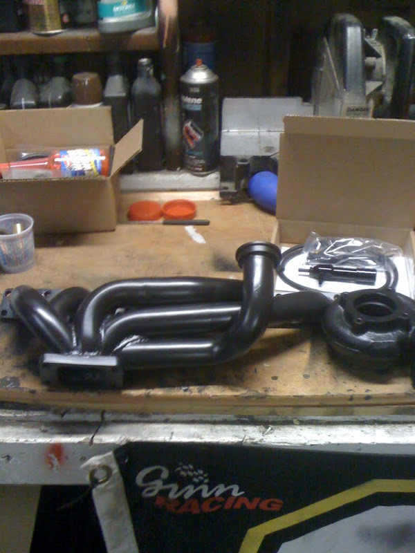

                I got the manifold and housing back from the coater's yeasterday :) It looks awesome but I do have a question should I grind the coating off the flanges? Or will it matter?
                Thanks
                Justin

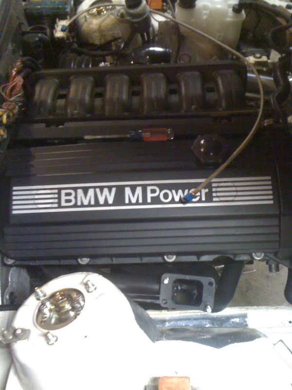

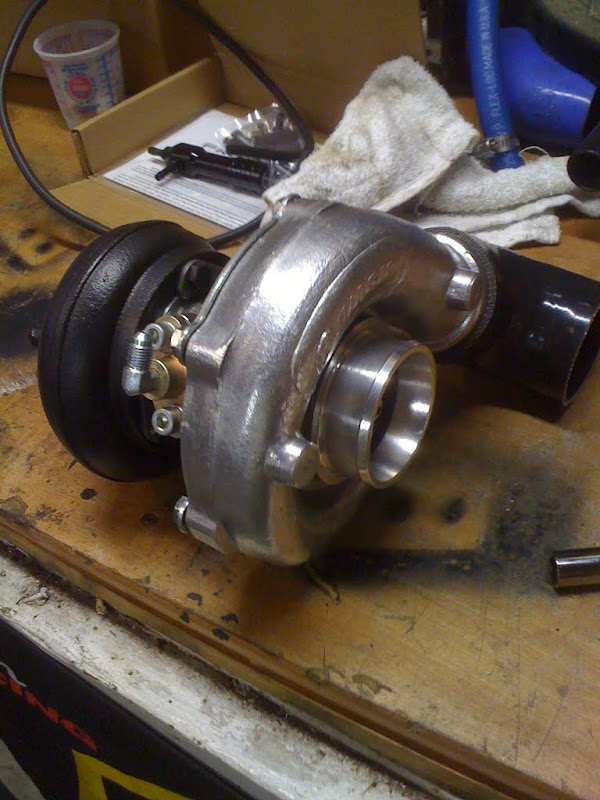

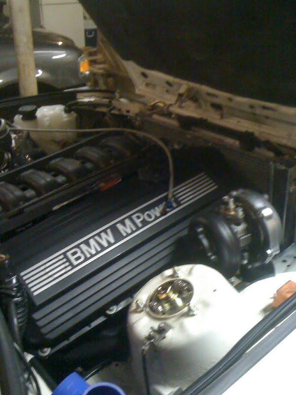

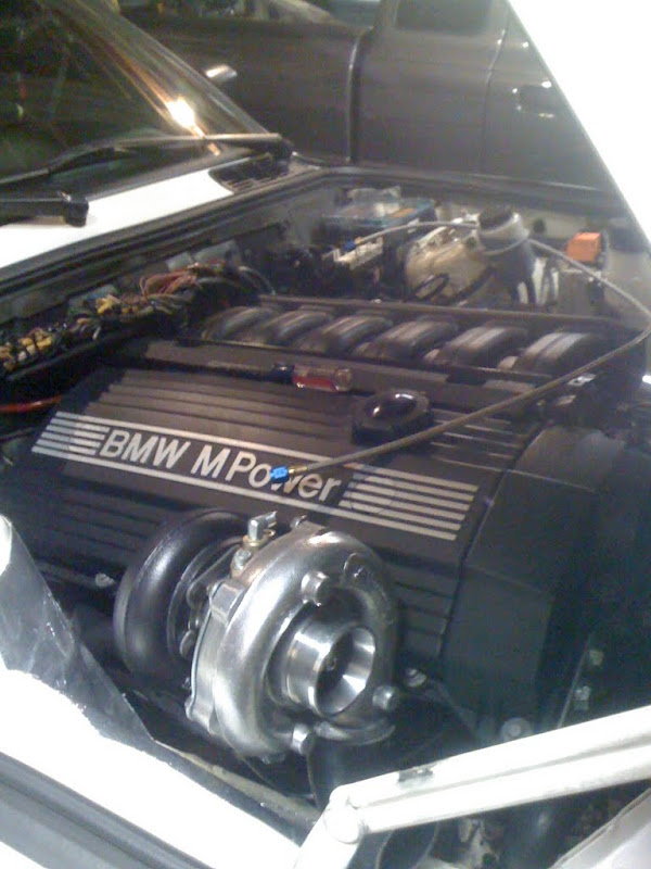

                  Pictures of the progress. I have to get a shorter oil feed line :( 4 feet is just too long for top mount. Here's what I got. http://www.summitracing.com/parts/AAF-ALL48166/
                  The manifold is on and tightened down (what a pain in car) Everything seems to be coming together. I need to tap the pan this weekend so that will be fun. I also have to install the intercooler and mock it all up.
