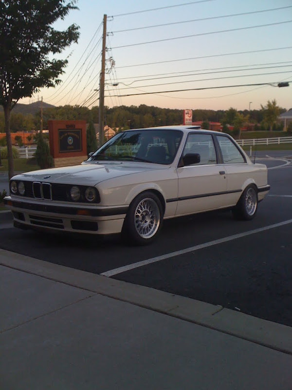

    Pictures of the car with the supercharger

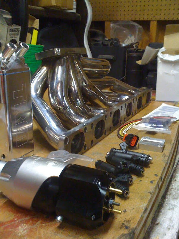

    Parts are coming in !!!!
