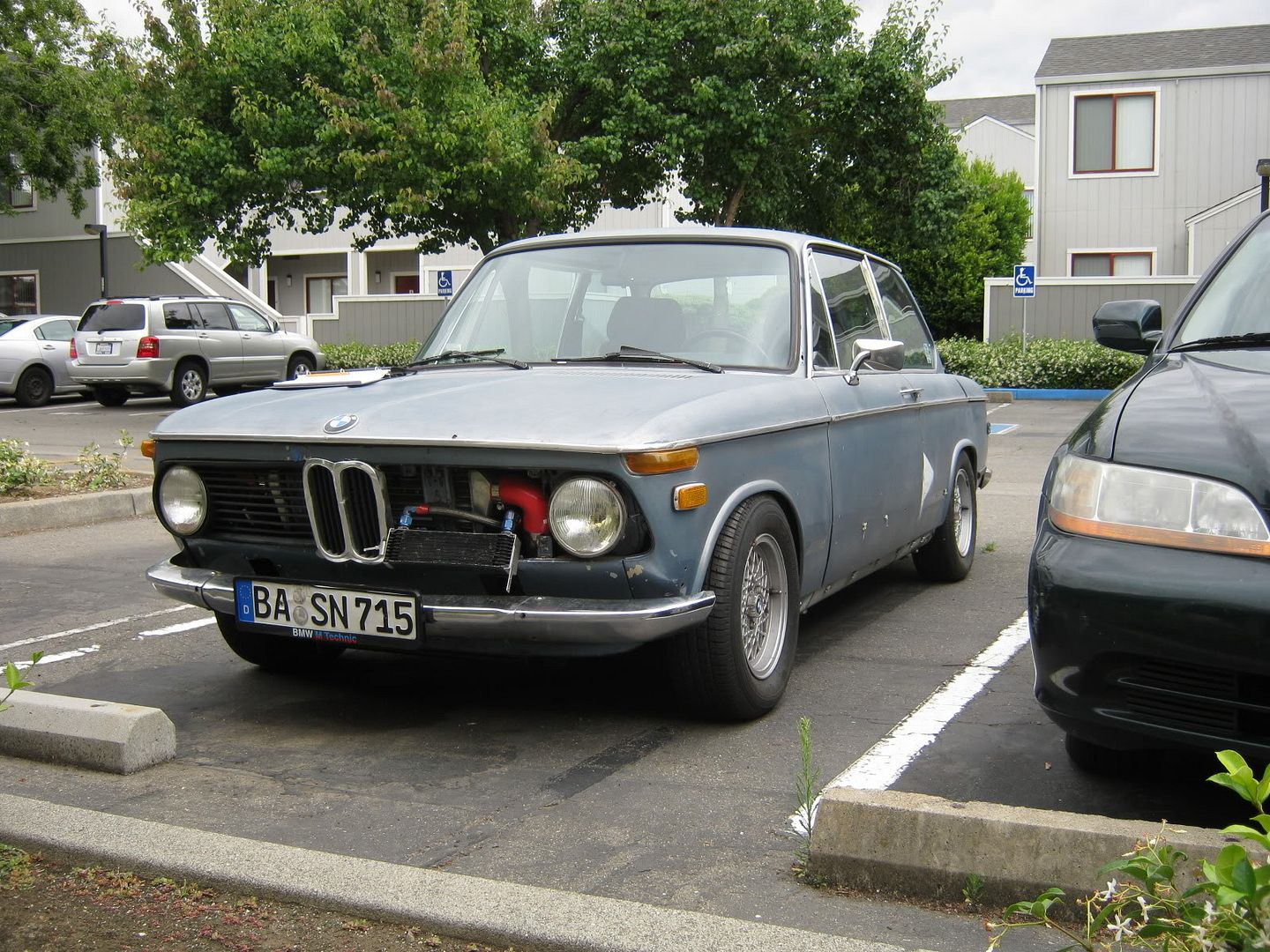

    It's on the road! now Im just gonna try to tie up lose ends and make sure the car is safely driveable.

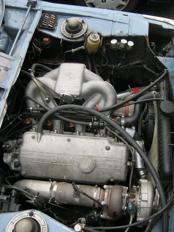

          Specs:
          to keep it concise
          2L m10 Engine.
          head ported polished +1
          SS valves
          292 camshaft
          Shrick springs.
          Ross Racing Forged PIstons 8.75:1 CR
          ARP studs
          MLS headgasket
          Megasquirt fuel
          EDIS injections
          Fat Intercooler
          Holset Hy35 turbocharger
          Tial external wastegate
          [/url]

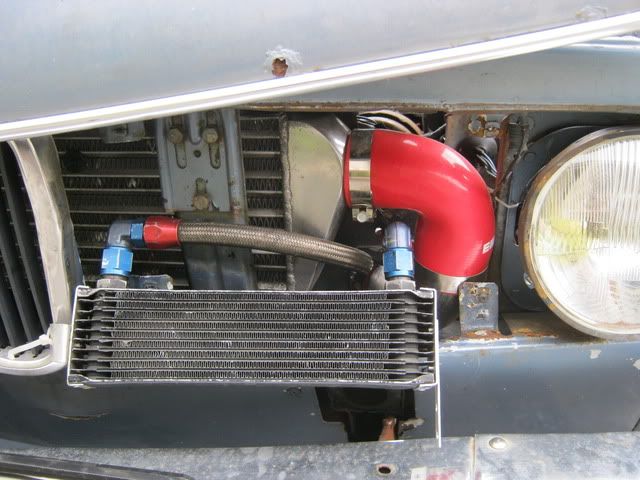

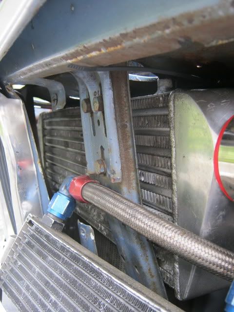

                what size intercooler are you running? Did you have to cut out any of the inner structure to make it fit?
                I just quickly looked through your thread but didn't see any pictures showing the intercooler up close... I am planning a turbo m42 build into a 76 2002 and still up in the air the IC to use. I used a short but long one before in a 2002 but I never liked how it fit, pain to get in and out.

                  I really dont know the size, but It looks a little bigger than yours, mine was also A huge pain to get in there.

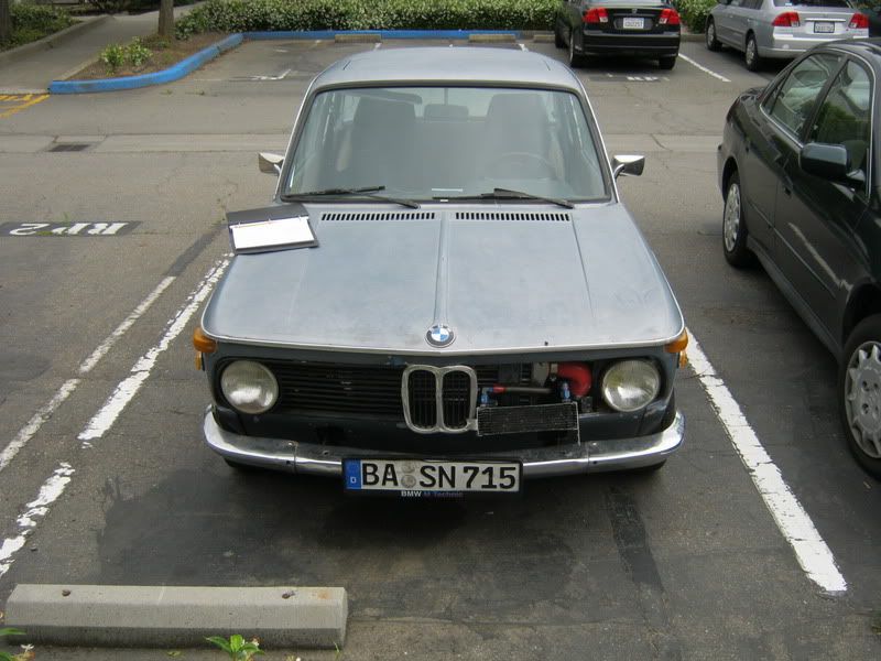

                    OKAy Summer Is here and I just compiled a list and am now gonna post up some pictures to document what is going on.
                    First off here is how she sits
                    nice and PErty....

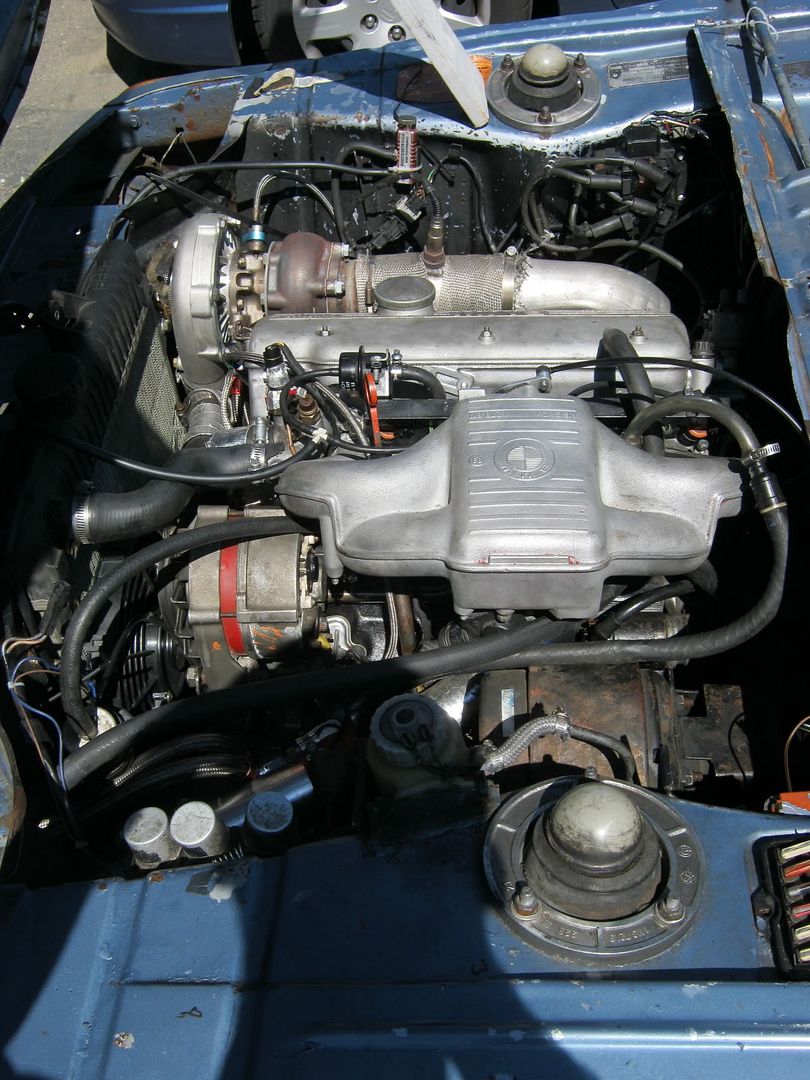

                    and here is the Engine
                    New steering wheel :)
                    As you can see there is that oil cooler chillin (pun intended.) I plan to move it In between here, and down a little.
                    Anyways....

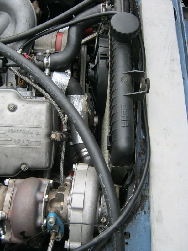

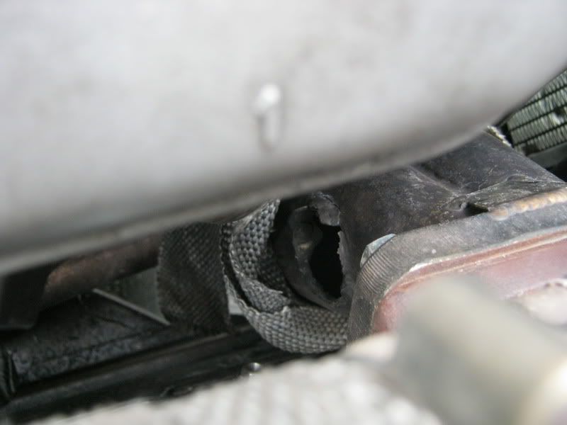

                    So I have a couple things left to Do:
                    my external wastegate port had a faulty weld, so I will be taking it to an exhaust shop to get fixed
                    The thing is, My turbo sits a little far forward, not to mention it is oversized...
                    I just bought a 666 Manifold, which should allow the even larger holset to fit in there more snug, and away from the radiator, IF someone had a smaller turbo or a different m10 engine they could totally use this manifold, and have it externally gated (Shameless Plug trying to sell this manifold). Then I could run the stock manual Fan , or fit one of 3 electrical fans I have yet to install.
                    1 12" and 2 9" ones that I can play with, thus I might want to fabricate a new radiator support as well so I can make an airbox for the holset turbo. fun fun.
                    If anyone wants to help out, I could use facilites/fabrication expertise... but have my own tools :).

                      I did Also do some Engine Fuel line tucking to start... This was merely a mock up. I plan to find some 90 Deg Fittings to make it look straight, and also a bracket would be pretty cool as well to clean it all up... So far my focus is to get it looking nice while the parts come.

                          Motor is looking a lot cleaner! Where did you get that oil cooler? Is it a stock part on some other car? I want a different oil cooler for my m20 but I cant spend $300 on a new one.
                            #73
                            yo dont have to spend 300 on an oil cooler. Check out pegasus racing or something along those lines, there are lots available
                            [/url]
                            Team USA Wrestling 67KG
                              #74
                              Awesome build!
                              Where are you pulling your oil feed from?
                                #75
                                The 2002 oil filter housing from the Stock tii has an oil feed line, That being said, on a stock 2002 it can be drilled and tapped.
