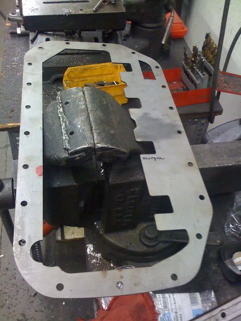

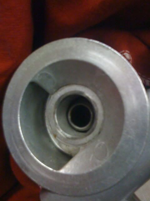

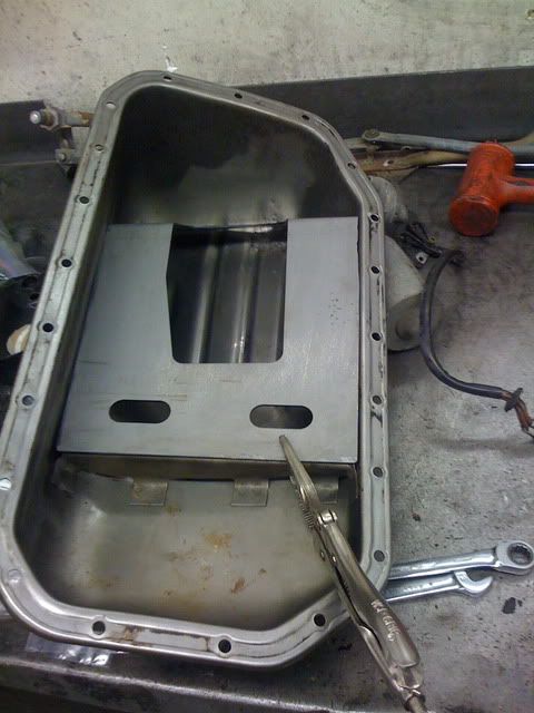

        got a couple more things done, some pictures for ya'll

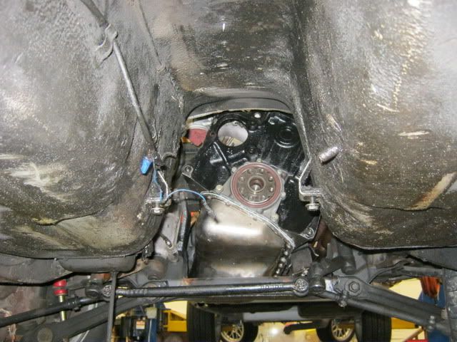

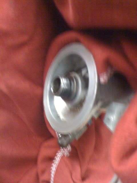

        First up I have to fit in the sandwich adapter for the oil cooler. not sure how it works.......
        Also, the baffle is about ot get welded in and the scraper in place.

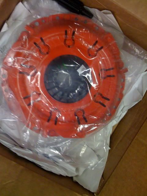

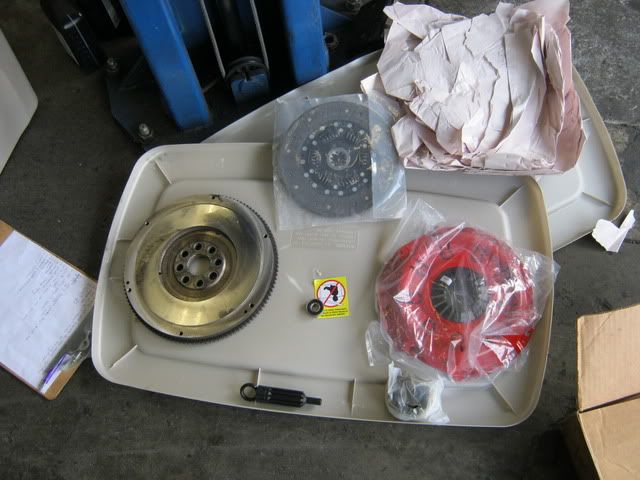

        SHINY stage 2 clutch!

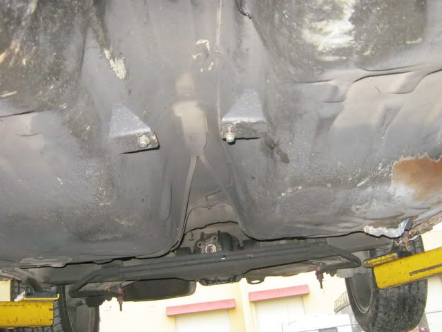

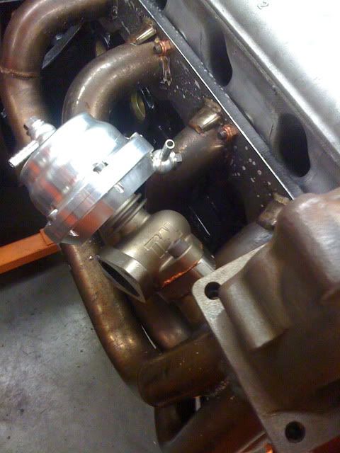

          #49
          External Wastegate On ;) Thanks A bunch AARON!
          going to USe the TII Pump return. Its not bracketed down yet, so it appears to have some "upflow" but it will be all leveled out once it's tightened down.

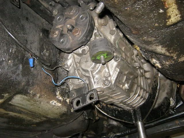

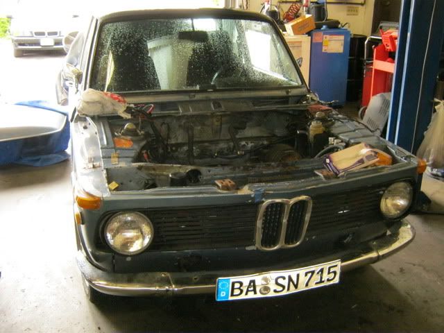

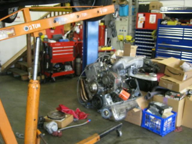

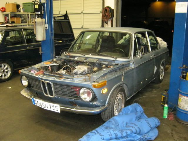

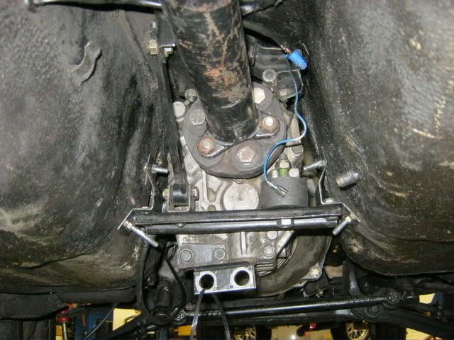

            JSUT ABOUT READY TO drop that mother in
            Okay, here comes The CRANE!!!
            Poor car is so sad without the transplant
            TADA!!!
            engine sitting in waiting for the 5 speed, EWW get rid of that 4 speed
            nobody likes a 4speed, so I got rid of mine
            Goodbye!!!

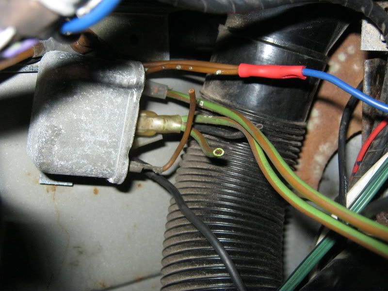

            I gotta couple questions about what this thing is and what are the wires that are supposed to be attached to it, but are cut...
            And that black wire on the left, what does that go to?
            [/url]
            Team USA Wrestling 67KG

              #51
              I believe that's your Dynamic Stability Control module. ;)

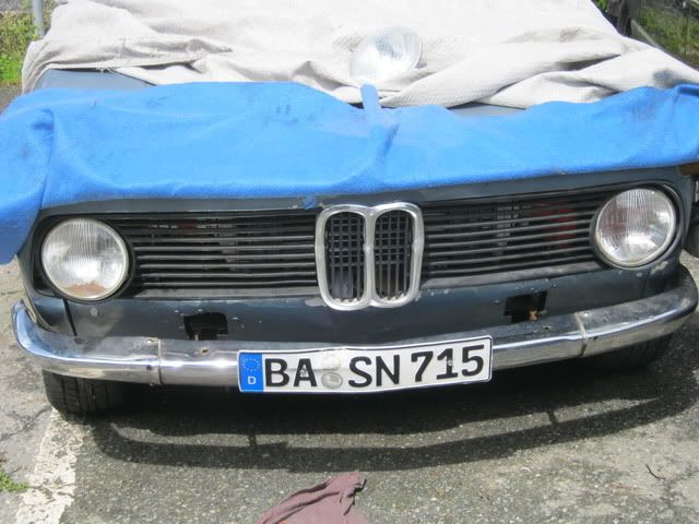

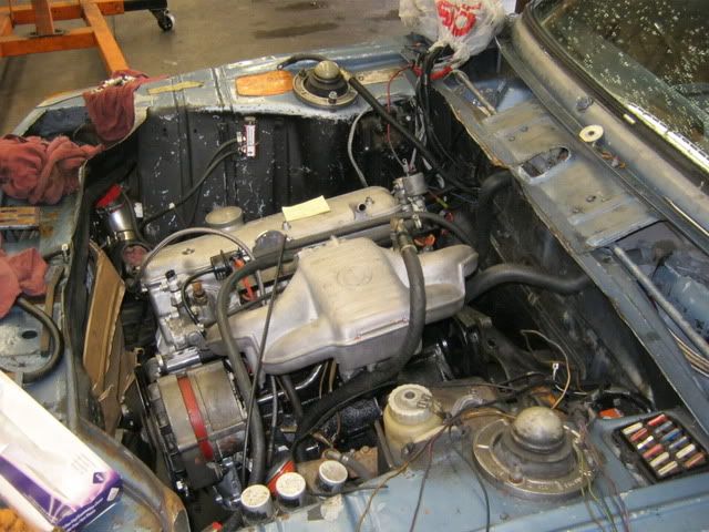

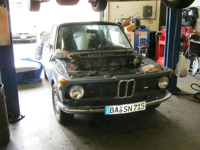

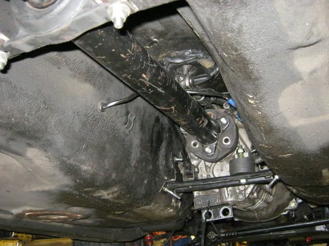

                UPDAte for today

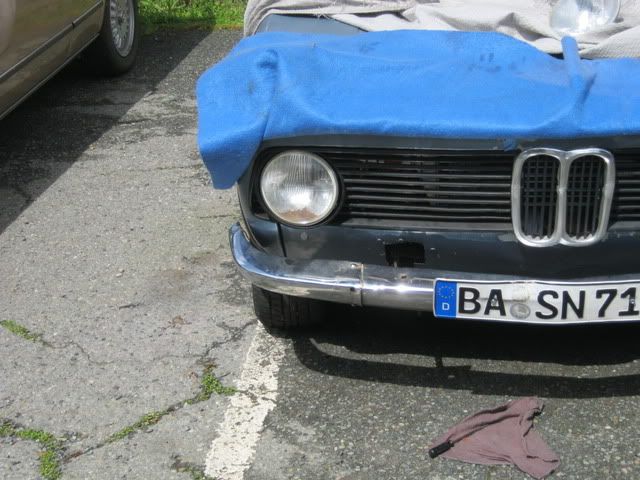

                put in the new headlights while the lifts were in use:
                CIBIES
                The wiring is a hell hole, I will have to re-do all of it... if anyone is good at being neat. hit me up ;)
                Because usually stock isnt enough

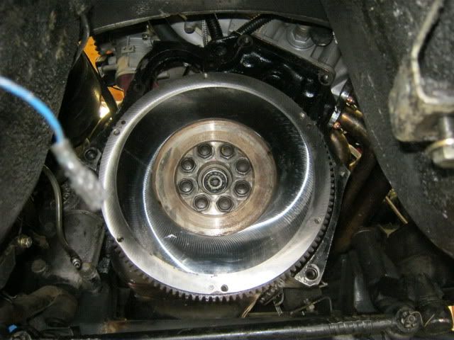

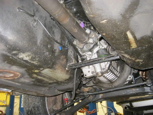

                I got a stage 2 clutch to match my 228mm flywheel

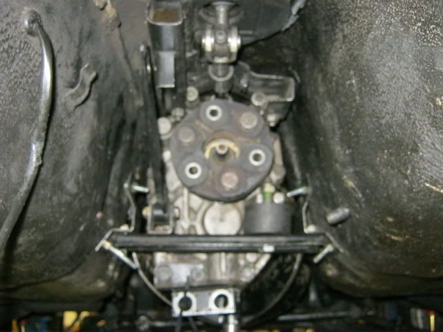

                Time to start slapping in that transmission.... Cake walk right??
                I made the mount for the transmission, but I think I will have to adjust its height Thing I put it up too high ,Things get shifted even when you measure twice :(
                and here it sits nice and hoodless

                    #54
                    where did you get your drive shaft shortened?
                    • LJ851
                      • 7919
                      #55
                      Why do you think it is too high? Its usually a challenge to get it high enough to be square with the flex disc.

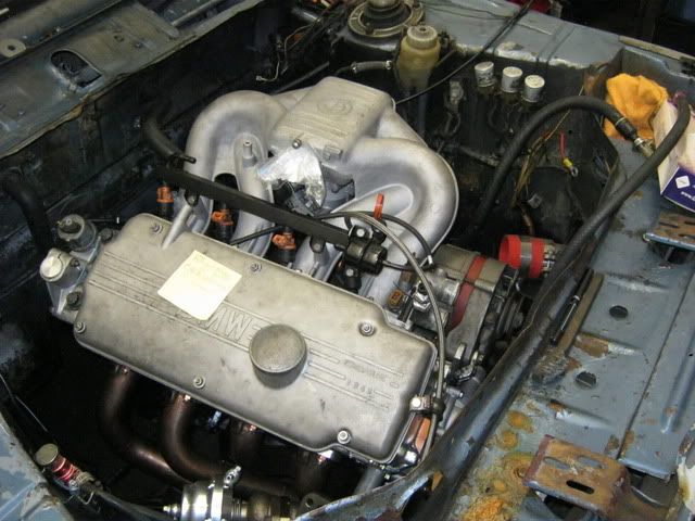

                        #56

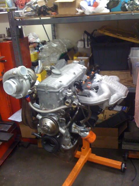

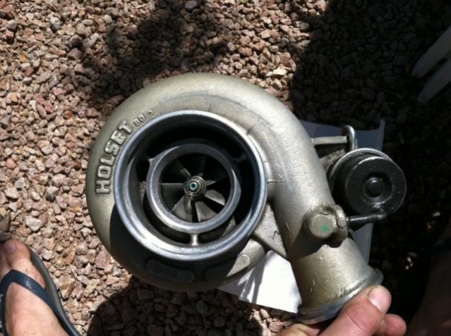

                        new turbocharger
                        Hy35
                        perfect candidate for setting up roughly 300 HP.
                        [/url]

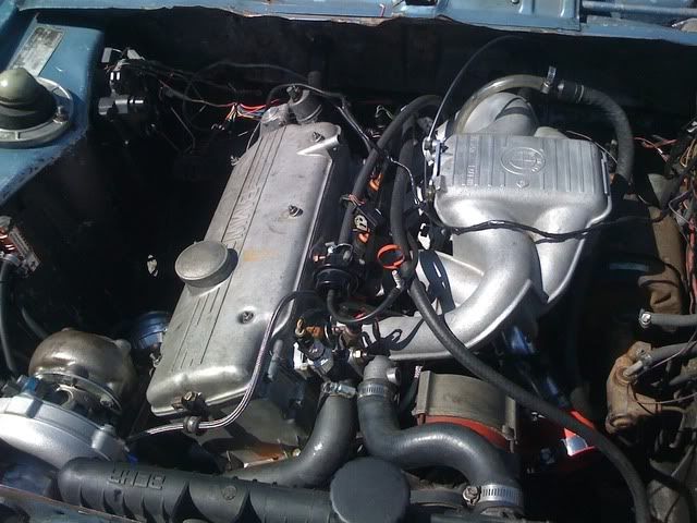

                          #57

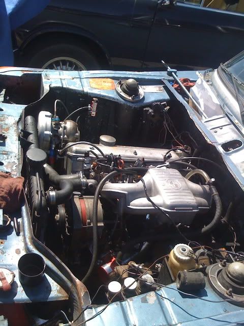

                          So today,
                          got a lot done today
                          Attached throttle Cable,
                          Wired UP EDIS, and Tach
                          filled it with fluids.

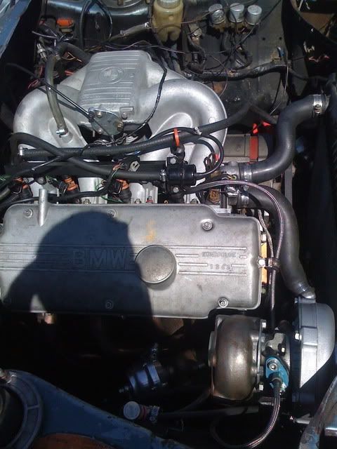

                          adjusted valves ( which was difficult, It was hard to get them snug, so I may need larger eccentrics or soemthing
                          Turbo test fit with the Ebay turbo ; waiting on the new BOV which to come in the mail, old one was stolen
                          Still have to electrical tape wire the rest of the EDIS. and sort through the wires on the Driver Side.
                          Also gotta install the holset once it comes in the mail, and take it to the exhaust shop.
                          Im lookin to do 3" with two glasspacks in the center.
                          Also my homie sean was there to offer a helping hand. It's always nice to have some dudes hangin around, for comic relief and just makin things easier.
                          other than that, she is ready for action.
