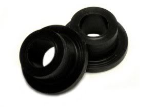

                            making the delrin shifter bushing with garagistic

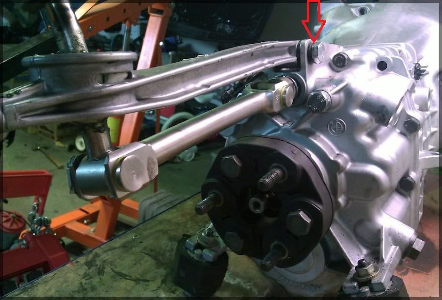

                            I'm also using the AKG Delrin shift carrier bushing, and replaced the shift carrier pin/bitch clip with a shoulder bolt and nylock nut. There is not even the tiniest bit of slop in this shift linkage anymore. I can't wait to see what it feels like to drive this.
                            akg's delrin bushing has the smaller side of the bushing fit inside the shift carrier and not go through the trans case, im wondering whats this black piece that i am pointing at with the red arrow.

                              Yes, I am using the stock rear mount. That's an area where you do want a little ability to wiggle and flex. The shift carrier is cast aluminum, if you turn it into a rigid structure, you run the very likely risk of snapping it during a hard shift.
                              What you're pointing at with the red arrow is washers, because I didn't want the head of the bolt against that ear, and so I wouldn't have so much thread sticking out the other side.
