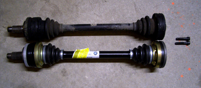

                HAHA this pic reminds me! Might I suggest replacing your halfshafts with the "i" halfshafts if you plan on ever dumping the clutch. My passenger's side inner C.V. literally exploded during hard accelleration. The i half shafts have larger C.V. joints and longer bolts where they attatch to the diff. Just a heads up.
                edit: here's a pic so you can kind of see the difference.
                    Do late model halfshafts even fit in early hubs?
                      My eta is an 87 (10/86 production date) and they fit.

                            There's a difference between early and late model halfshafts/hubs? Can someone explain that to me? I thought they are all the same save for ABS/non
                              I'm curious as well.

                                Good info to know, but I'm not swapping them for that reason.
