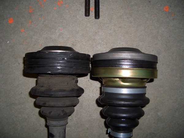

          There is no difference in early and late hubs, there's no difference in e and i axles. Feel free to keep telling me there is, but there is not. I've owned 25 of these things and worked on god knows how many.

              Arent new C/V's ~6-700$ a side?
              Any E30 CV works in any other E30... BUT if you have ABS you need one from an E30 WITH abs.. if you dont have ABS then it doesn't matter.
              Also, dont reuse the bolts that hold the CV's to the diff, i learned that after my $90 towing bill...
                        All 325e output shafts (w/abs) from 7/83 - 7/88 are pt#33-21-1-225-893 and use a M10x43mm bolt to attach the inner C.V. joint to the differential.
                        All 325i & M3 output shafts from 11/86 - 1/91 are part #33-21-1-226-901 and use M10x50mm bolts to attach the inner C.V. joint to the differential.
                        i and M3 axles(being the same) have a thicker C.V. joint and use longer bolts. I didn't find this photo on the web, I took it.
                        /threadjack sorry janderson

                                Also, BMW seems to have superceeded the short bolts with the long ones... i could not get brand new short bolts, so i had to get the i CV's
