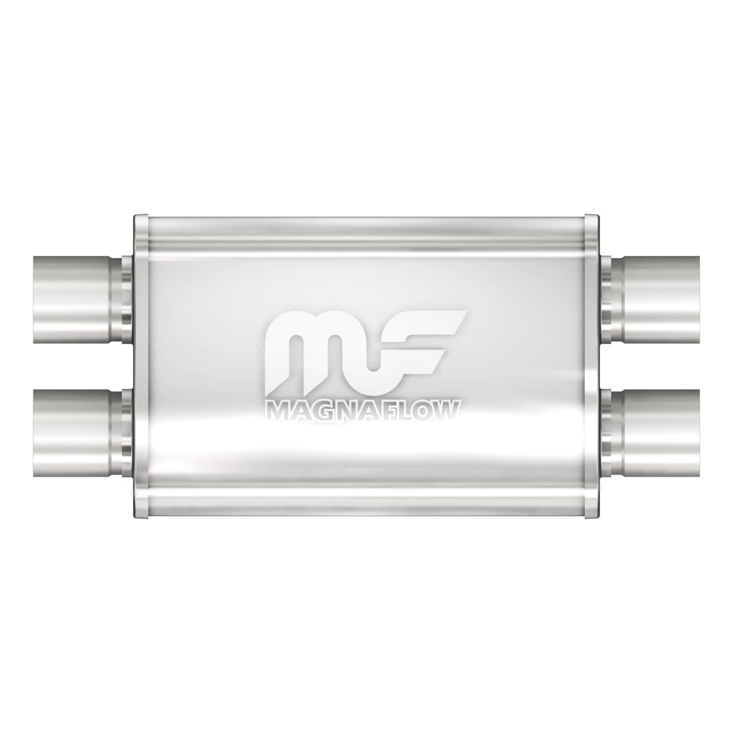

                                Well, I was going to just use the stock E36 M3 stuff all the way back including the muffler, but I'm ditching the M3 can and going with this instead:
                                Free Shipping - MagnaFlow Performance Mufflers with qualifying orders of $109. Shop Mufflers at Summit Racing.
                                That M3 muffler is just too damn big and heavy, and I know it's going to hang down way below the rear apron. Still going to use the M3 midpipes/cats and piping back to it, but I can get this muffler for pretty cheap, and it sounds great. That's an E36 328i in the video, so it should sound pretty similar.
