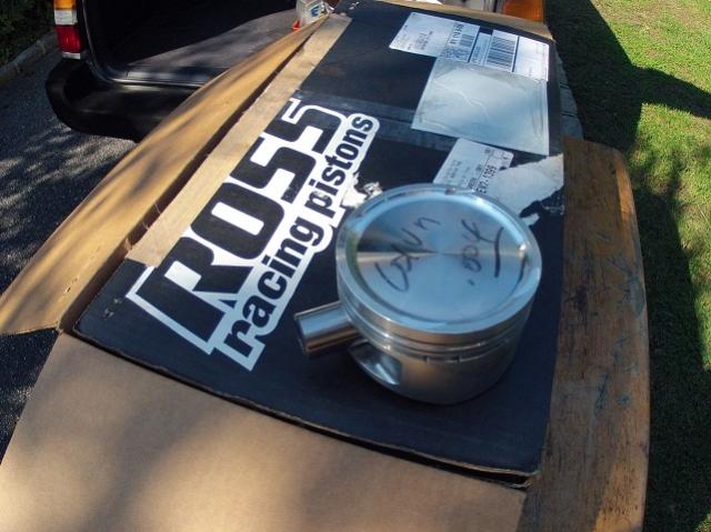

        Thanks man. Waiting on the machine shop to get the Ross pistons in which should be soon. Sorry darksideofwill, will take your advice on the next one. I have the e30 to s38/m30 block mounts from my m30 and another set that came with the s38. My m30 is 2.5 and the ones that came with the swap are unknown but i have two sets to work with to get me a good position. Im not too worried about getting it to fit. The radiator is custom and will fit in the radiator support where the AC condenser normally is. Im going to use the stock s38 t-stat housing, coolant piping on the front of engine and run a mechanical fan off the water pump. It will be tight. I have yet to make the subframe spacers. I will not be running the stock airbox which might be the higest point so the hood will hopefully clear if thats the case. Megasquirt 3, wideband O2, and Adjustable FPR are here. As a result the MAF and airbox are getting tossed. I will now have space for the stock brake MC. Plannnig on running 6 conical air filters off the ITBs. The exhaust will be 3" to a single flowmaster muffler. Single 3" inlet to a dual 2.5" out.

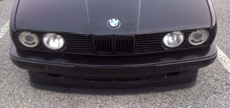

        Non s38 update, picked up a Ryan G. splitter.....

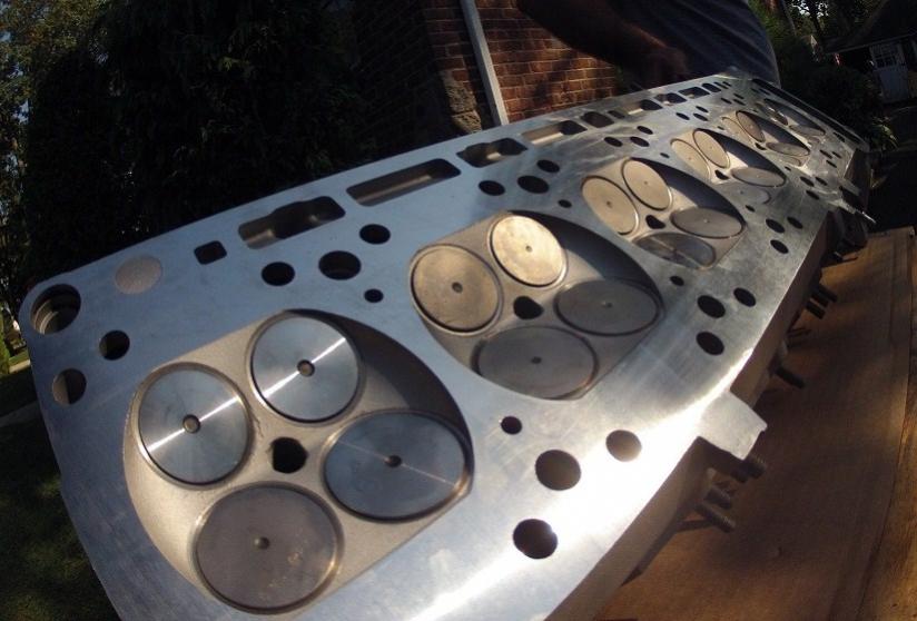

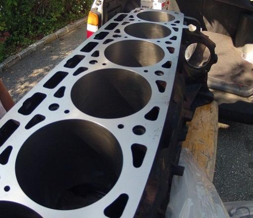

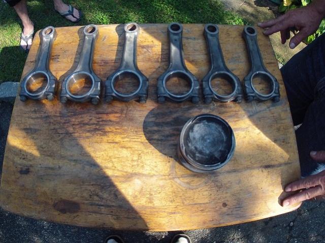

                            I finally picked up the S38 parts from the machine shop this Friday after what has felt like an eternity since I dropped it off. The block was hot tanked, over bored to 94.6mm, decked. Crank was polished, new valve guides, valves and seats reconditioned, decked. The rotating mass was balanced.
                            Old rods and piston.
                            So now that most of the peices are here ill be starting the assembly soon. Stay tuned.
