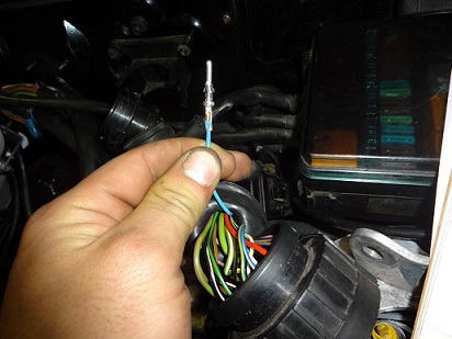

Unlike the M30B35 swap where I was simply able to use the M20B25 harness, this swap forced me to use the S38 harness and consequently repin the C101/X20 connector. It also didnt help the the harness was messed with so certain things had to be figured out that otherwise woulnt have been an issue. The diagram below is what I used to distinguish the pins on the e34 side of the connector. Note: C101 is the 20 Pin connector found on the e30 while the X20 is the 25 pin found on the e34/e36.
89' M20B25 C101- Alternator Charge - BU
- Oil Level - GN/YL, BU/BK
- Not Used
- Cool. Temp - BR/VI
- Oil Press - BR/GR, BK/BR
- O2 Heater - GN/WT, GN/YL -12V
- Ignition Coil - GN - 12V
- Fuel Rate(econo) - WT/BK,YL/WT
- Tach Signal - BK
- Oil Level - BU, VI/GN
- Inspection reset - WT/GN, WT/BU
- Check Engine - GY,BR/BK
- Fuel Relay - GN/VI,VI/RD 12V
- Speedo- BK/WT,BU/YL
- Unloader- BK/GN
- SRS/Not used
- ABS
- Starter - BK/YL 12V
- Not Used
- Not Used
Repinned the connector to give it a nice stock look. Just match the wires that have the same function. Its that easy once you know what wire is for what.
In order to repin you will need the following...
- 20 x 61131376191 (Only really need about 16, 20 allow for mistakes)
- 2 x 61131376193 (for larger gauge wire)
- 2 x 61131376195 (for larger gauge wire)
- 1 x 12521707283 (C101 Black Plastic Connector)

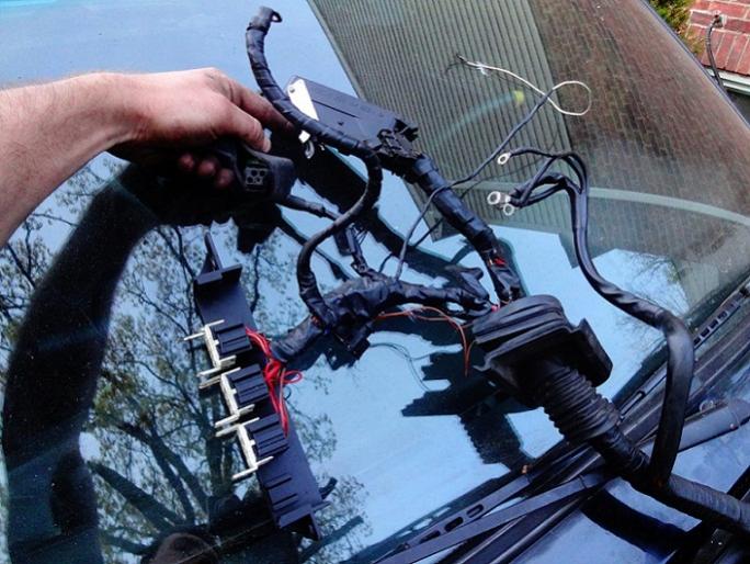

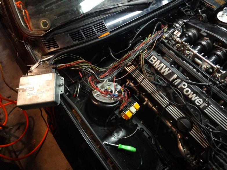

Sorting through the wiring. O2 heater, Main, and fuel pump relay shown. Altough we have most of the electical work figured out, we still cant get the fuel pump to run because the ECU is not grounding pin #3 thats connected to the fuel pump relay. Only when we ground it to the shock tower can we get the pump to turn on. I now know why they had the mysterious white wire coming out of the harness (ground wire).

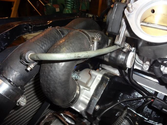

Thank you. The radiator is 22.5"x12.5"x3". These demesions fit well. You may be able to get away with making the one end 13.5". There was no way to fit the radiator and the hood lock so it was cut out and added to the scrap pile. I will have to run hood pins.
The heater core has already been removed from the car. I dont intend to ever make this car a daily again so the inconveiniece of no heat or defogging will not be an issue. I decided to plug both the holes, one in the back of the head and the other at the outlet of the water pump. Yes i will lose the ablity of the heater core to help with cooling the engine but that is not its main function anyway. My radiator and fan should have the ablity to remove enough heat from the system without relying on the heater core. Maybe it might be harder to bleed. Ive never tried to bleed a car without one.If you block off the driver side of the the system, how will you loop the back of the cylinder header outlet into the system? That aside, without the core in play you'd have a significantly less efficient system without the ability to use the heater core to release heat, you'd have no cabin heat or a way to instantly help bring down engine temp and it is also more difficult to know when your system is bled.

Plug for outlet of water pump. Similar one was used for the outlet in the back of the head.

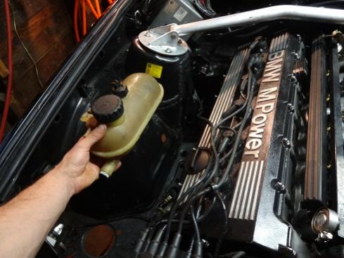

So I don't have to run lines across the engine, Im planning on using this eta exp. tank on the passenger side of the car.

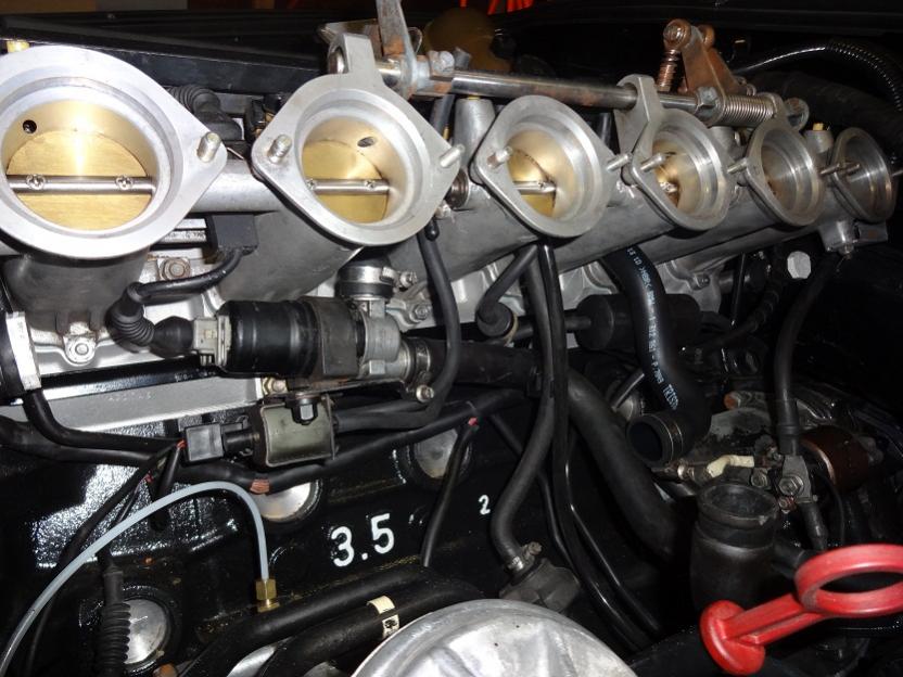

Under plenum mess. Using all new vacuum lines since the others were completely dry rotted.

2. ABS or cruise control, can't see the connector clearly enough
3. possibly oil temp signal to cluster or aux gauge
4. yes, ground if it is a single thick wire
6. plenum actuator
7. yes, ignition coil
8. possibly e-box fan, hard to see the connector
14. yes, o2
21. yes, charcoal
26. doesn't matter, you don't connect it to anything.

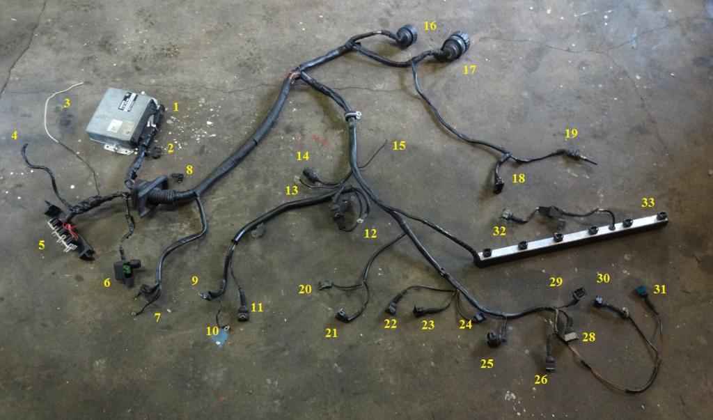

After loking at the harness it became aparent that this also had been molested in an attempt to get it to fit better or simplify it. I dont find it that good that I can feel crimp connectors below the electrical tape.
So now i'd like to know what every connector on this harness if for, whats not needed, what is not original, etc...
- DME Connector
- random white wire that we figured out grounded the fuel pump relay
- 2 fat red wires. power
- O2, Main, and fuel pump relays
- Plenum control computer
- 2 wires for ignition coil, 2 black wires are ground
- Alternator main power
- Alternator exciter
- Oil level Sensor
- Starter
- Starter
- O2 sensor
- Starter
- X20 25Pin connector
- Diagnostic Port
- Hot Wire MAF
- Air Temp
- Manifold Air Pump thing
- Charcoal canister purge valve
- Oil Press
- Oil Temp
- Manifold Air pump thing
- TPS
- Exhaust pump system
- No #27 because I can't count
- Tach pulse sensor
- CPS
- Coolant
- Coolant
- IVC
- Injectors
