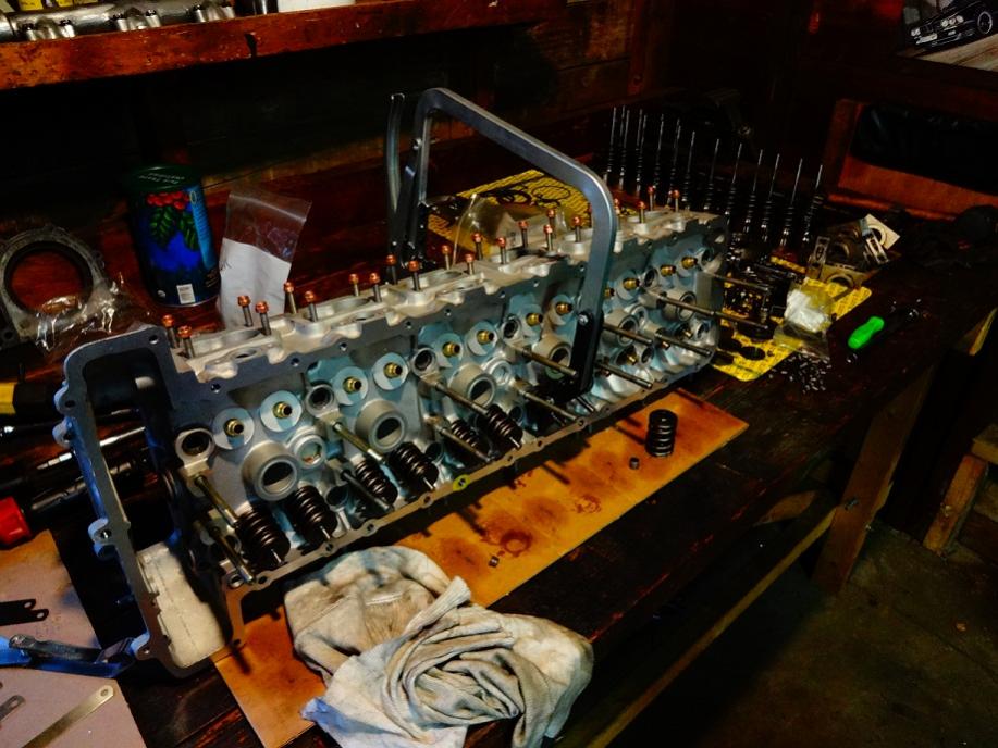

    It was now time to put the head together. Throwing the valves back in the head.
    Lower head back on the engine and torqued down
    There is no gasket between the lower and upper head. You need to lay a coat of gasket maker. Don't forget the 6 o-rings that seal the spark plug holes.
    Upper head put on. In goes the tappets.
    Cams laid and a test was done to see what shims I will need to have all the valves adjusted properly. When I received the head back from VAC I could either grind the valve tips to get the clearances between shim and cam within range or get new shims.
    After setting the timing several times on this engine I found it very difficult to try and get the chain on while both the cams and the crank were at exactly TDC. It was much easier to turn the crank a few degrees counterclockwise for a little slack putting the intake cam sprocket on. Once everything is attached turn the crank back to TDC where you should feel the chain tighten up again.
