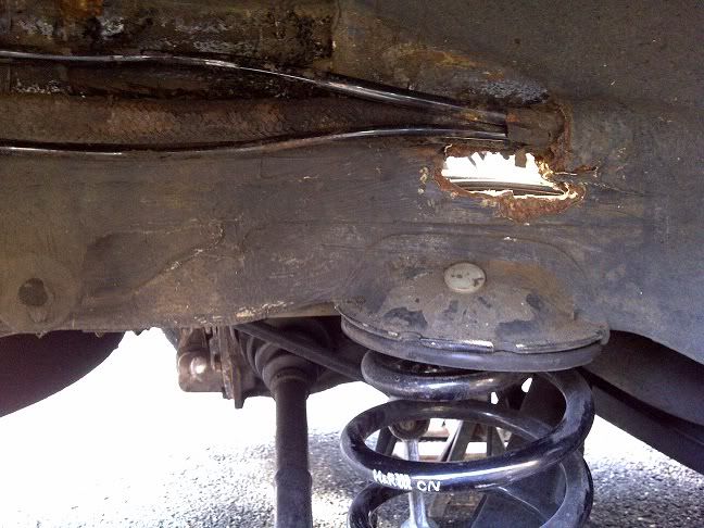

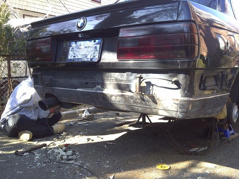

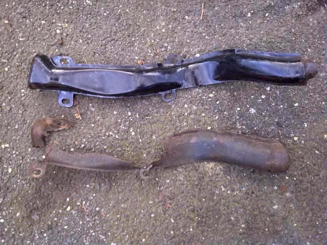

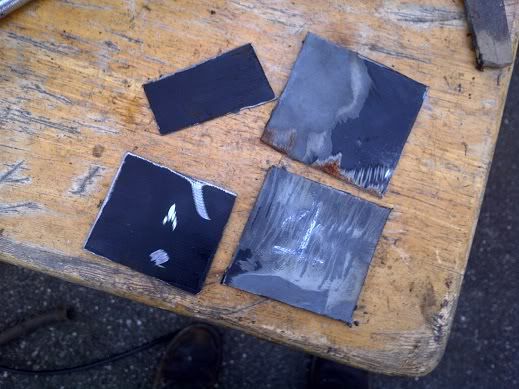

              Finally had a chance to get back and finish the rust repair in the trunk and the battery box.
              It took forever to finally get it down to bare metal but once it was I covered it in a layer of POR-15.

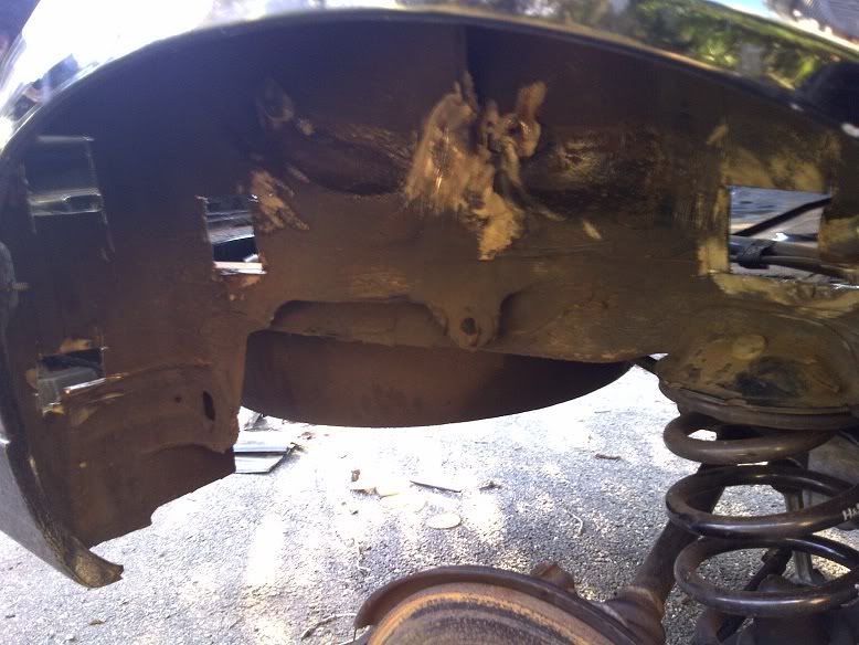

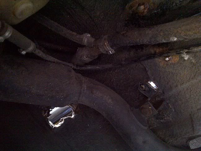

              The battery box was done but while doing that I noticed that there was more little rust spots in the rear passenger wheel wheel then I thought. I could not just leave it alone knowing that it would only get worse and water would keep filling up in my new battery box.
              The customary "look how rusted this part is" picture
              Had to remove the fuel tank fill pipe and all vents. Make sure you close off the hole to the tank when welding/grinding.
              Cut out all the rust. Even thought the initial rust holes were small the rust extended out and made the surrounding metal very thin.

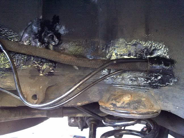

              Patches cut from the hood.
              Put a layer of POR-15 on the patches. Getting the vent lines back in was a bitch. I found it easier to put the big one in first then snake the small ones after.
              Now that all the rust was taken care of it was finally time to drive the car for the first time since the accident. Got the alignment and now were back in business.

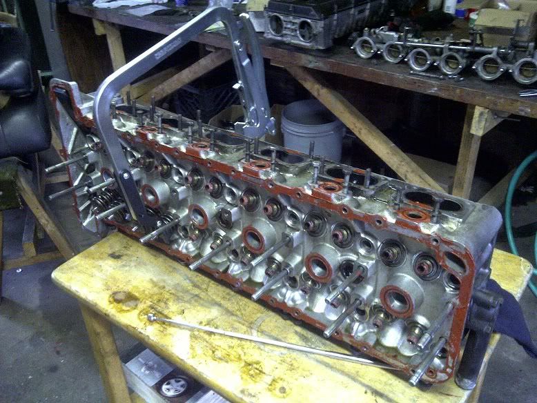

              Turned attention back to the head for a clean up of that. Removed the valves and valve seals.
              Hose puller worked great for getting the seals off.
              So thankful I didn't have any hairline cracks between the valve seats which is a common problem in high mileage S14/S38 heads.
              Relatively clean. Put away until its time for the machine shop where it will be inspected for cracks/warpage and get new valve guides.

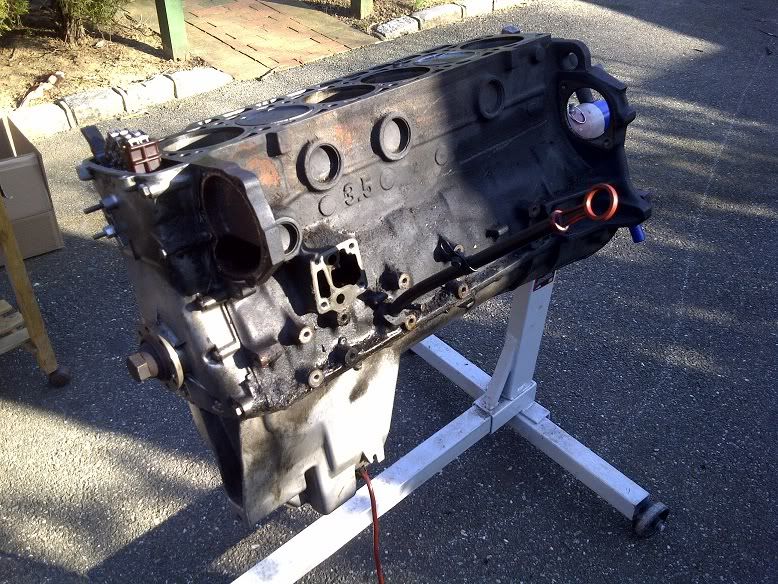

                          Worked on the bottom end today. Since the state of the bearings was still a mystery to me, I was eager to start pulling caps and pistons.

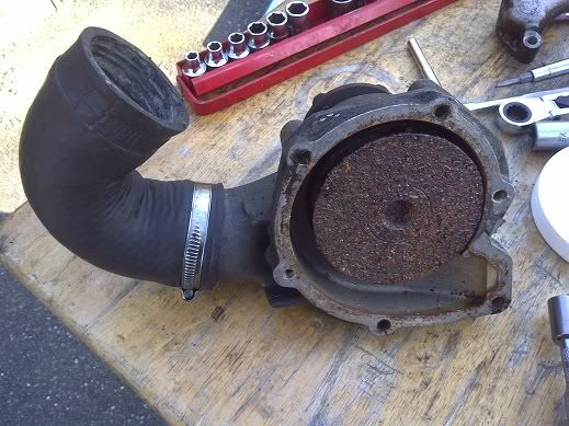

                          Water pump impeller showing some rust. The scrap pile keeps getting bigger.

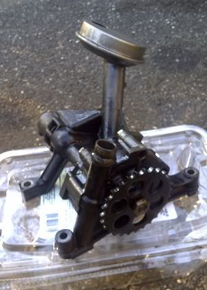

                          Oil pump off. No big plans for it. Ill give it a clean to get the sludge off, make sure the intake isn't obstructed, test the clearances of the gears, and lock the nut on the gear before putting it back on the block.

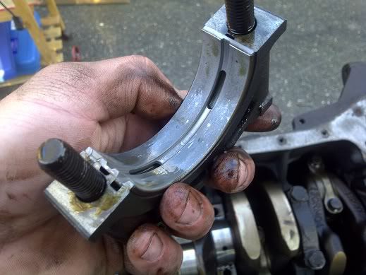

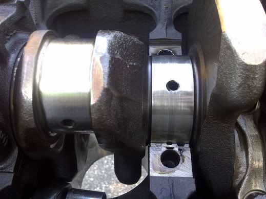

                          #4 cylinder journal. All the journals and bearings were in superb shape. No hangups when you ran your fingernail over them. I'm sure the measurements will show that they are well with in correct tolerances
                          One of the main bearings
                          Pistons pulled. All of them showed normal wear on the skirts. They will be able to be reused.
                          The cylinder walls looked good. No deep scratches. A simple hone should be enough.
                          Pistons out and labeled. Although they passed the visual inspection, measurements will tell what the 170k miles have done to the tolerances. Been putting some though to just buying aftermarket lightweight rods and pistons but the cost is hard to swallow especially if the tolerances of the stock ones are within spec. I honestly see this engine getting a turbo later on so that's also influencing me. Time will tell.
