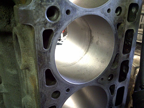

                    Thanks again for the kind words and sorry for the lack of updates. After the hone we discovered that there was minor rust pitting and some scoring so an overbore from the stock 93.4mm is necessary. As of now I'm going with a set of Ross pistons in one size overbore of 93.6mm. The CR will stay at 10:1.

                    Originally posted by The Dark Side of Will
                    Also IIRC, the stock B35 compression ratio is 10:1. That's not great for either all motor or boosted performance. Decide now if you're going to boost. If so, drop the CR to 9:1. If not, bump it up to 11:1, possibly 11.5, although you do have to take some care since you only have access to Kalifornia cat pee 91.
                    Either way, you should have the block surfaced for an MLS head gasket and measure the exact block deck height. Use that dimension to calculate what your piston compression height should be and order your custom slugs to that dimension. When you install them, *MEASURE* the piston deck height and order an MLS gasket with the appropriate thickness to give you .035-.040 piston-to-head clearance.
                    I would have liked to bump up the CR but for some reason Ross doesn't let you change it. The spec for the head is 96.07mm-95.93mm range. Anything less then that and a thicker gasket is needed. I have to measure the height of the head now and what we end up cutting off the block and what thickness of gasket to figure out the depth of cut on the head to make still. VAC sells them from the stock thickness of .07" to .14".
